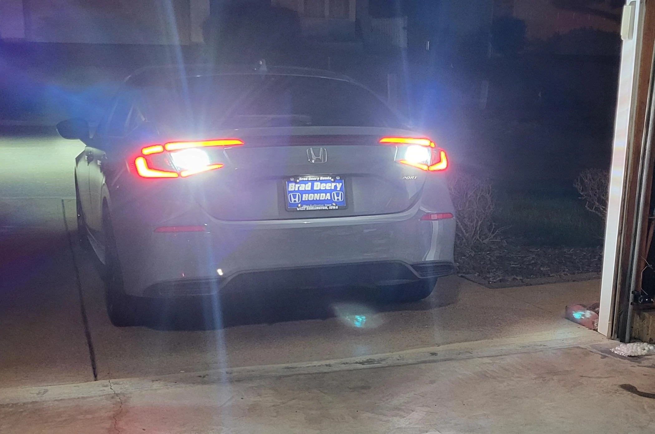

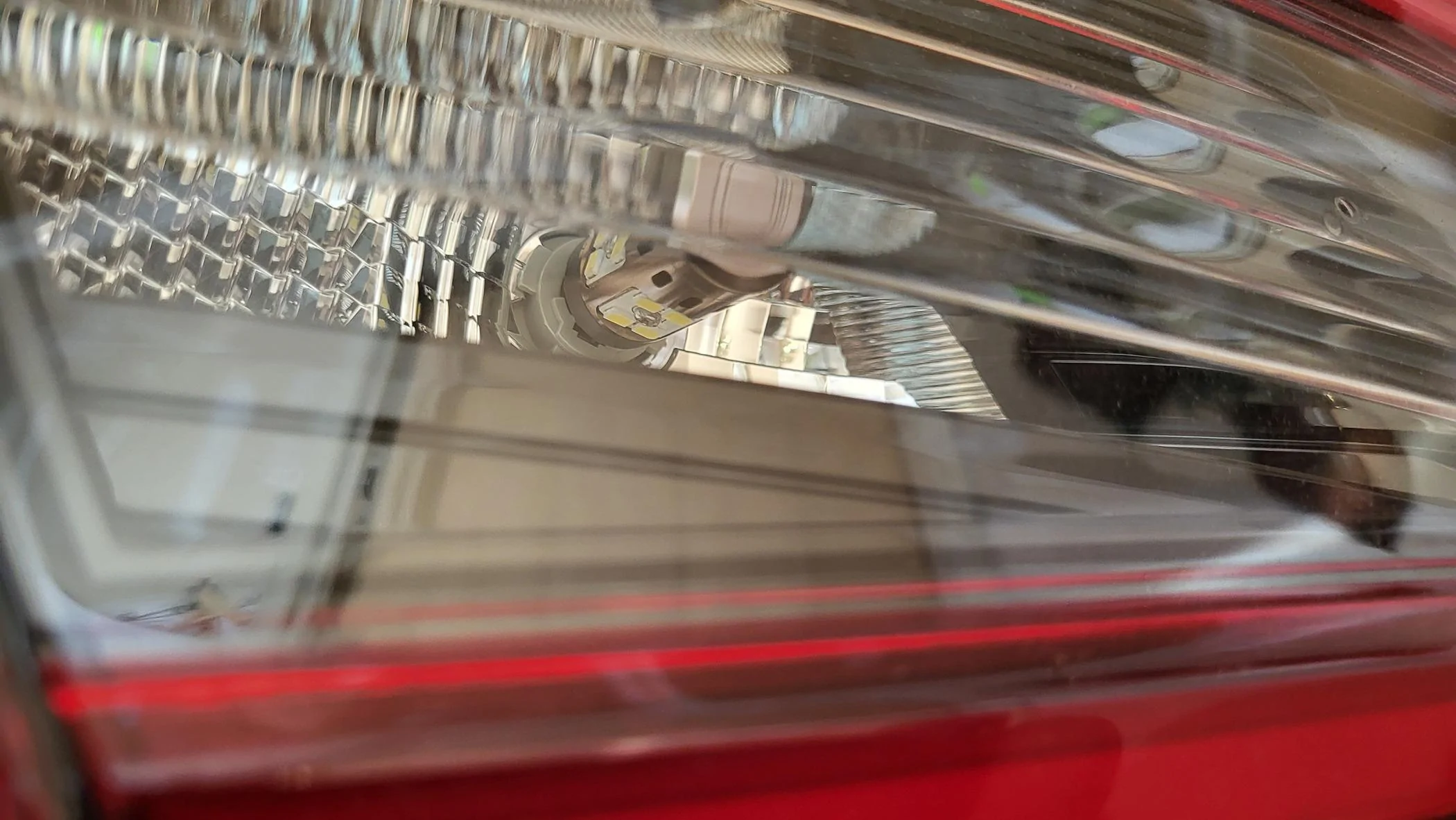

Lastly, I replaced the stock reverse lights with the VLEDS V6 Extrme 921 bulbs I had on my 10th gen. I tried the install when the car first arrived. However, when following the instructions, the bulb was too small to take place of the socket. When using the included spacer collar, it was too big!
After talking to customer support, with one of the employees actually having a Civic hatch to test, they said to twist the screws out two rotations. That worked, but scraped a bit of the chrome in the assembly.

Please excuse the crap photos. Now all my exterior lights are LEDs.

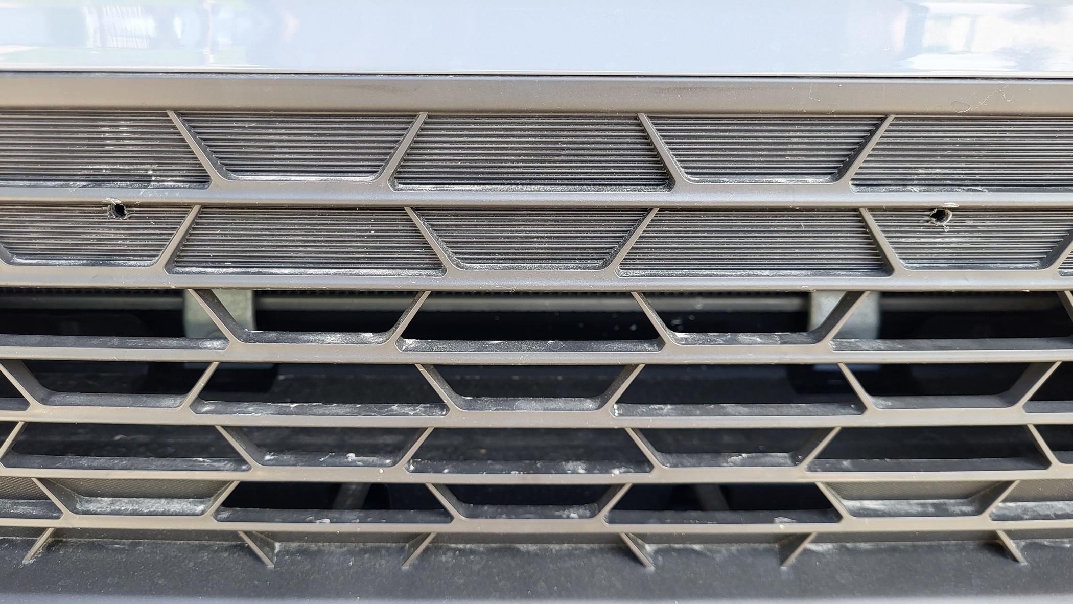

This is what happens when I look at the internet. Thanks to the FL5 section of this forum, I opted to remove my front plate mount. And I was only looking for the size of the rear plate screws!
11th Gen Honda Civic What did you do to your CivicXI today?? 20240420_134925
You can just see the holes in the front grill.

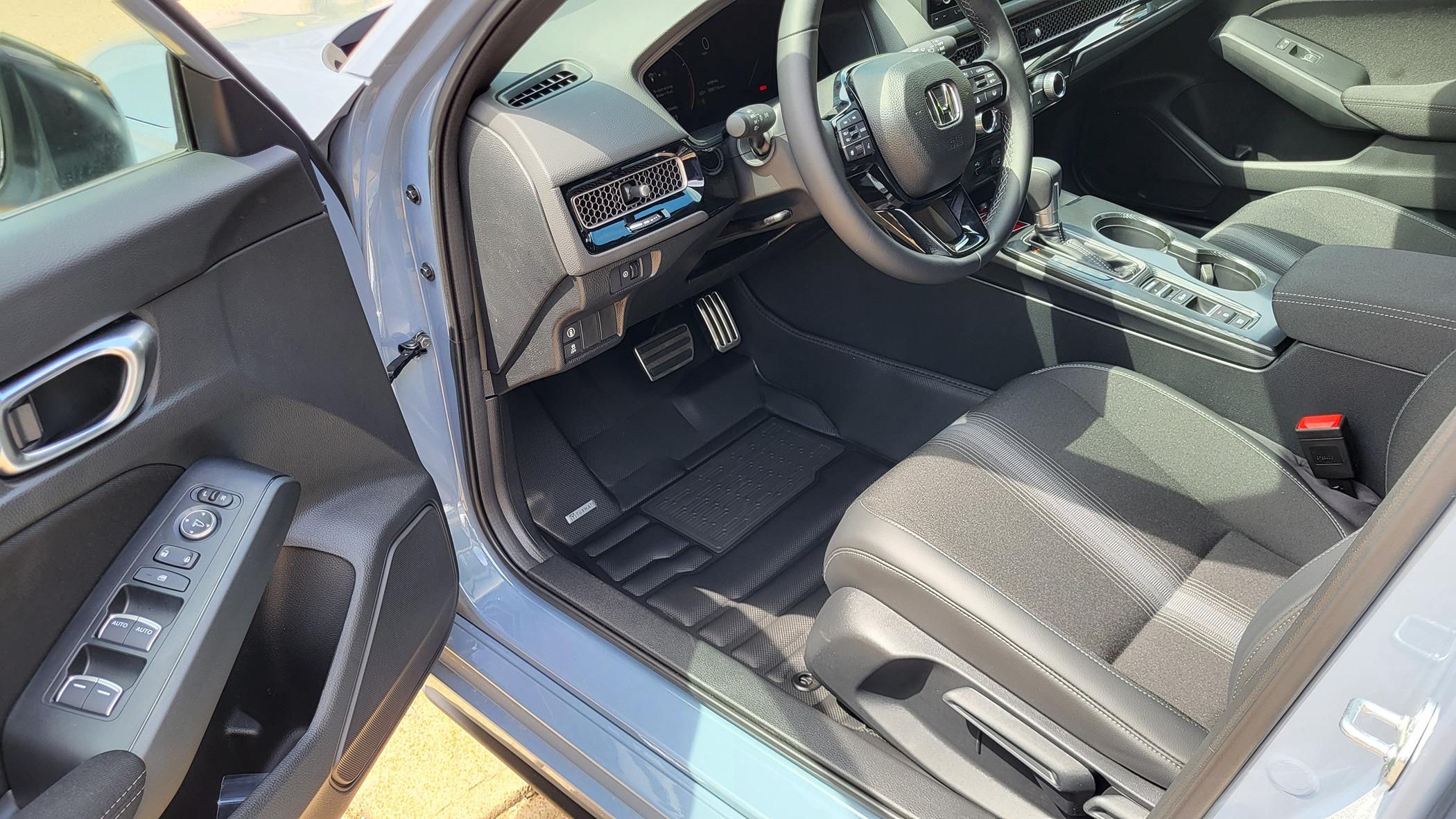

And my order of Tuxmats from @Unity Performance came earlier than expected! Coverage is great and I didn't even need to use the clips.

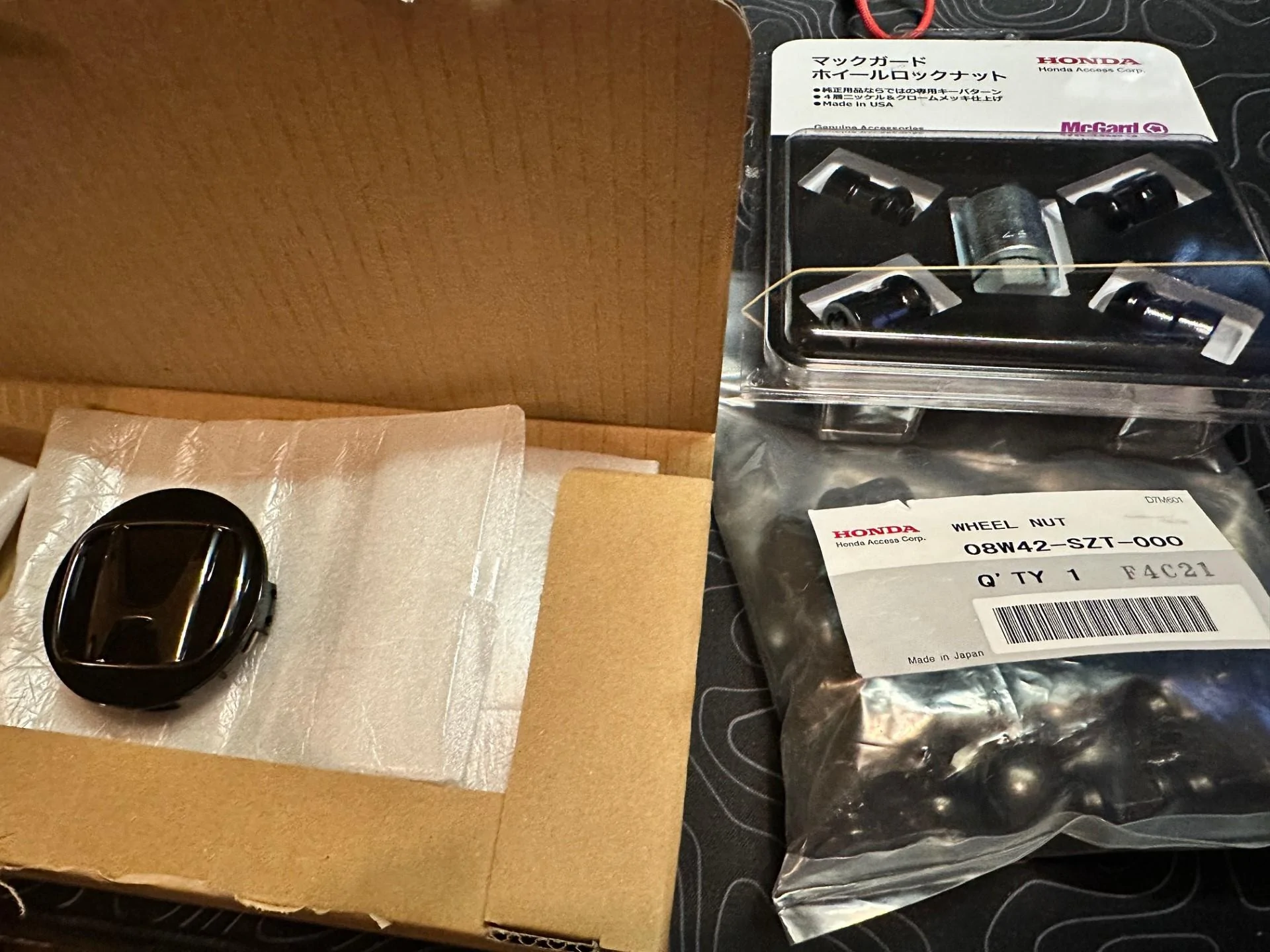

Just got a delivery from Black Hawk Japan.
So much cheaper than buying from Honda State side. Going to be going back to the stock wheels for the time being, but got the black wheel locks, black lugs, and black Honda center caps.
Just waiting on my 20mm spacers from Mishimoto.

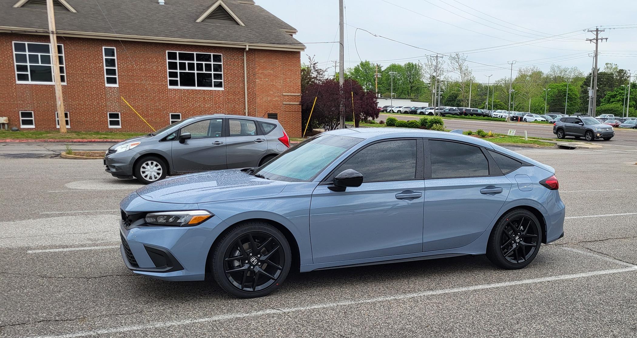

Finally had my windows tinted. No more fish bowl!
I had 20 percent around, clear tint on the windshield, and five percent window strip done. However, since I bought this car out of state, and that state puts their temporary tags on the rear window, coupled with the lack of a front plate, I may be a temporary cop magnet until the tint cures for me to put back the temp tags.

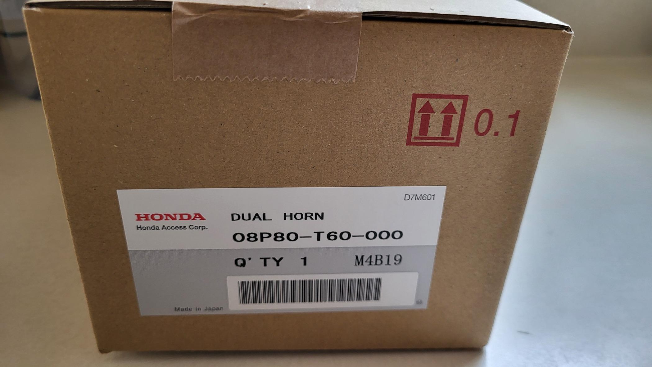

On the bright side, my Euro horns have arrived. Hopefully the weather cooperates!

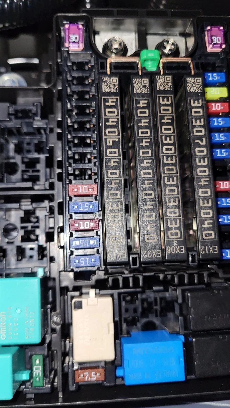

Well, I tried to swap my horns, only for them not to work. Now I have an Idle stop issue on the guage cluster. Would disconnecting the battery help?
Edit: New horn fuse fixed the issue! Looks like someone else will do this install. Though I will definitely disconnect the battery for the Homelink install.

You keep having issues with fuses blowing. I feel like there might be a loose ground or something causing stuff to short.

I feel like the dealer would have chased that the first time it happened. Though they did cost me money in the end. In this case, the fuse popped when I went to test the lower horn. The only thing that happend was the stock horn momentarily beeped until the fused popped.
Though the Littlefuse LP mini is a darker shade than the one from factory. If I remember, I can always buy one from the dealer parts department.

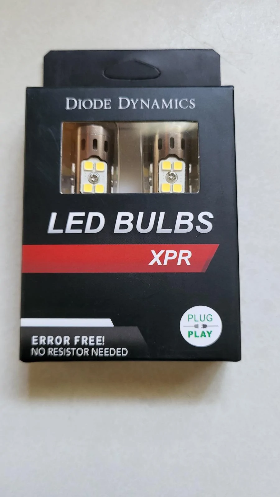

I may be rambling, but intrusive thoughts lead me to look at the battery. And I discovered that the positive terminal was loose. As in, the nut was at the end of the bolt. That may have contributed to some parasitic effect. Now, whether or not that contributed to my replacement LEDs to pop fuses, I can only guess.
But I'm not taking any chances. To keep on topic, I installed the Diode Dynamics XPR bulbs. Unlike the VLEDS, they're direct replacement. While not as bright, they're bright enough.
