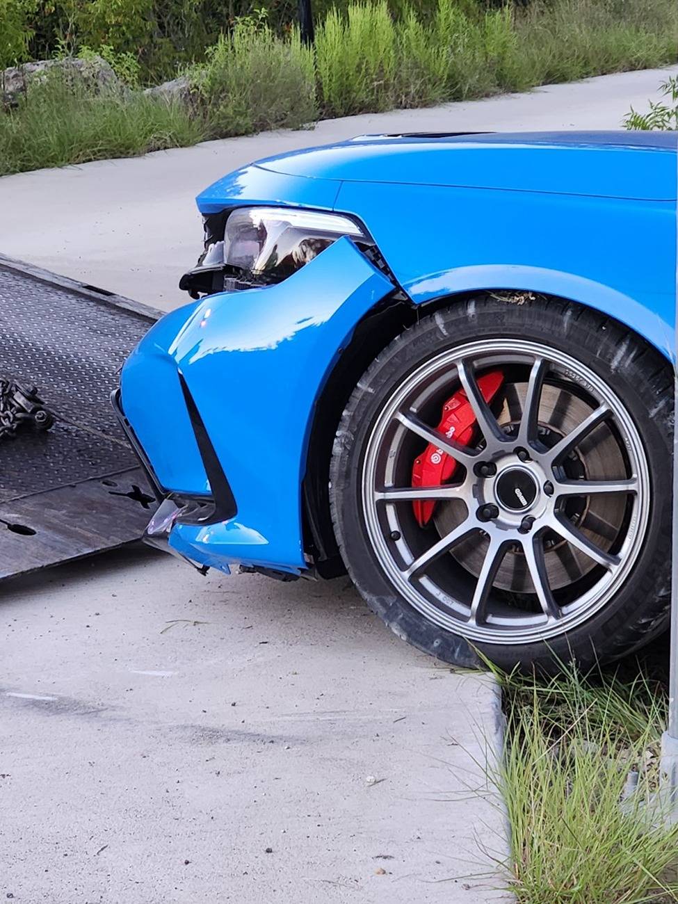

Really sorry to read and see this. Glad no one was injured. The car looks busted up pretty good. It's likely this one is a goner, unfortunately. :(

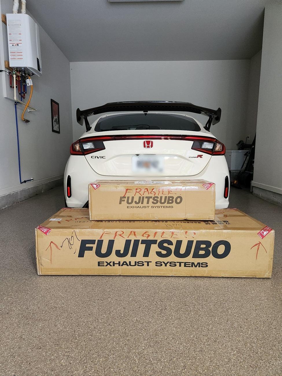

...overnight parts from Japan.
I wanted to partially close the loop on this. I was able to get this installed a couple weeks back. The system consists of the front pipe (purchased seperately) + mid-section + muffler. Here are the photos:
Before

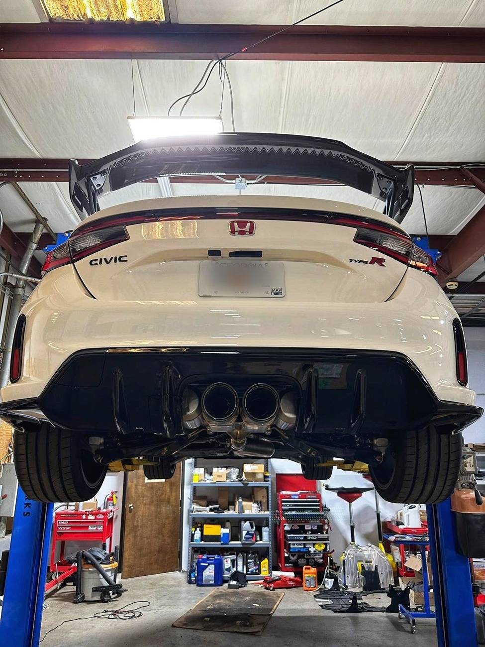

After

A few notes:
  • Fitment - 10/10. Every portion of the system from the hangers to tip alignment to clearances are spot on.
  • Packaging - Very good as is the quality of the included hardware. It's clear great care was taken to ensure the parts aren't damaged during shipping. Everything you need to install the exhaust is included in the box including some metallic decals if that's your thing.
  • Weight - The savings over stock is 14.52 lbs, or 30%. The breakdown is as follows:
Stock Exhaust - 40.26 lbs (18.3 kg)​
Stock Front pipe - 9.9 lbs (4.5 kg)​
Total - 50.16 lbs (22.8 kg)
Fujitsubo Exhaust - 28.38 lbs (12.9 kg)​
Fujitsubo Front pipe - 7.26 lbs. (3.3 kg)​
Total - 35.64 lbs. (16.2 kg)
It always amazes me how lightweight titanium is relative to stainless steel when in your hands. The pieces are just that light.​
  • Sound - The sound is what most are probably here for. So, how does it sound? Phenomenal! It's not a loud system and I would characterize it as a mild to moderate tone and volume increase over the OEM system, which is exactly what I was after. Since the exhaust is constructed of titanium with two resonators, the acoustic profile is different than a stainless variant. It's not raspy, boomy, or deep. The sound is "cleaner" and has more of a "tinny" or metallic sound when you get into it. Vibrations (sound) on titanium ring off differently so that tracks. Drone is very limited to non-existant. I can't say the system doesn't drone; however, you'd have to try incredibly hard to find it. A few folks I've spoken to who have this exhaust on the FL5 claim there is no drone. I wouldn't take umbrage with that assessment. In the opening, I mentioned the loop on my initial post is only partially closed because: no videos. It's hard to truly capture sound via video, but I'll get some stock vs. FGK videos up in the coming weeks. Standby.
