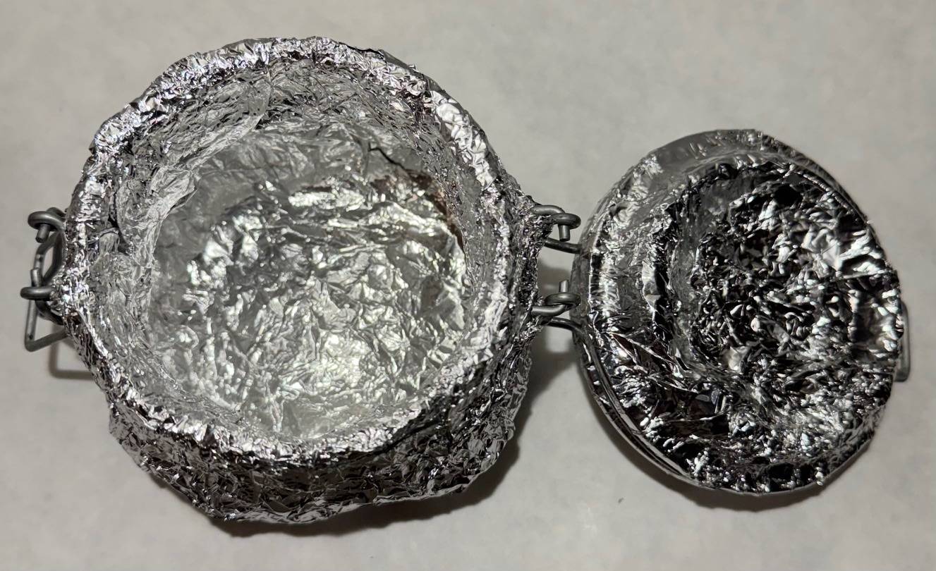

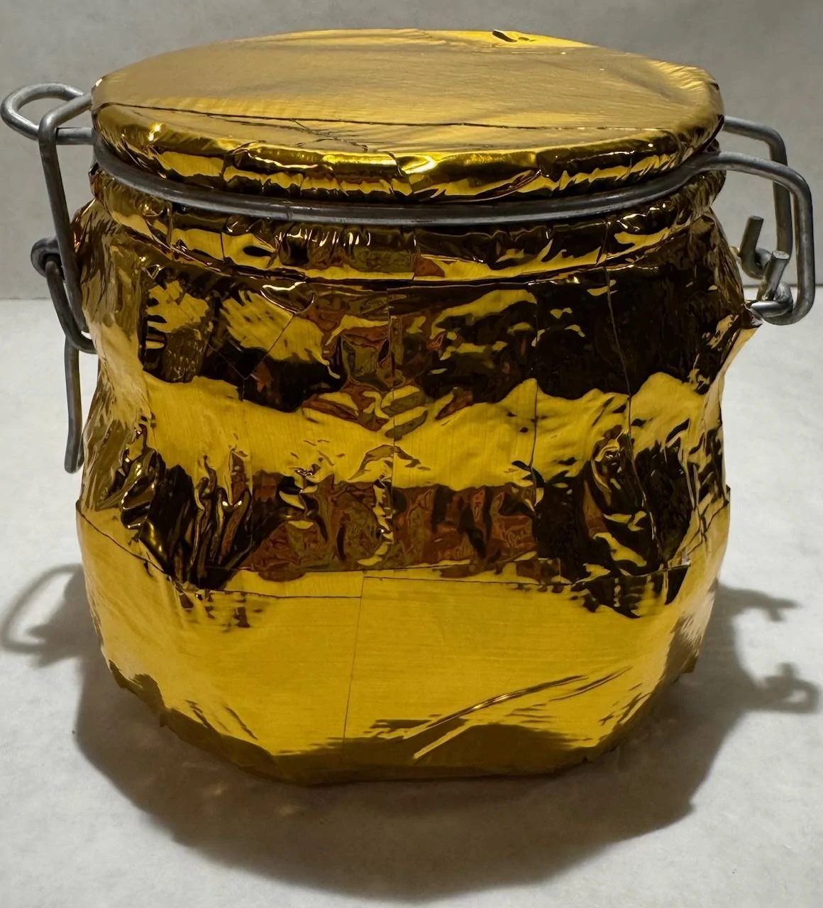

Made a faraday cage to store all of our vehicle key fobs. Simple yet very effective:
  1. Fido glass 0.5L hermetic jar (gasket removed);
  2. Two layers of heavy duty aluminum foil applied to the inside and outside; and
  3. Reflect-A Gold tape applied to the inside and outside to keep the aluminum foil layers in place and more obviously to keep temps in check.
Simple idea that seemed effective at first however, the gold foil tape being added started to reflect the RF signal from the key fobs even after adding a rubber insulating barrier on the inside. Layers of just heavy-duty aluminum foil seem to do the best job so far for blocking the RF frequency range used by the fobs.

Interesting. I guess that’s a testament to the reflective qualities of gold!

Seems to be more along the lines of RF bleeding out from the hinged enclosure having been opened and closed several times compressing the layers and then forming a gap.

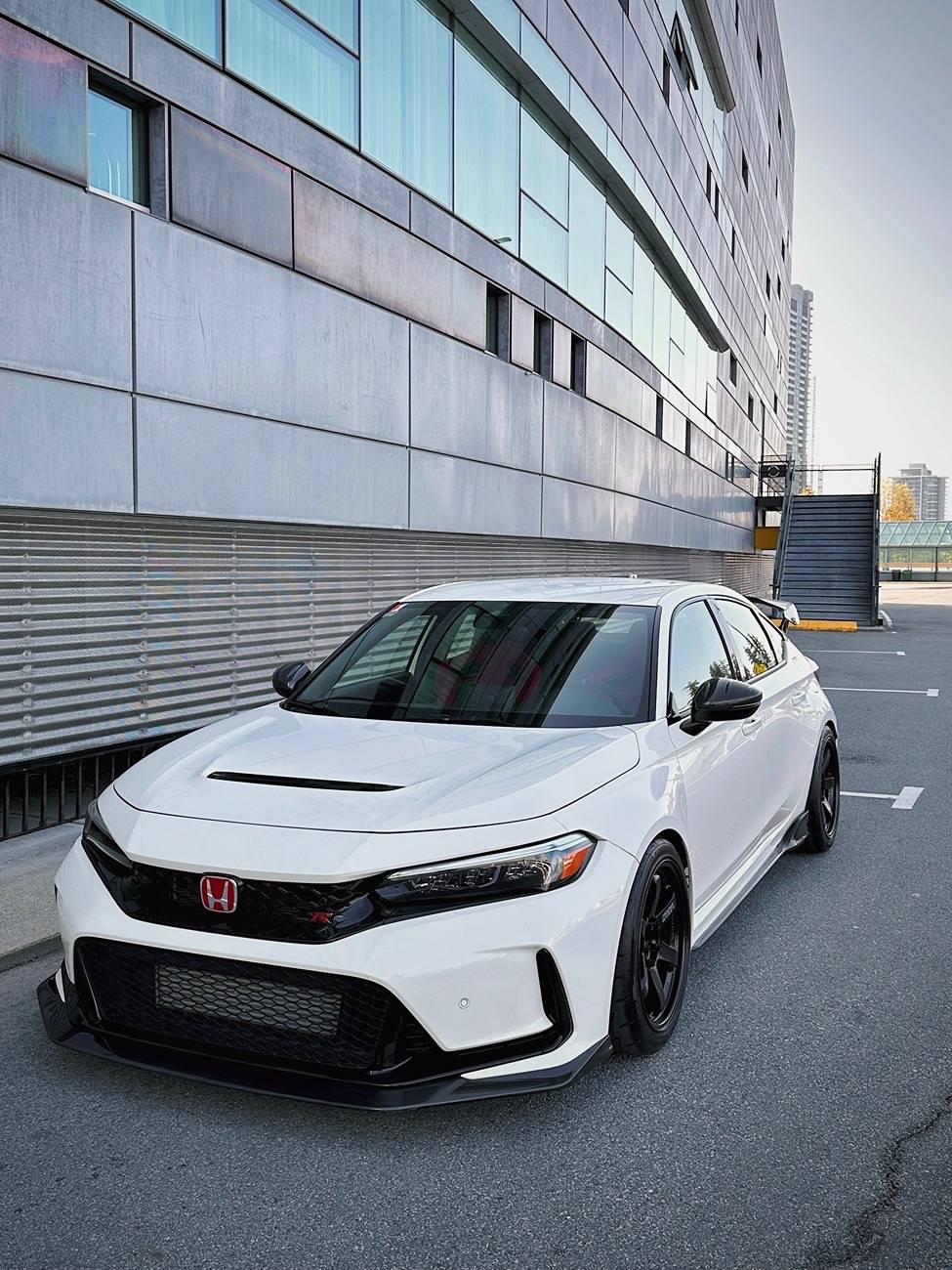

Did I make the right decision?
I was really dead set on getting the Apexi Exhaust, but after thinking about having a newborn + a toddler and how cabin noise would affect them, I decided to go with the Spoon N1X Exhaust.

@惹Raizzelle It's been a while, I hope you're well. I hear the Spoon exhaust drones badly. Is that not your experience? Car looks good btw!

Heyyy @Clark_Kent , I've been busy with school and life, but everything's good, haha. Thanks for checking in! Hope you and your family are doing great too. ??
Honestly, I don't really notice much of a drone with this exhaust. I'm really pleased with it overall, just curious if anyone could share their experiences with both tho. Haha thank you!

Absolutely and love it ! What springs are you running looks perfect to ????

Was just about to comment the same thing. May remove my H&R and go back to my original plan to go with Pro Kits.
Any other side shots @Raizzelle ?

Thanks for the kind words! It’s Eibach PROKIT. ?
Looks wicked ! ???? Also just to note although I don’t own a Apexi I know someone that does and he did mention the valve did make noise/rattle periodically but other then that he liked it. Could be an install issue as far as what position you have the valve at when installed. I’m sure other Apexi owners will chime in :)

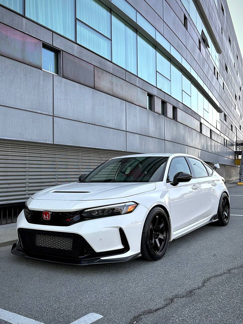

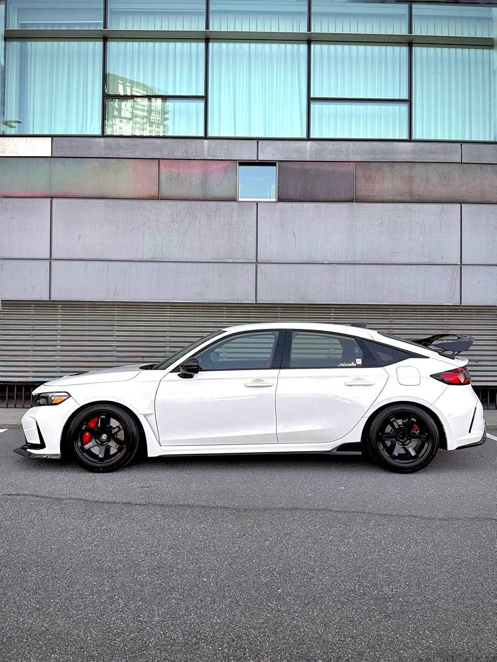

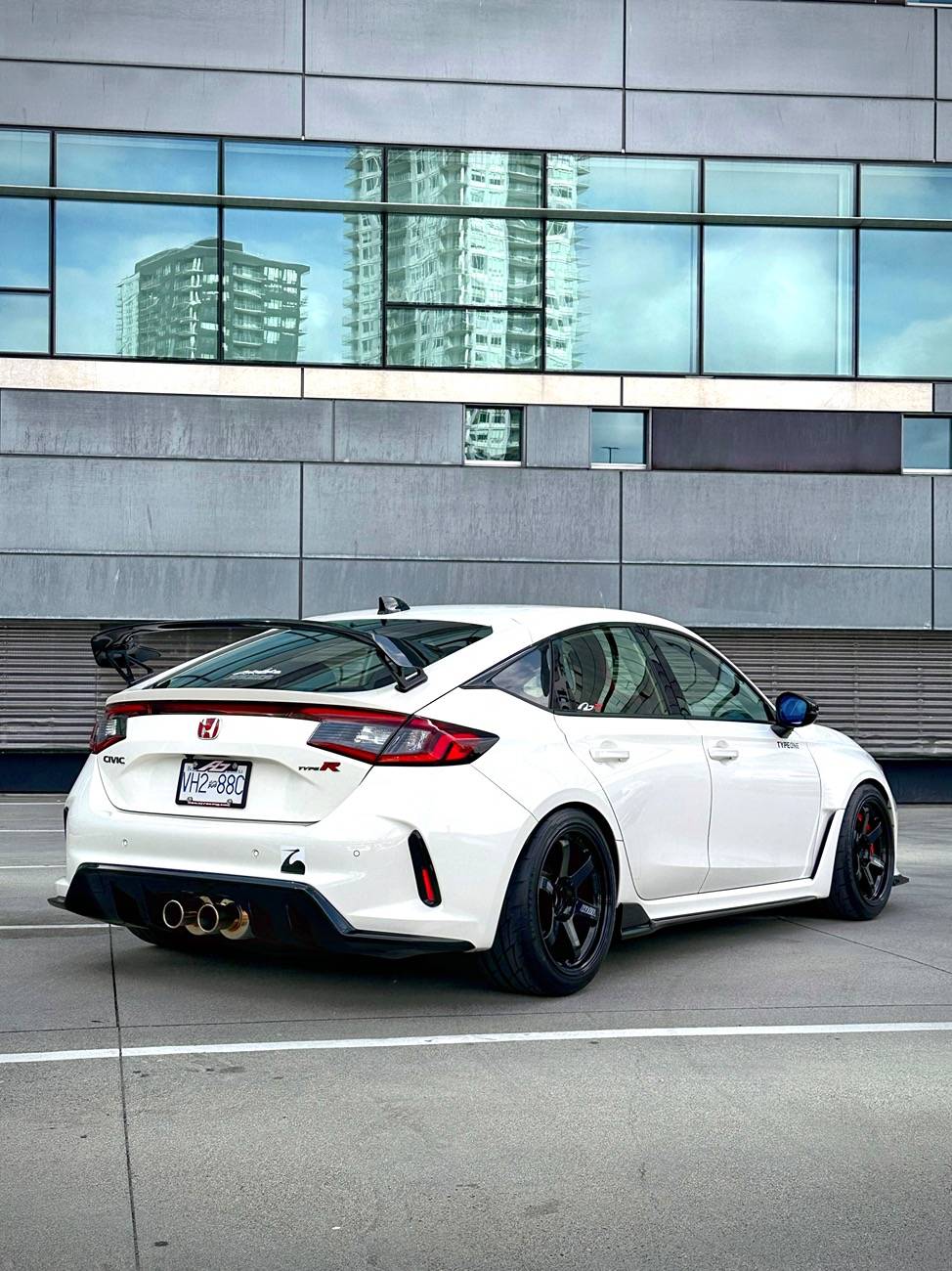

Here you go, hope this helps!
