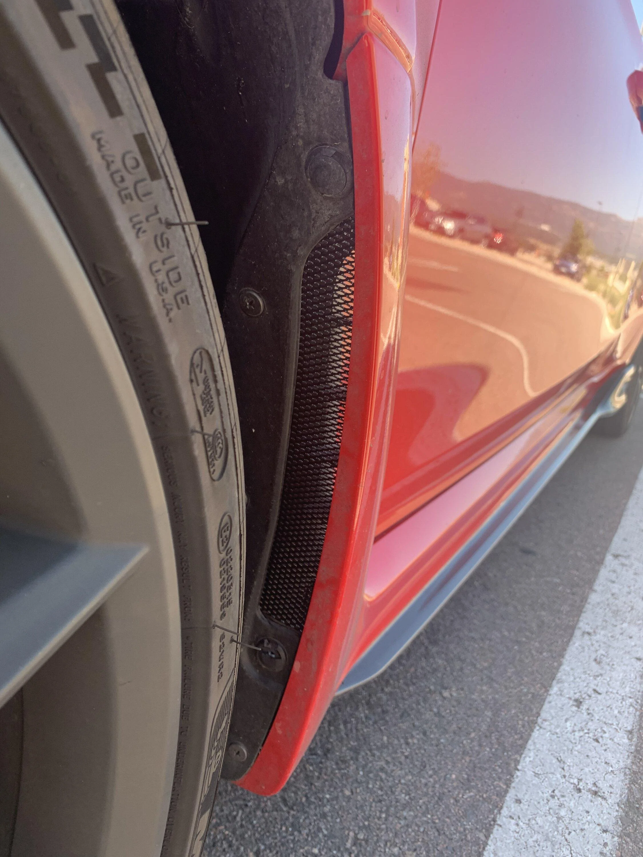

Nothing flashy, but I just finished installing the Flapfab Stone Guards from @Two Step Performance --it took about 30 minutes, and would've been a heck of a lot easier had Honda used 4 Phillps head screws on each side rather than 2 screws and two locking pins.
If you want to install these, you'll save a bit of time pulling the pins with one of these tools: https://www.amazon.com/Fastener-Rem...94017201&sprefix=panel+puller,aps,133&sr=8-10
If you try to pry them out with pliers and a flat head screwdriver, your odds of salvaging the pins are slim. I got 2/4 out in perfect condition (using the fastener remover), busted the crap out of the other 2 (with a screwdriver and pliers). I replaced all 4 with newer and slightly larger/longer pins from a cheap-o set of pins I had on hand. I'm pretty confident these aren't going anywhere, but we'll see.

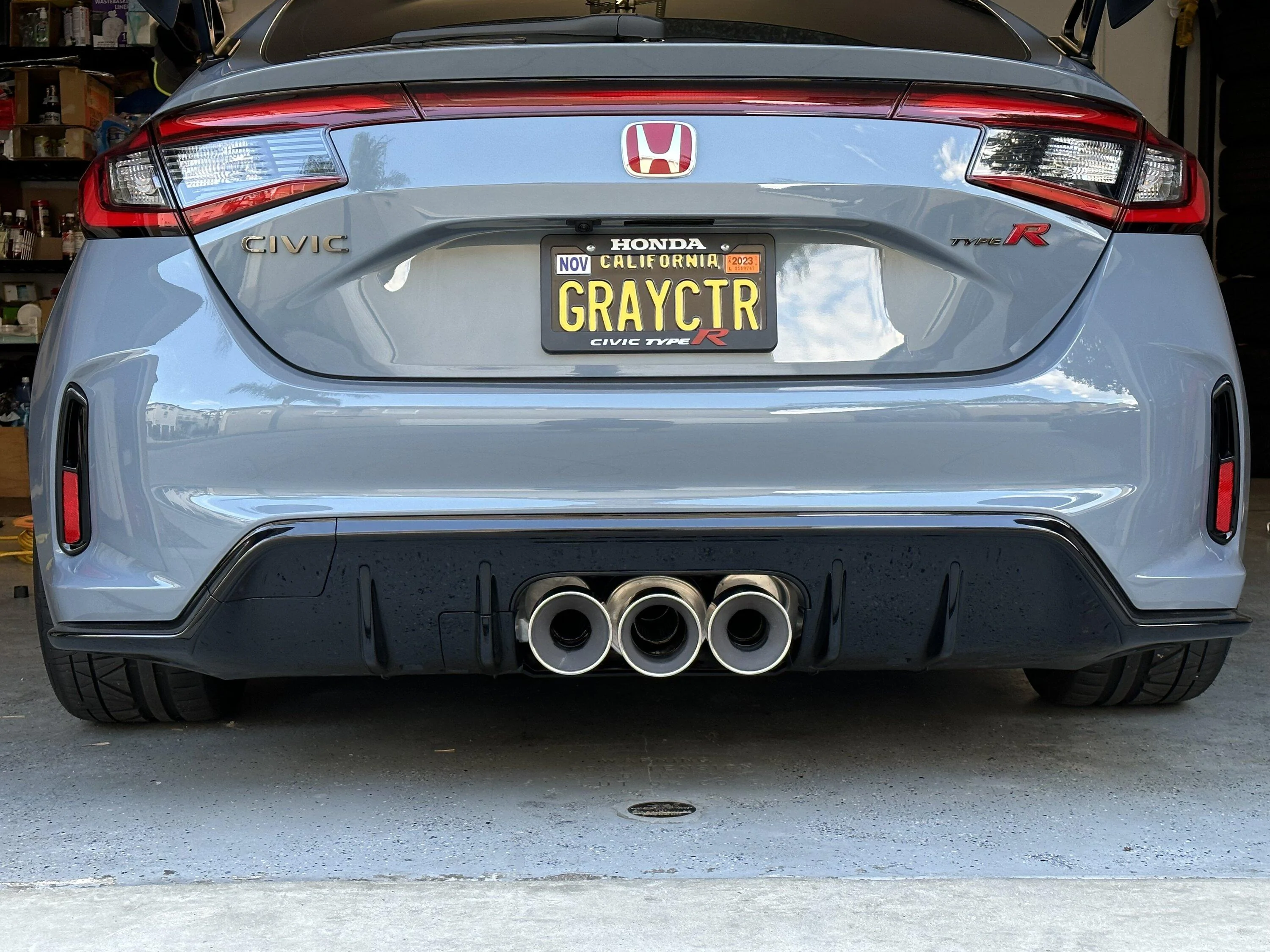

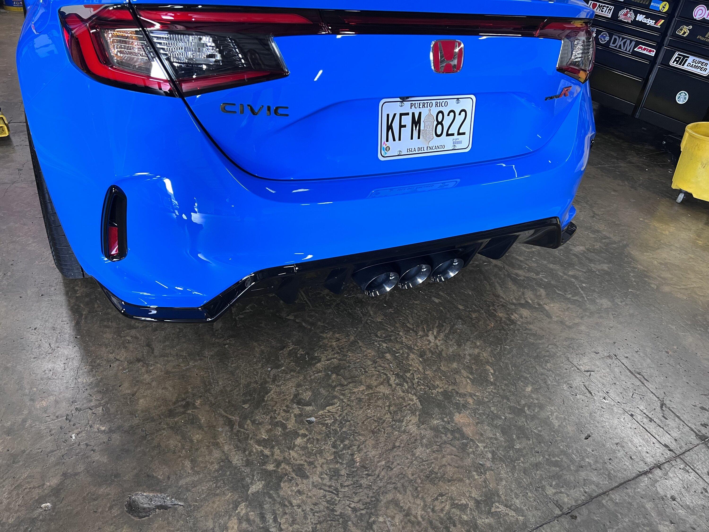

Got around to installing the modified Integra Type S exhaust on the CTR today.. sounds fantastic!!
One thing that I noticed is that the internal pipe DIA inside the muffler can were I could measure was 5mm larger than the CTR…
Also the rear muffler section has a different sub part number vice the CTR.. the CTR is a T20 the ITS is a T21 :hmm:
OEM CTR exhaust weights 54lbs the ITS exhaust weights 47lbs.
Can we hear it tho

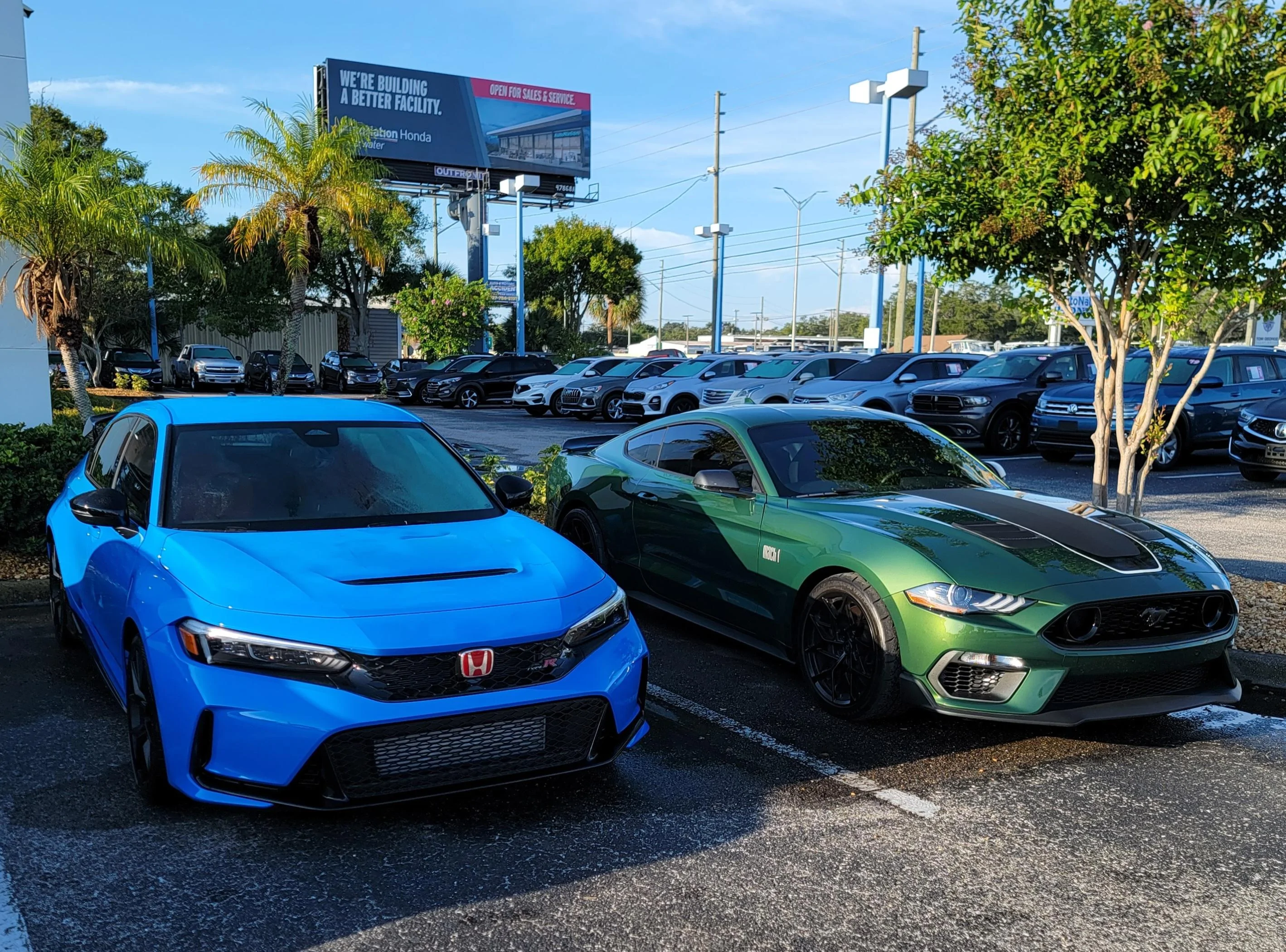

Bought one!
Traded in my 2022 Mach 1. Turns out having multiple kids, a car with a real back seat is a must. Ill do a thorough write up about how the CTR compares to a track edition mustang and also an Elantra N.
But for now, hello to all. I'm in the Tampa area and couldn't be happier with the car so far.
