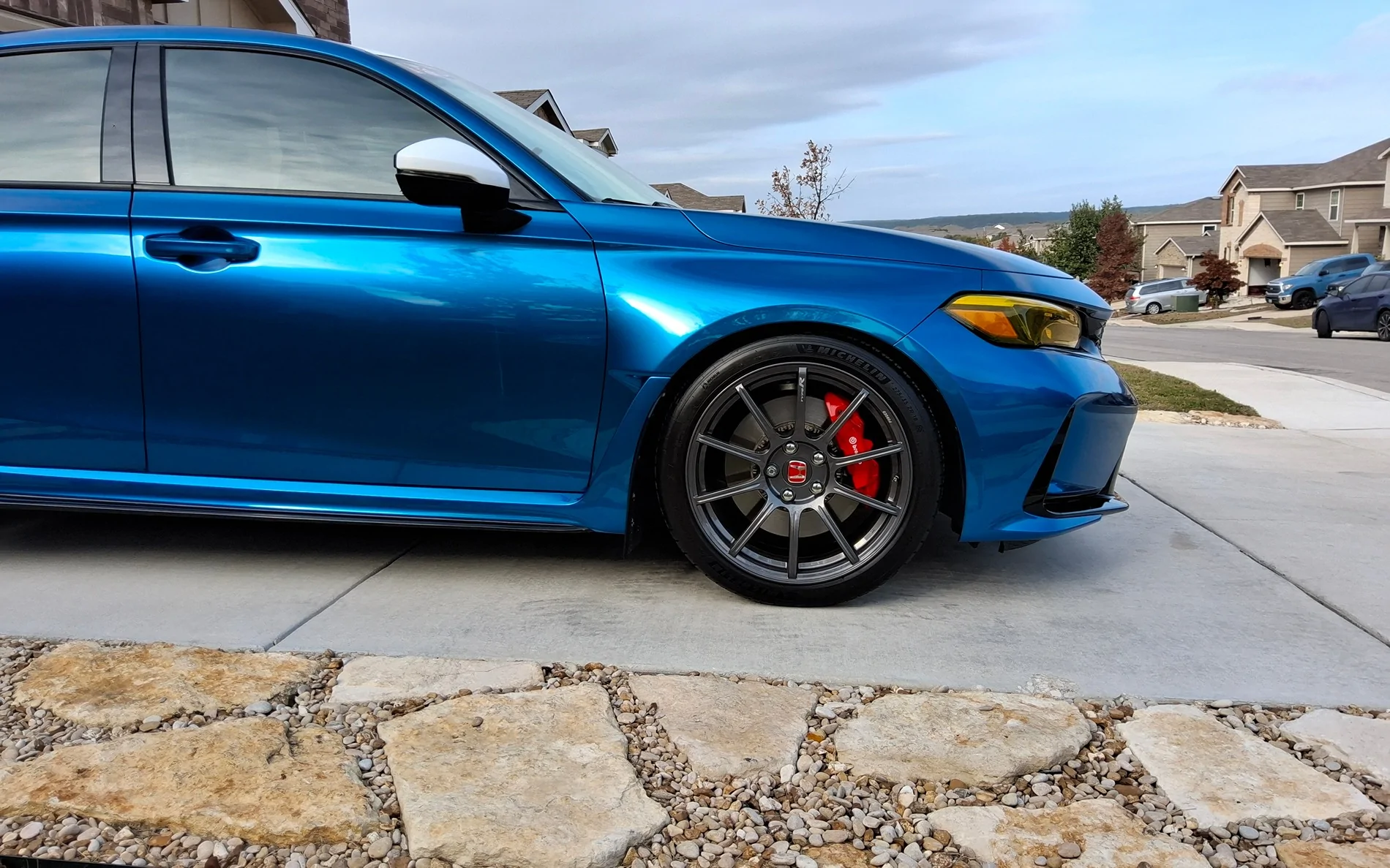

clip1: Road uppercut caused a radar detector wire to pop out from the head liner (can be seen right of rear view camera) Shifted the whole rear view mirror and my arm rest popped up. At the time of driving and reviewing this footage it did not appear anything was on the ground. S2000 in front said they also felt some bad compression and bent their front fender a smidgen but didn't have a smack like mine.
clip 2/3: Seemingly small bumps/ridges scattered across the ground at moment of impact. Did not expect them to hit that hard.
The smacks are LOUD in the car
Is it the factory rubber band tires? I'll need to take off both front wheels Monday and inspect. Wonder if a bent arm or something else is possible.
Suspension in comfort
Only eibach sportline springs
Stock wheels/tires 265/30/19

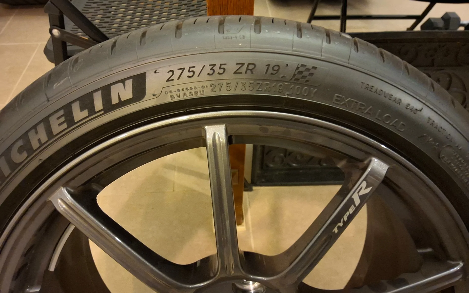

Matter fact, I already (almost) regret putting 275/35 ZR19 tires on my Honda Modulo Forged 19X9.5 wheels, because 275 is too skinny.
Next change of tire, those wheels will be getting 285/35 ZR19 tires.

Go with at least 275/35 ZR19 on stock size 19X9.5 wheels.

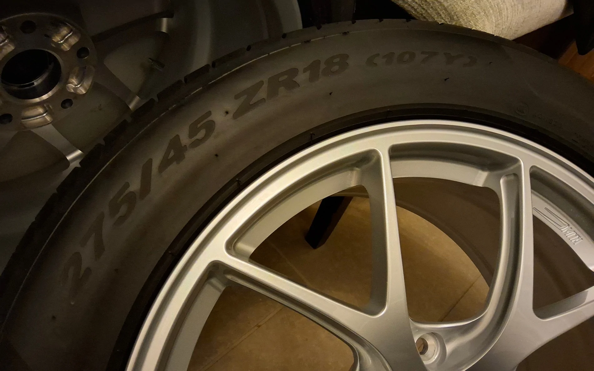

With my 275/45 ZR18 tires, at FL5 indicated 60 MPH, I am actually going about 65 MPH.
I have to be REALLY careful going through those 20 MPH School Zones, and usually drive at about 17 MPH indicated, just to be safe.
With the 275/35 ZR19 tires it is not as extreme, because this diameter is lower than the 18 inch tire, which is, even for me, a little too big.

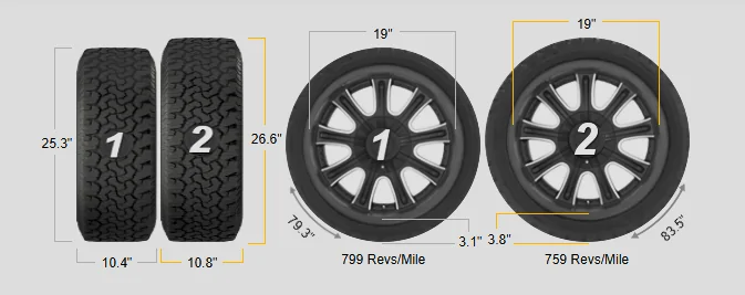

Tiresize.com is a good resource to get decent estimates on what different tire widths and diameters will do vs. your original tire size.
Here, I compare a generic 265/30 R19 tire to a 275/35 R19 tire.
Of course, different brand and model tires will be slightly different sizes.
You can also play around in the website to see how different offsets may look.
