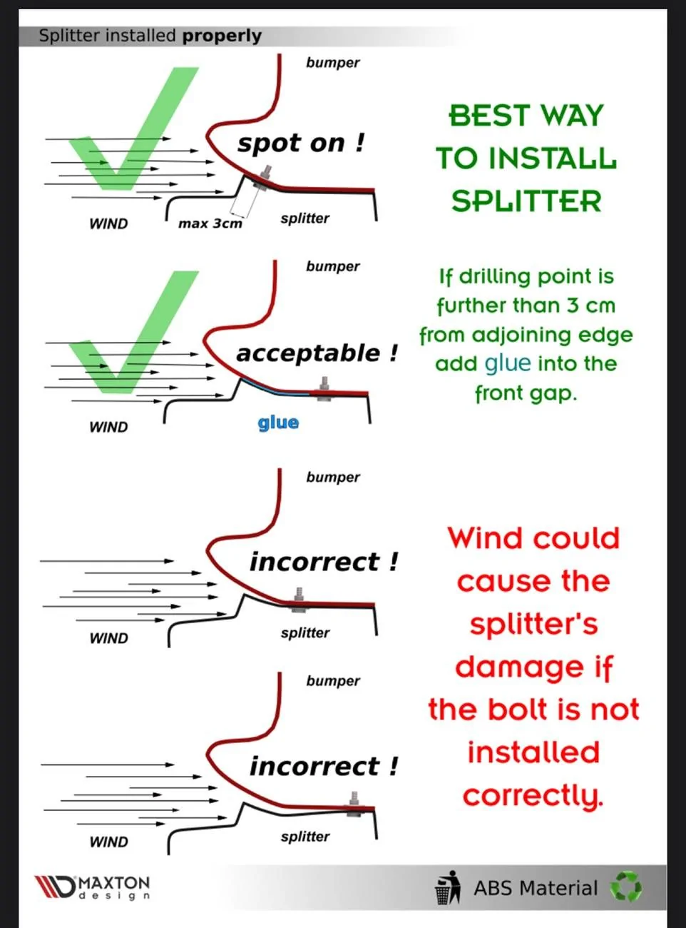

@dragonate can you test this? How much flex does it have? I am a little nervous that the lip will flex or move around without any other reinforcement from screws or adhesive as the fasteners all look to be at the rear of the lip.
I could be wrong though so don't want to discount what project aero guy told me. If someone has it installed, put some force in front of the lip and see what it does, how far does it flex down?
The Maxton Design lip that is similar comes with this guide which states not to attach from the rear of the lip without reinforcement.

It feels pretty solid to me and doesnt flex much if at all. Ive had it on for about 3 weeks now commuting 60 miles a day mostly highway and havent felt that it was going to come off at any point but ill report back if that changes.

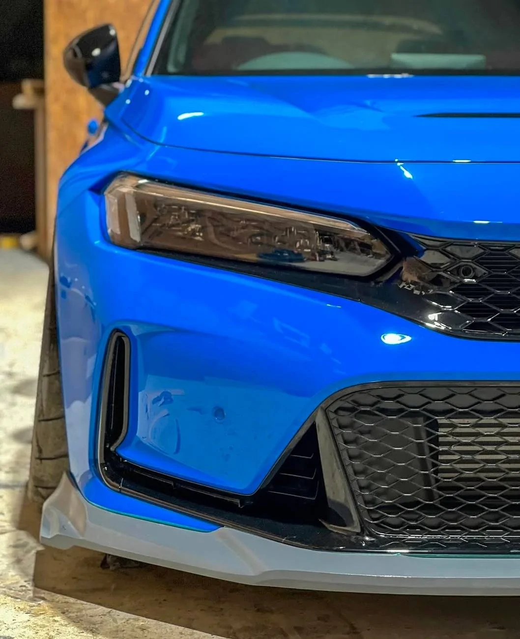

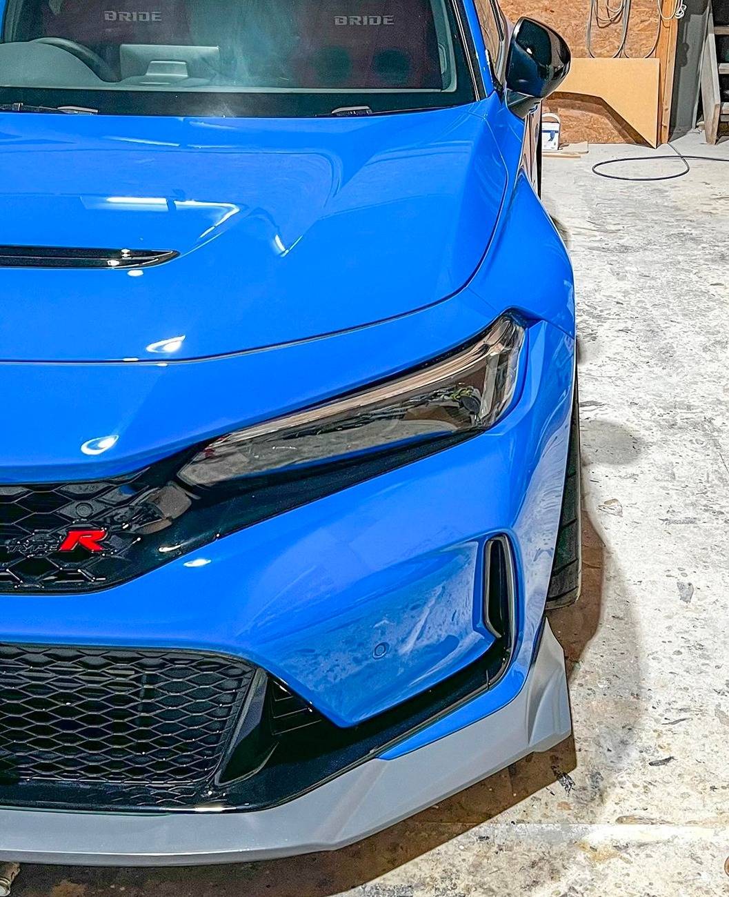

Project Aero lip splitter. Goes on using OEM holes with no drilling or tape required. I also got it paint matched and it just flows so much better with the car.
Very happy with how this turned out.
Looks great!! How much was it to color match it?

Agree this looks awesome. Mine comes soon and I’m going to have to paint it now! Any issues getting it painted? I read that HDPE plastic can be hard to paint. Did you just take it in, or did they have to do anything special?
