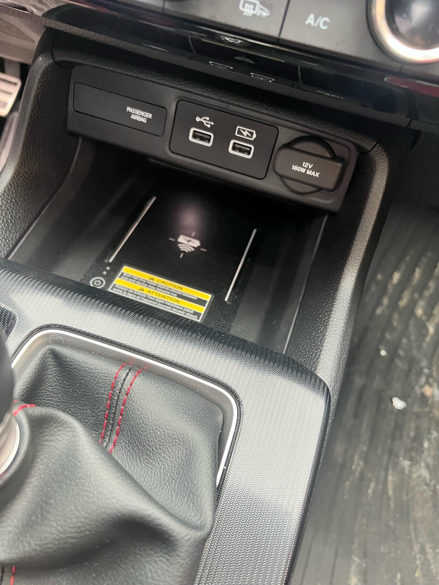

Hi everyone - thanks for taking the time to read. I know we all in the USA feel we got the shaft on options that our Canadian counter parts received on their 2022-2024 Si's. There is a YouTube Video that a individual adding a (Asian Market Spec) wireless charger to his car..
The issue he had was he used a dremal.. and had to cut some plastic. The one huge benefit though was he called out a site MikStoreShop that sent him the module and a adapter harness so you don't have to splice wires.
What did I do?
I recently asked online groups id anyone has used a Canadian wireless charger and bezel, sadly no one answered.. Well once in awhile I like to be the guinea pig, after all, it helps the community have information. I ordered on Ebay a used Canadian wireless charger and bezel. This also came with a connector so I was able to bench test the charger before adding it to the car.
After removing the parts and switching over the face plate for the USB's I am able to confirm that fit is 100%..
Next Steps:
A.)
I contacted MikStoreShop about this. I explained I would like to order just the plug-n-play harness that allows easy adaption into the Si without splicing. The person I was talking to said if I buy their HRV USB-C kit that fits in the civic (150.00 USD), they would through in the plug-n-play harness for the wireless charger. I ordered up the HRV to USB-C for the Civic.
B.) 1-29-24 - This package from MikStoreShop is from the Philippians mind you, but a UPS label was created yesterday. Hopefully I will see the package in a few weeks and I will report back.. If this works I will provide all parts numbers to do this swap. I think some of you wouldn't mind splicing wires, but, I am trying to come up with a solution that will make this literally like a factory setup.
C.) I did explain to MikStoreShop I would be making a video and they asked for a callout on it. My plan is exactly to do that. Since I already know the fitment is 100% without any modification this should not be too bad. I want to note this video will include to get remove all the panels, hardware, and screws to complete this change on the the 2022-2024 Civic Si.
Thank you for taking the time to read this thread. I will be posting updates very soon.
D.) Update fully installed now no issues!
2024 Civic Si OEM Wireless Charging Install (Plug-N-Play) (youtube.com)

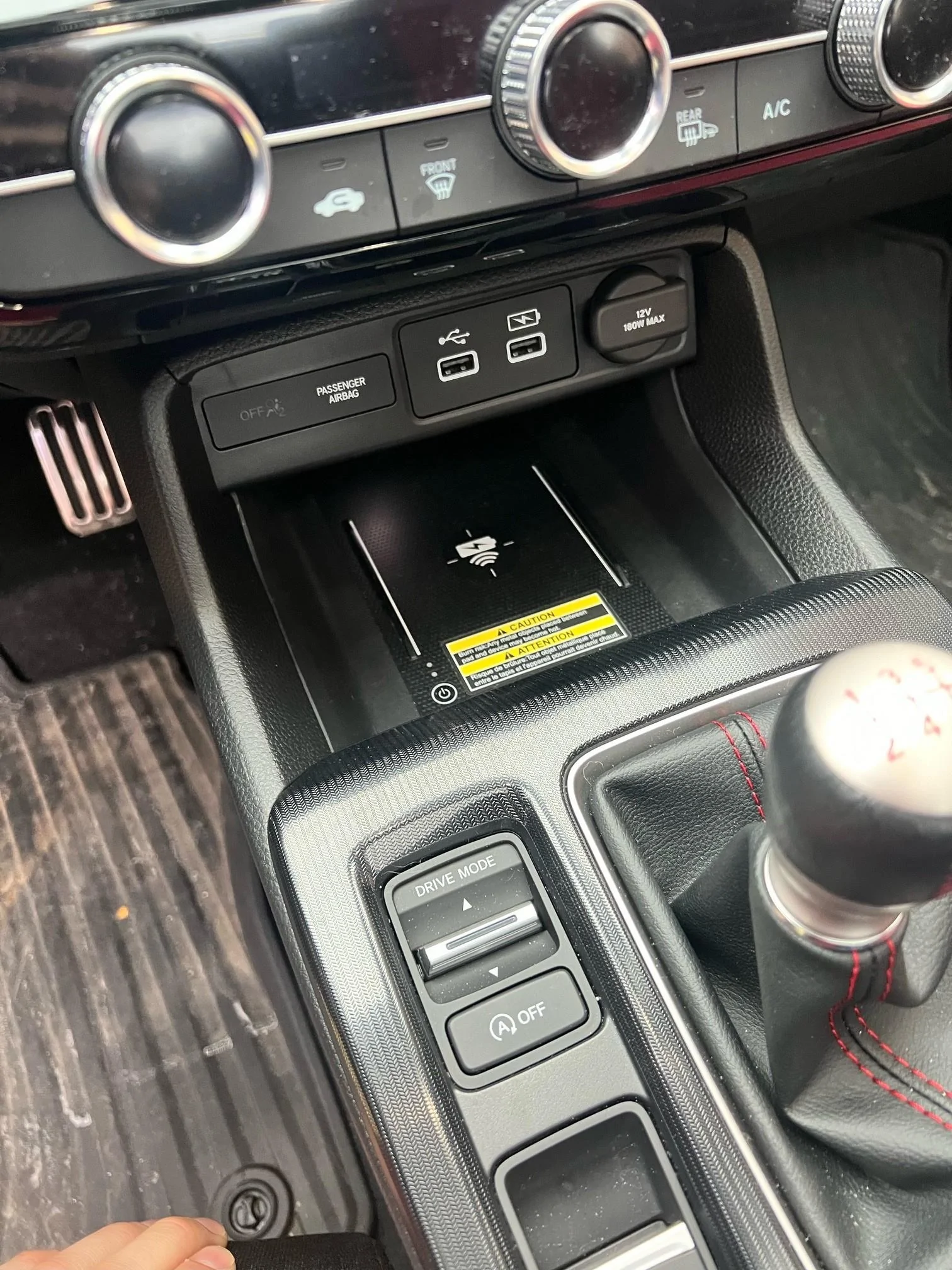

I did this install yesterday on my 25 si. A few points:
1. I ordered my kit from mikstore. The console insert they sent was not 100% compatible with my car trim, but I was able to trim a couple of extraneous plastic tabs and made it work. As a result, there is a small gap in the very front, but it is impossible to see from inside the passenger compartment. Otherwise the fit is OEM.
https://mikstoreph.com/products/civic-2022-genuine-wireless-charging-pad?variant=44313932595450
2. The Mikstore harness was 100% perfect for my car.
3. It is not absolutely necessary to pull out the radio as the video in this thread suggests. The plug that you piggy back into with the mikstore harness is accessible from below without removing the radio. If your fingers are dexterous enough, you can pull the plug and insert the harness. My hands are fairly clumsy and large, but I was still able to do it. YMMV.
4. Interestingly, (to me anyway) much like the mikstore mirrors, the harness provided seems to access the vehicle canbus because I now get a warning on my center screen about not placing metal objects between my phone and the charger.
