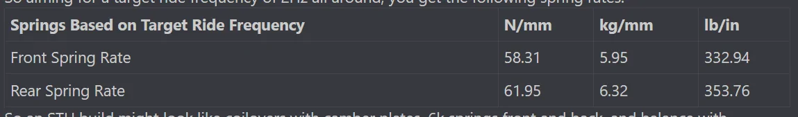

If you look into the swift springs for the FL5, they are a little bit stiffer than what you considered, but still, very close.
11th Gen Honda Civic 2023 Civic Si Spring Rates, Motion Ratio, Ride Frequencies, Autocross 1705191108393
11th Gen Honda Civic 2023 Civic Si Spring Rates, Motion Ratio, Ride Frequencies, Autocross 1705191055035

The cheap and easy option to up the front spring rate is a pair of OEM FK8 CTR front springs, which are 263 lb. springs. They really seem to balance the feel front to back and the stock shocks handle the rebound no problem. The increase in front spring rate definitely increases the roll stiffness and keeps the front tires planted better. An OEM FK8 20.5mm rear sway bar will also help to keep the balance. These are stealthy and cheap OEM+ upgrades IMO.
I'm currently using a Whiteline 22mm rear sway bar and It clunks on me occasionally and feels almost too stiff at times. I've been contemplating going to the OEM CTR rear bar to give a bit more of a compliant ride over uneven left/right bumps, it unsettles the car a bit too much. Otherwise the setup makes the car handle extremely neutral, a bit of understeer at the limit of the tires, lift off a bit to make the rear step out a little and power down to straighten it back up.
