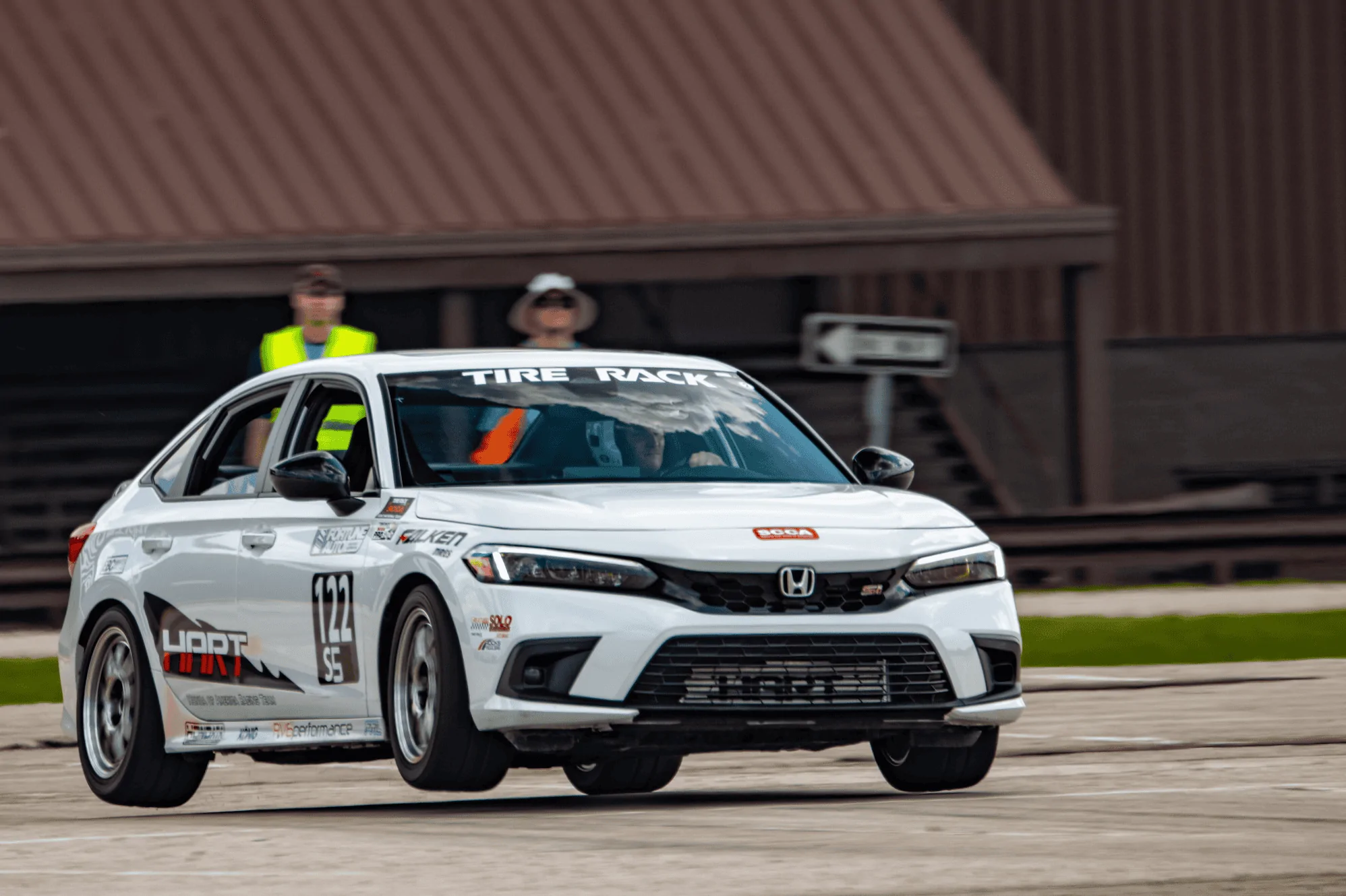

Hey @eromani , Honda of America Racing Team is currently running our 2022 Si in STH. Feel free to ping me with any questions about setup. Currently reasonably competitive. Will you be at Solo Nats this year?
Would love to talk about your STH setup! I'm only doing local events, running GS. Only thing I have so far is tires. Aug 27 will be my first event with the SI. The car is a few weeks old!
