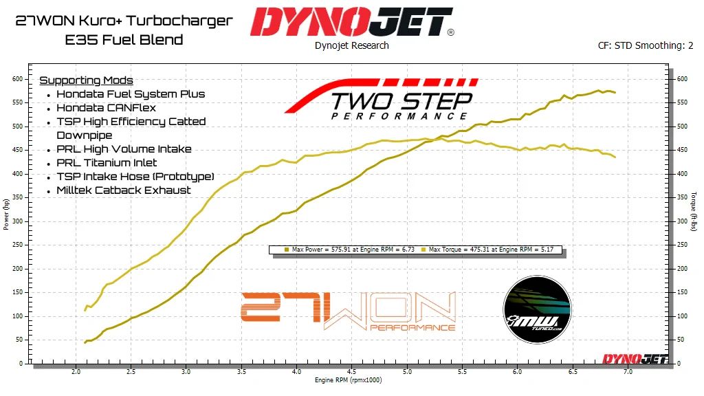

I usually tell people that if there is no plan to upgrade the fuel system, stick to the standard Kuro. But if you are willing to upgrade the fuel system, now or later down the road, the Kuro+ is a great option. See below for one of our early Kuro+ results (stock internals, stock clutch).
