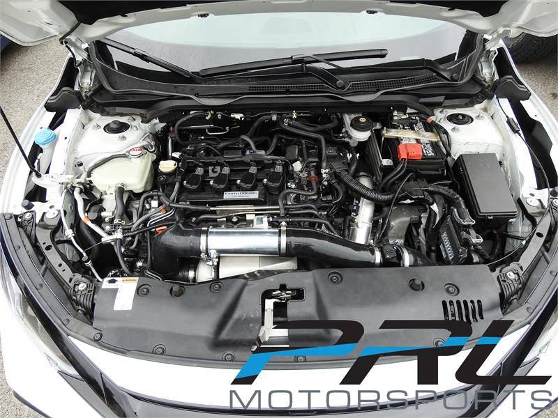

Hood clearance isn't an issue, have you seen PRL's Turbo kit?

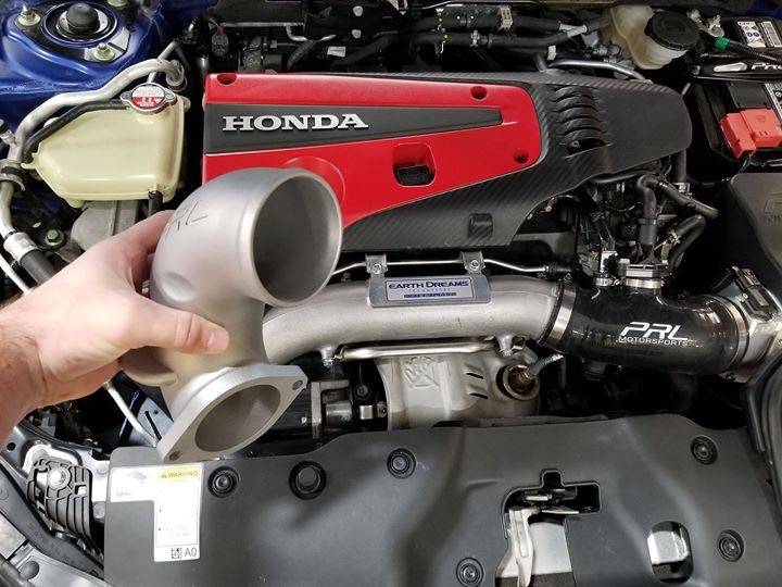

You mean the turbo inlet crossover pipe for the R?

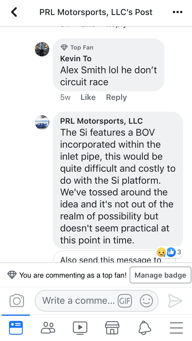

As for the Si I don’t think they should waste their time and $$$ on that since they have big turbo kit already that replaces it all.
