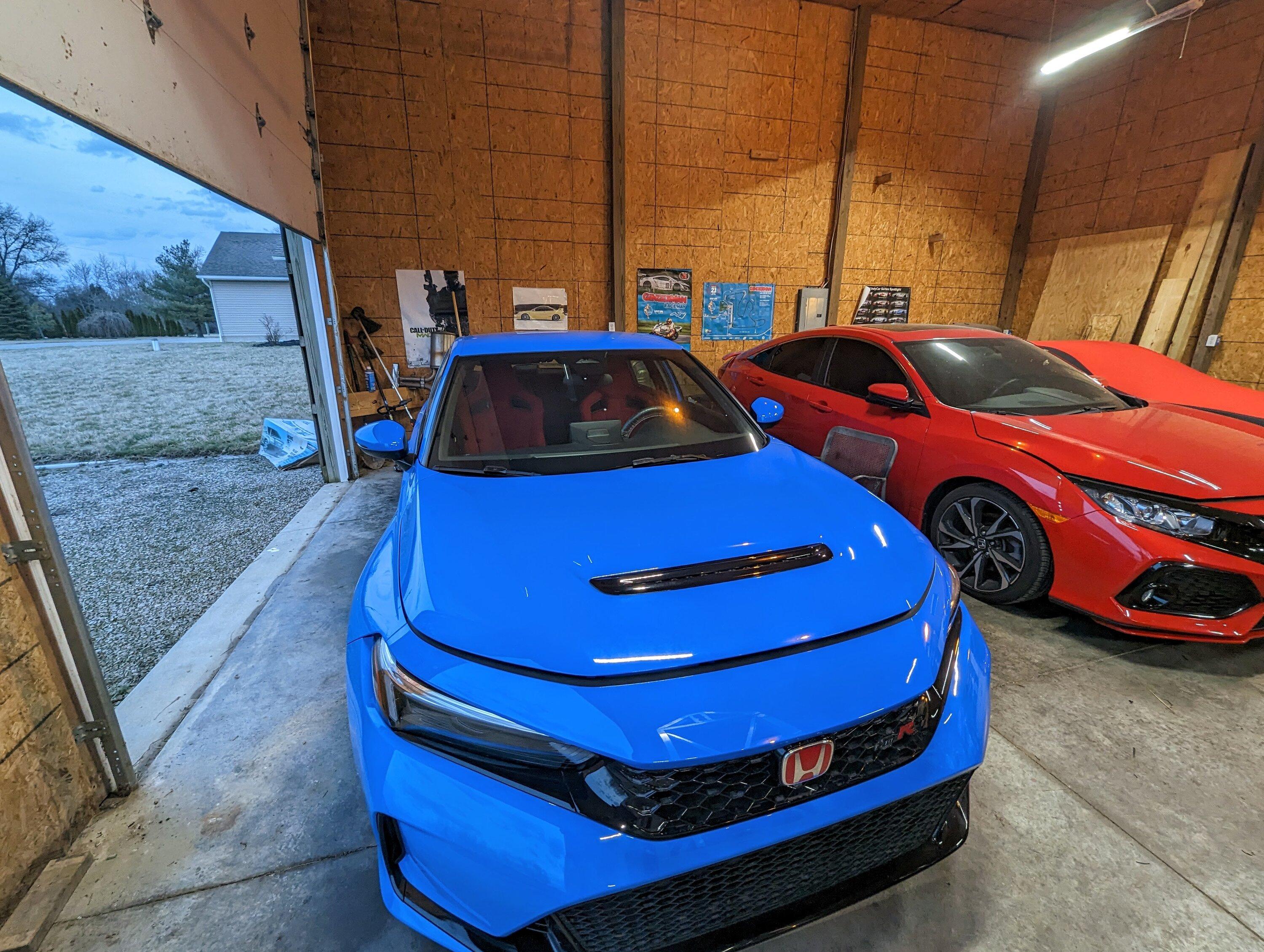

Personally I can't stand gloss black anything especially on the interior or exterior of cars. Really hard to keep clean and it scratches extremely easy. So part 1 of my de-black-ification is changing to body color mirrors. Really brings back that 90s Honda styling and matches the rest of the car. Please feel free to reference these part numbers for your color of choice, as always please verify they are correct with your dealer before ordering as I am not responsible for you ordering wrong parts. They ran me $38 with tax for both sides. Of course with all the different colors you don't have to match the body.

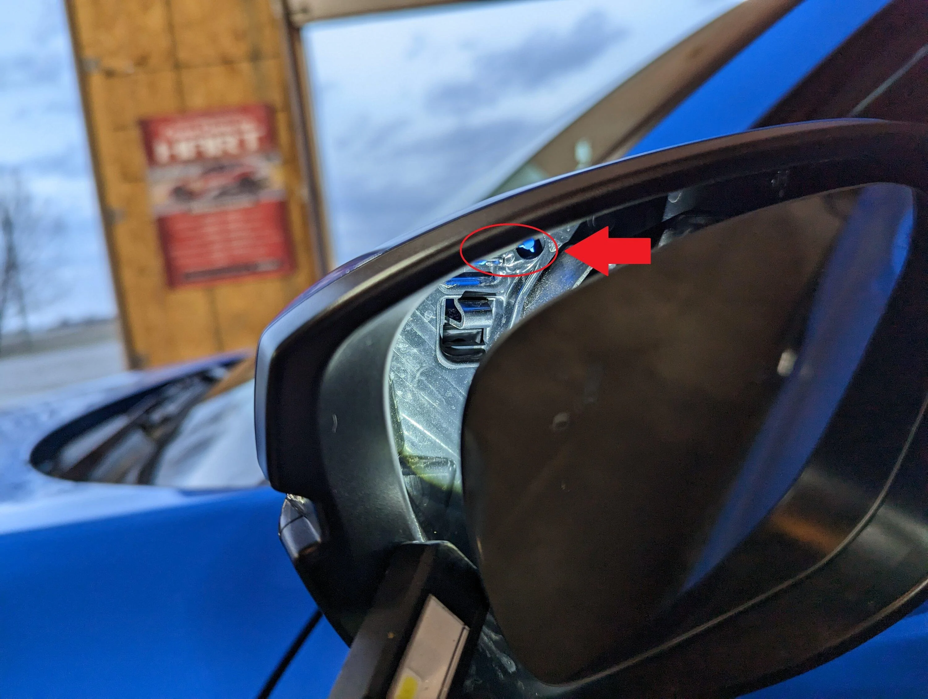

As far as install there are two methods you can use. The first mirror I opted to remove the glass entirely (as I referenced a youtube video). Tilt the glass to one side and you can slide a screwdriver between the white base and the black clips that are attached to the glass. Simply twist to separate. Repeat on all four locations to pop the glass out. There are two connectors to unclip. From there you have full access to the inside. I found re-clipping the glass to the housing was very difficult. I would not choose this option again.

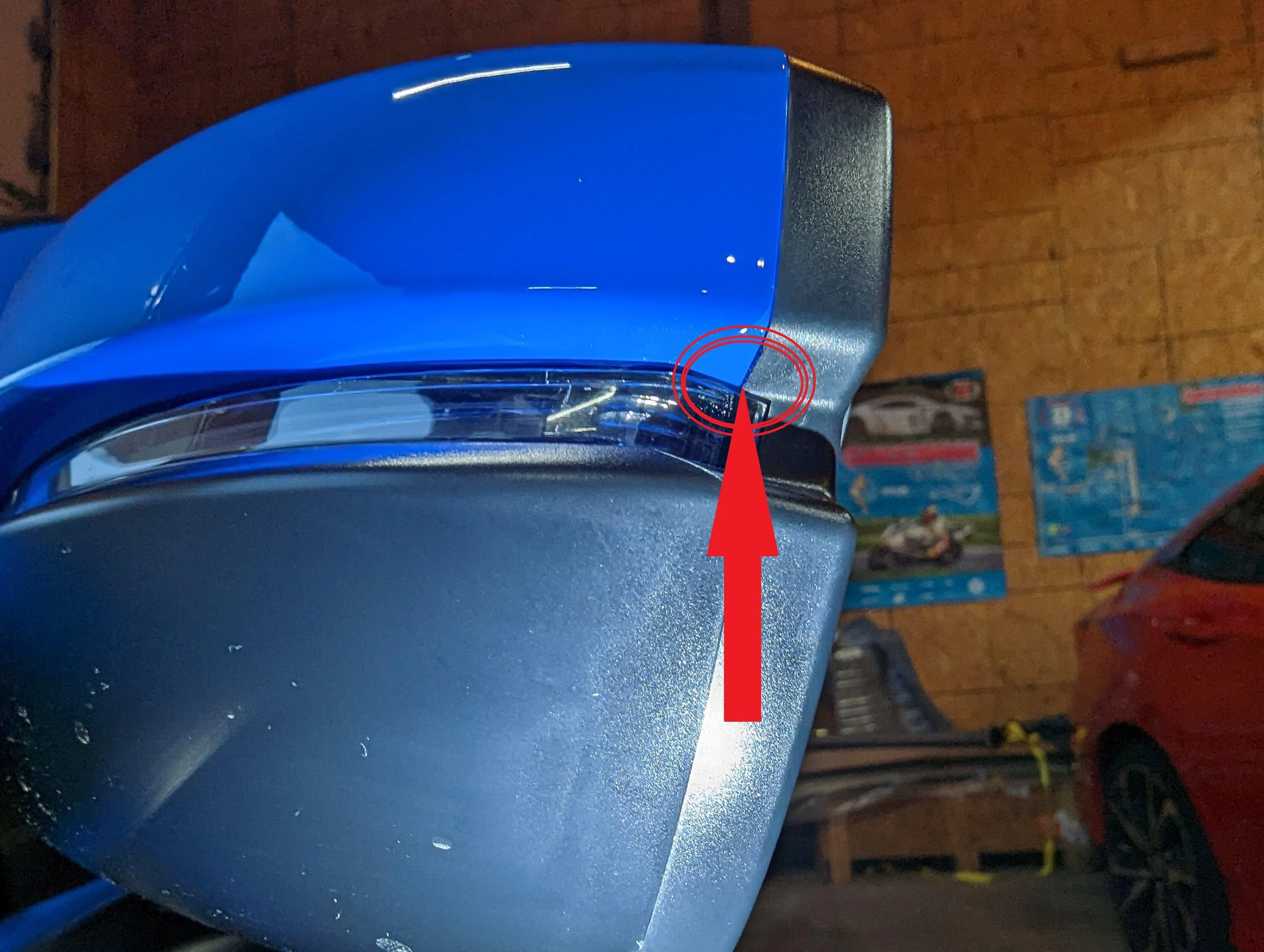

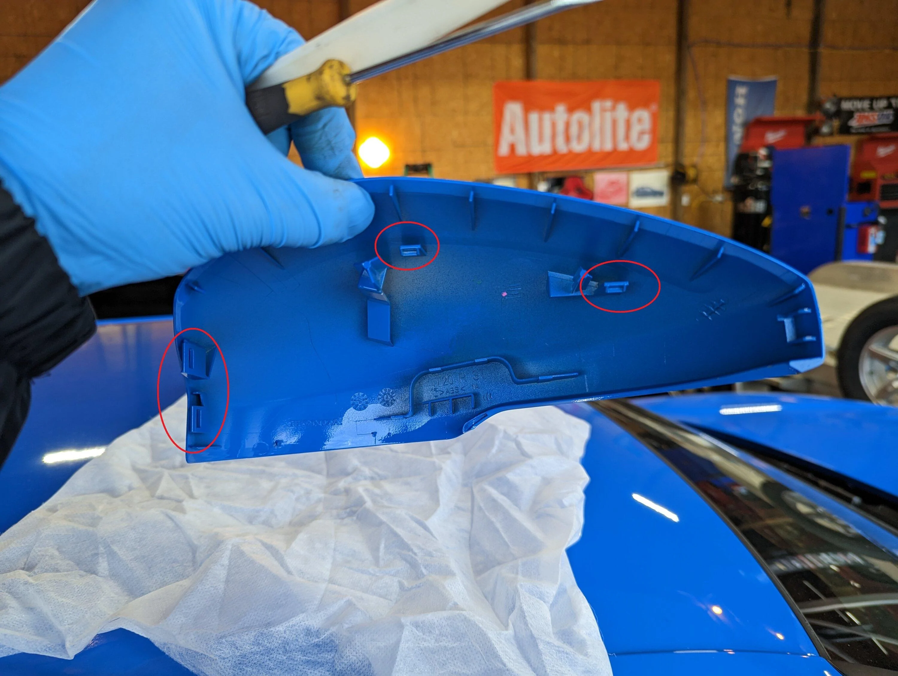

Option 2 is what I tried 2nd after noticing you can access the mirror cap clips just by tilting the glass. You only need to access the one to force it out enough to create a gap on the exterior. I did this by jamming a clip underneath the clip and wedging it in place. Once you create a gap in the corner by the turn signal gently insert a small pocket screwdriver enough to get a gap on top and slip in your plastic pry tool. After you slip that in just work around the sides and pull out. Good chance you break some clips on the original. After removal simply line up your new cap and snap into place. It is important to note even if you fully remove the glass you can still only access 2 of the 4 clips, as the other are in a blind hole.
