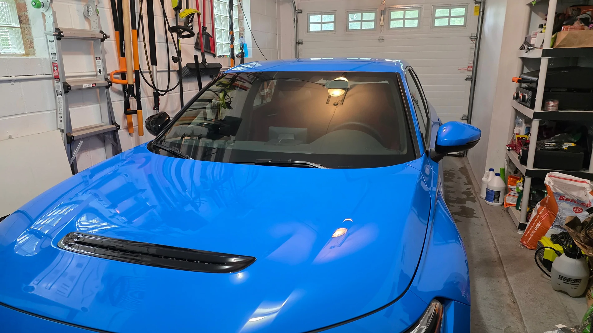

Thanks for this thread! I just replaced my black caps with boost blue, Option #2. Came here after my caps arrived (Honda parts connection, like $33 and $35 for each) to figure out how hard/easy it was gonna be.
Done in like 2 minutes. Just using a long flathead to push that outer most clip enough to slide a panel tool or anything else really thin in the gap is all it takes to pry it loose.
Broke nothing, so I can go back to black later if I want. Thanks!
Halfway through in the picture.
