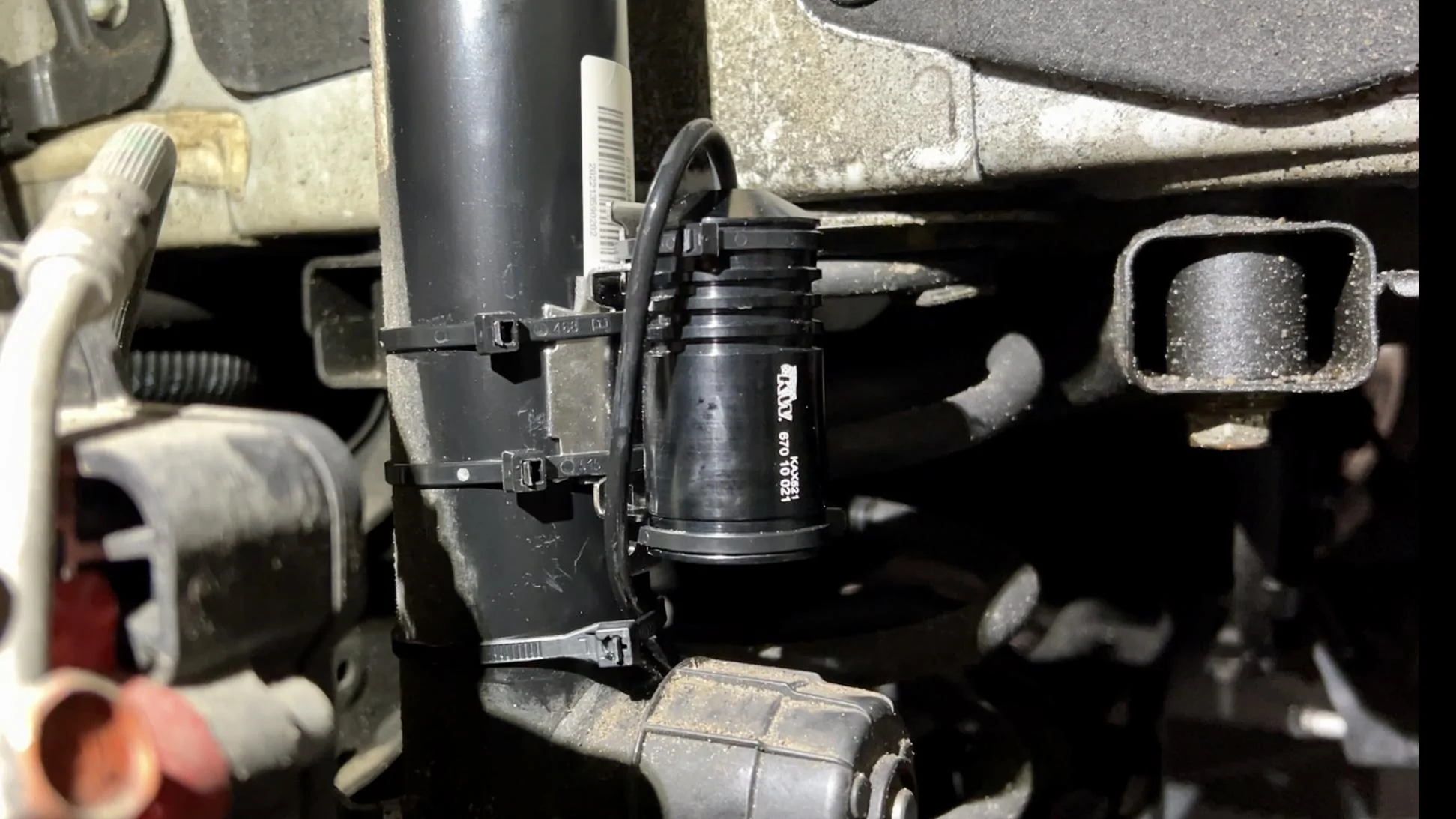

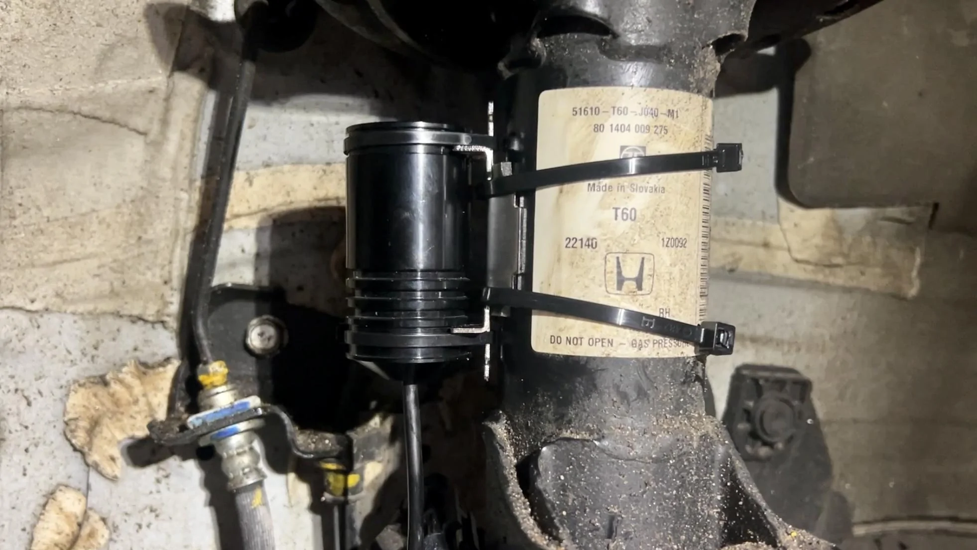

My solution: unplug the adaptive dampers and install a damper cancellation kit. Most would already do this when installing coilovers, I just did it with the stock FL5 suspension. I used this kit from KW for the FK8 (~$450 shipped) and the results are fantastic. No error lights, all drive modes are functional, though with passive dampers.

The KW kit comes with pretty good installation instructions, though they're in German. I had no issues attaching them to the stock dampers f/r. Jack up car, remove wheel, clean mounting surface with alcohol, apply sticky tape, zip tie canceller to bracket, zip tie bracket to damper, then zip tie cable so it doesn't rub on anything.

Rear:

Front:
