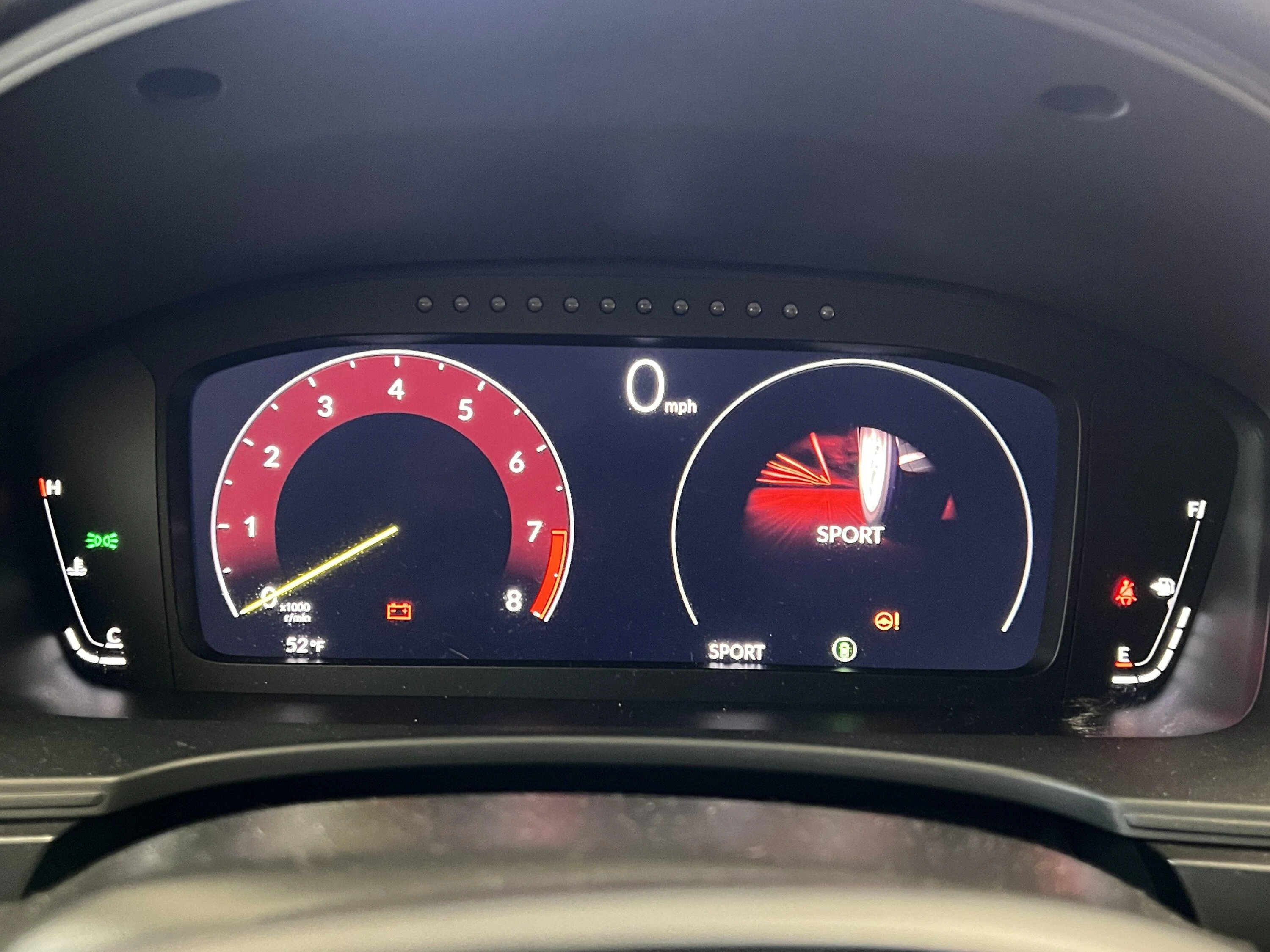

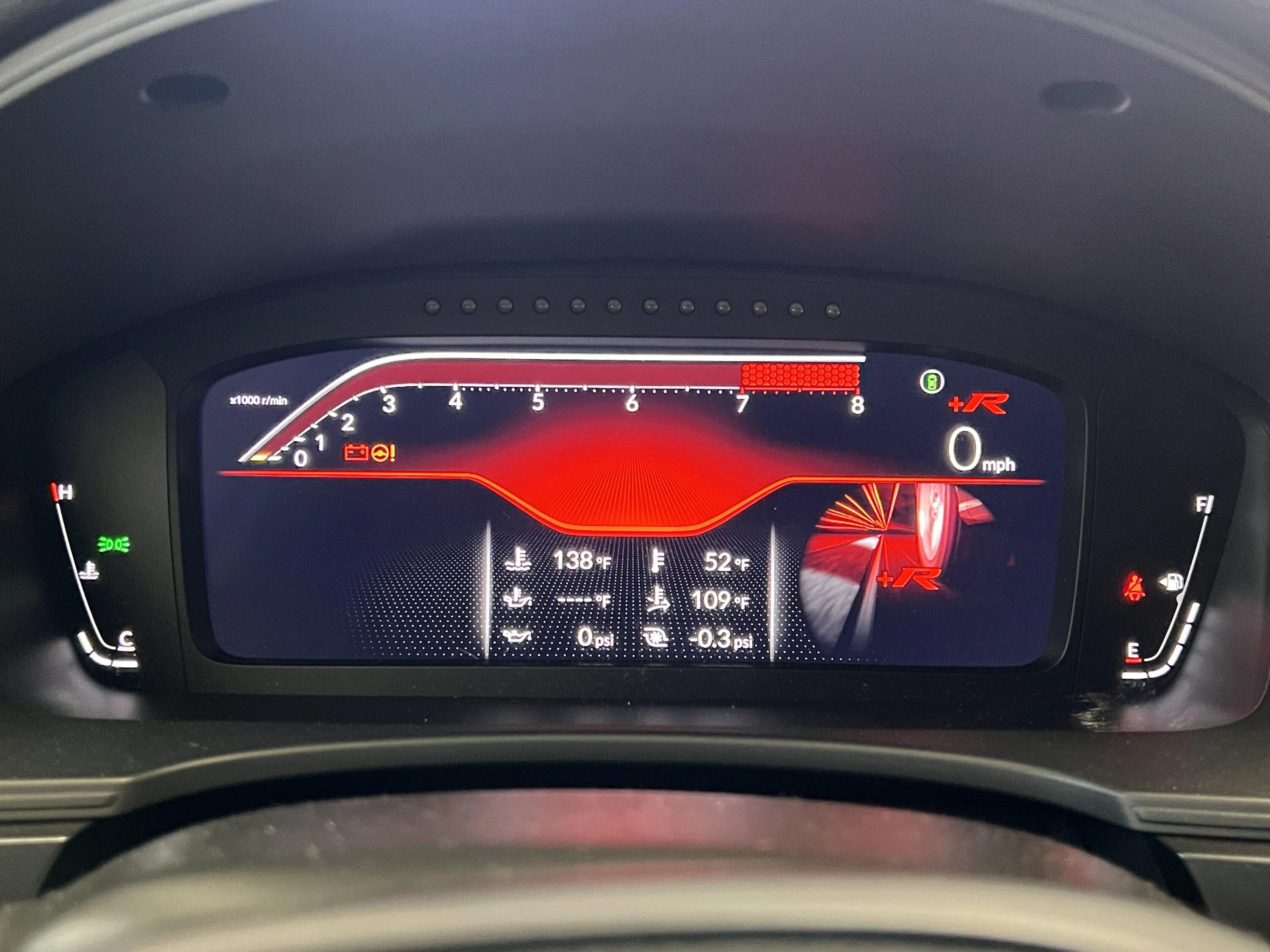

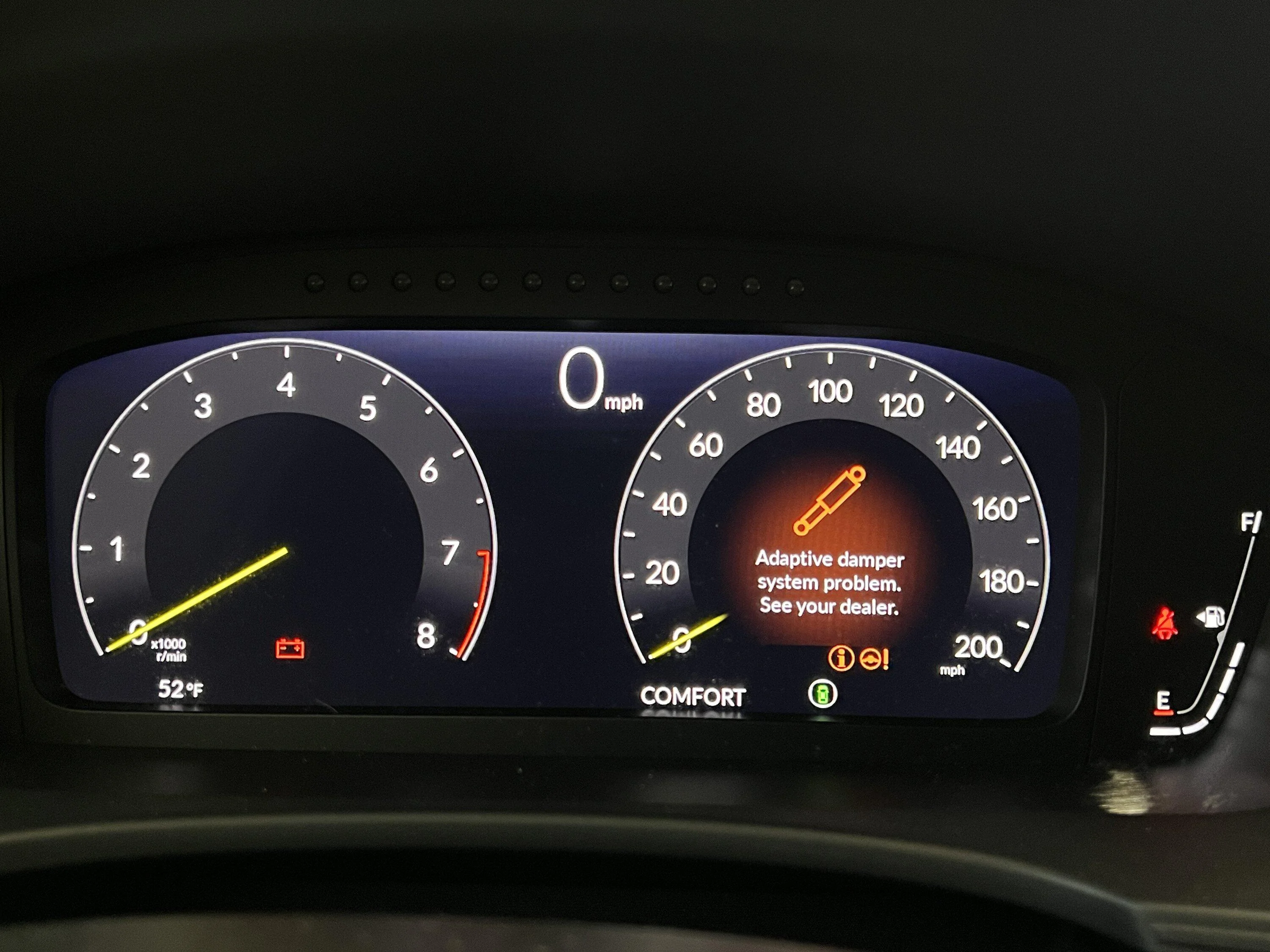

Just for fun....I ordered an ADS control unit from a '21 Type R on ebay. $42. I'll see if plugs in and works
Ok, I plugged in the ADS control unit from a '21 Type R, getting an "adaptive damper system problem" message on startup, but I do have switchable drive modes. I won't know if it makes any change in stiffness until I pull the wheels off and plug everything back in. Tbh, I'm so happy with the dampers disabled just the error message makes it a no for me. Will report back when I have a chance.

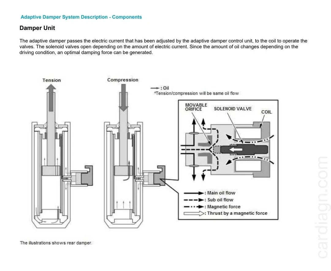

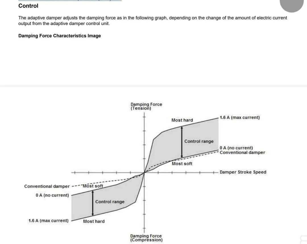

Just thought I'd share a recent experience on track (Aus Time Attack) where the suspension damping goes full hard during hard cornering resulting in the car bouncing way off line...
I'm really keen to try and make something like a patch harness that can perhaps halve the current output going to the shocks (appears to be between 0A to 1.6A) which might lessen the bounce. The system is closing up that valve far too much under high load!
