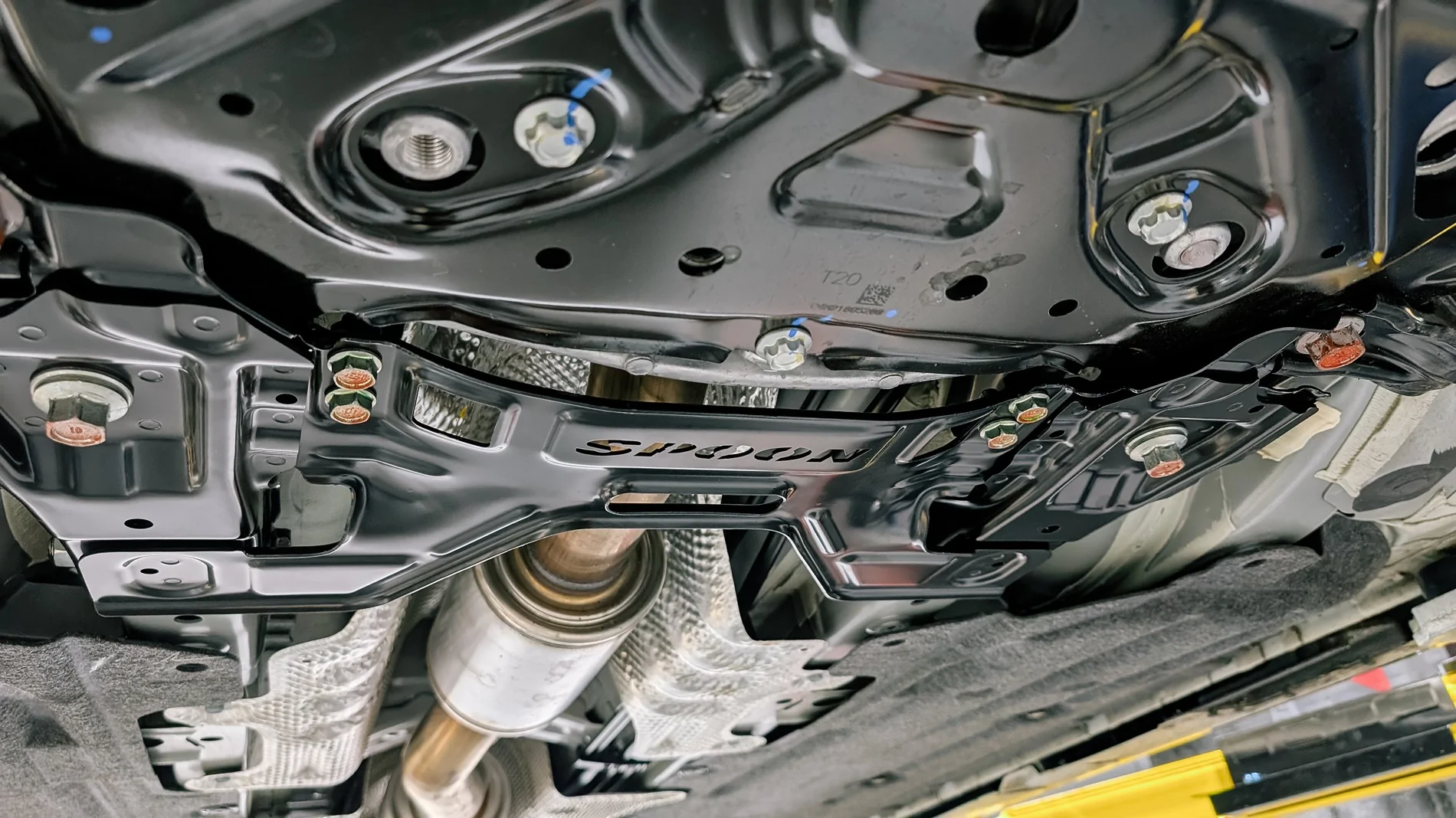

We installed this on a customers car along with other Spoon goodies. It definitely all transformed the car and chassis. Responsive, a lot tighter/less roll, but not harsh (car also has mugen vibration dampers).
- Spoon lowering springs
- Spoon front and rear subframe rigid collars
- Spoon front lower stiff plate
We are a Spoon dealer as well, let us know if you're looking for any parts (Spoon or otherwise). And if you're looking for a Type R specialist shop, we are here to serve the DFW and North Texas area!
11th Gen Honda Civic Spoon Sports Front Stiff Plate PXL_20251005_001822842

@ctechauto does the Spoon stiff plate displace the skid plate or can both be installed?
The spoon stiff plate replaces the factory chassis brace. If you mean the splash guard (skid plate) under the engine, that is untouched as its in a different spot. The chassis brace is towards the front-middle of the car covering part of the end of the front pipe and the beginning of the catback exhaust.
