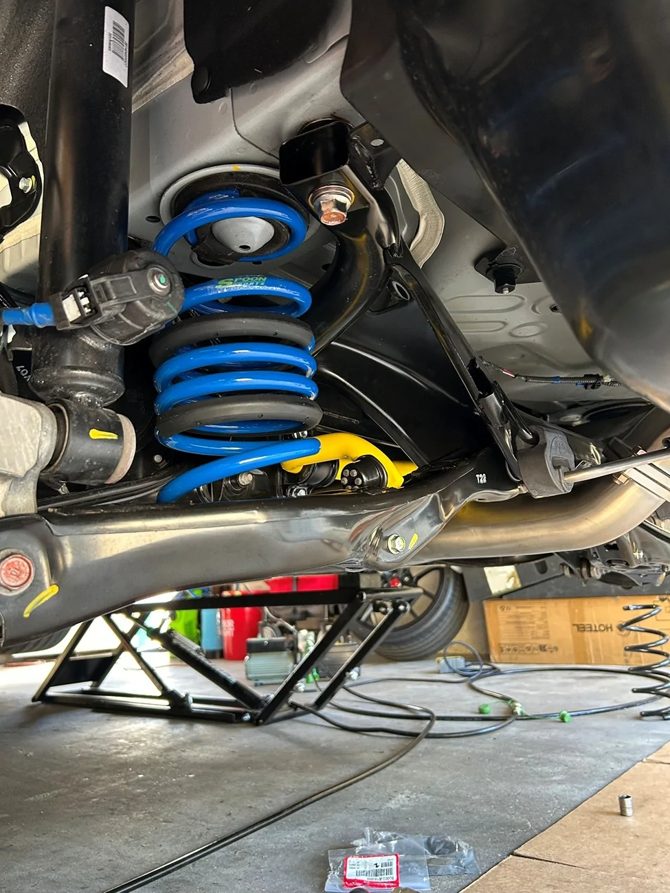

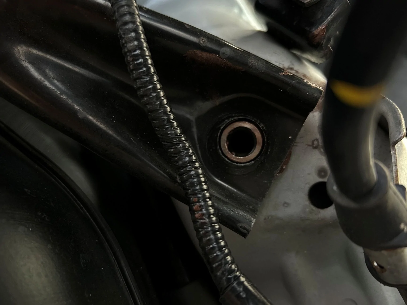

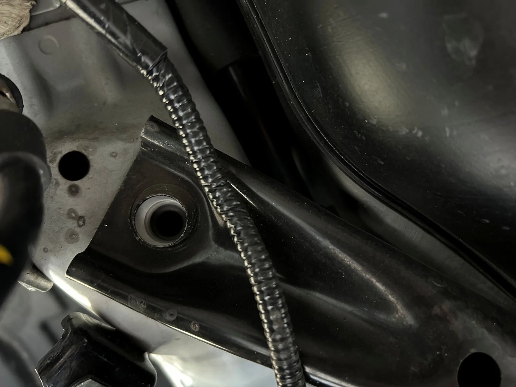

I got around to installing the Spoon springs, Spoon rigid collars, and the Spoon rear sway bar. Everything fit spot on. The springs feel much better on the highway even on +R mode. I never complained about the car being too stiff because it's a CTR and I don't expect it to be a smooth ride, but it feels nice with the Spoon springs. I posted a picture of a single bolt removed from the rear sub-frame and you can see that it's really not centered until the rigid collar was pushed into place. I had to use a small pry bar to shift the sub-frame over a bit. Now my alignment is OFF because my steering wheel is slightly to the left when going straight. I just need to put some drive time in to let the springs settle for a bit before getting an alignment. The rear sway bar is like every other 25MM sway bar. It helped with the turn in. I have a freeway on-ramp nearby that has a hairpin entrance and I no longer need to fight the car on that turn.....with the spoon springs and rear sway bar, the car will rotate to the direction I want it to. The other thing I noticed about the rigid collars is that you no longer feel that slight vibration when the A/C is turned on. All and all installing everything was a breeze. I recommend removing the passenger side axle nut and push the axle out a bit when lowering the knuckle and have some patience. The driver side is much easier so I recommend everyone starting on the passenger side.
