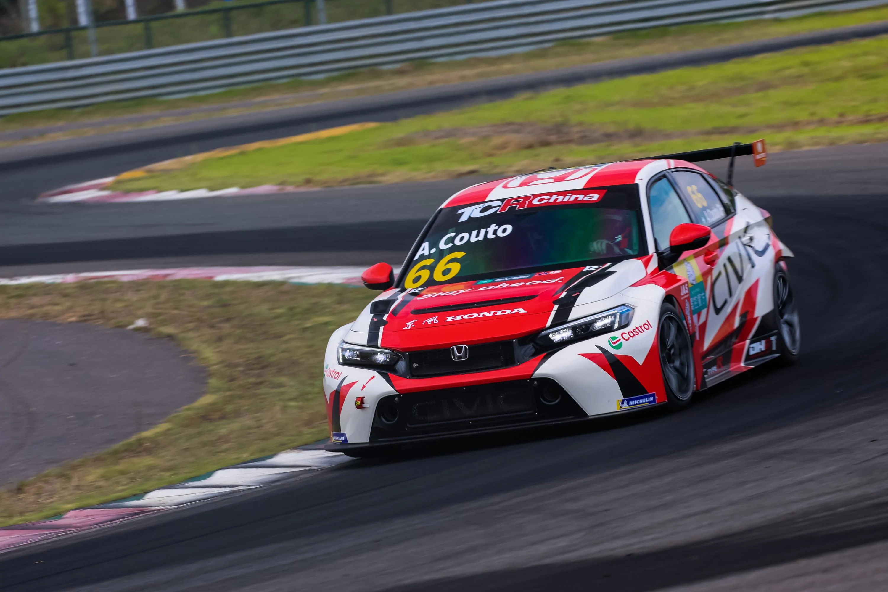

  • If this was such a drastic issue, why are all the FWD TCR cars even wider with extreme lower offset 18x10 or 18x11 wheels? The mechanical advantages gained by running a lighter 18" wheel and tire setup with available popular offsets is greater than utilizing the factory sizing. Please reach out to these guys that they messed up their car by modifying the scrub radius.

I don't think the whole "but racecars do it" angle is helping anyone. Is the race car otherwise stock? No?
Irrelevant.
Also the assumption that demand would somehow be affected, also highly skeptical. Give me some data that validates the reason people buy wheels, performance vs looks.
My guess is that people buy wheels off what they see on Instagram, probably not through extensive research on how they would negatively impact scrub radius.
Irrelevant.
In most of those series the factory suspension mounting points are retained and they use helm joints or hard rubber/solid bushings replacing a lot of the OEM ones. Ofcourse aftermarket dampers/springs and other parts are added... They still start with a factory civic body in white and use the dual axis strut setup and all factory mounting points. That also doesn't take away from the fact that people striving to do everything possible to eek the most performance out of the car are doing exactly what laymen are saying is "bad". It's not irrelevant, you can look at stock class Time attack cars as well if you want something to reference thats less modified. People with nearly unlimited budgets running complete custom wheels are choosing to run 18's over any other size should point to something.
Wheels developed for the FK8/FL5 chassis follow the same process all chassis specific wheel fitment applications take. Spoon and Mugen are not going to release wheels that will damage their reputations and offer negative performance over factory. Spoon and Mugen work directly with Honda in getting chassis/suspenion information and they both concluded 18x9.5 +40 or +45 is best. The 19" Spoons coming out will most likely be +45 as well since they use the same factory as the Regas coming out in that same size. All these independent companies making chassis specific wheels all ended up around the same spot?
Why people buy wheels is somewhat irrelevant to the reason why the products are developed in those particular sizes. It wasn't for hard parking instagram flexers when you are talking about Titan 7, Rays, Volks, Mugen, Spoon etc. They aren't going to invest millions of dollars in forging molds to produce wheels in a size that everyone hates and feels makes the car worse. These companies also do a considerable amount of R&D when coming to the sizes they offer.
To split the hairs here, I think there's a relatively middle ground to this. I think race wheel manufacturers are trying to sell wheels, and will likely make wheels in the most popular offset in order to sell more wheels. Most of the talk about offset is in relation to how it looks, and zero conversation about geometry. I think if someone is actually setting up a racecar, they are looking at all things considered. As far as Mugen and Spoon go... most of their stuff is tacky garbage to begin with.
I think +45 offset probably lands in a workable zone of geometry, especially with customized suspension. I also agree with the opinion that Honda probably selected +60 for a reason. I'd be very curious to see a geo chart of OEM FL5, at the very least as a starting point for future mods.
I really want to believe you. Not so much about 18s; I've said many times how much I hate how 18s look on the DE5. But I just don't think speculating on why manufacturers pick given offsets to manufacture is all that compelling- it's already been said, they're in business to sell wheels. If they only catered to race cars there would be a whole lot of margin to miss out on...
And anyway another point that is being missed with all this race car talk is how the car feels. As much as I'd like to think I'm Lewis Hamilton, I'm not, and about 99% of the time I'll be spending in my car will not be on a racetrack. I personally really enjoy the way my car's steering and handling feels for my purposes- pretty much backroads jaunts 3-4 times a month and a "motorsports-type event" 4-7 times a year. I don't want to do anything to jeopardize that. So arguing over what reasons race cars decide to go with 18x9.5+38 is still pretty irrelevant to me, whether they use factory mounting points or not. There are many compromises that are overlooked when chasing lap times; I'm not about that life.
There's a couple different sets of wheels I could buy right now in 19x9.5+45 that I really like. I'm still looking for definitive evidence that if I go that route I won't hate the changes it brings. I really could care less if there's a performance impact or not- I care more about the sensory element anyway, and I'm not convinced it's worth compromising so I can be hella flush yo.
You can get custom offsets for some higher end wheels right? I know you can with HRE but I was hoping some of the Japanese brands offer this too...
