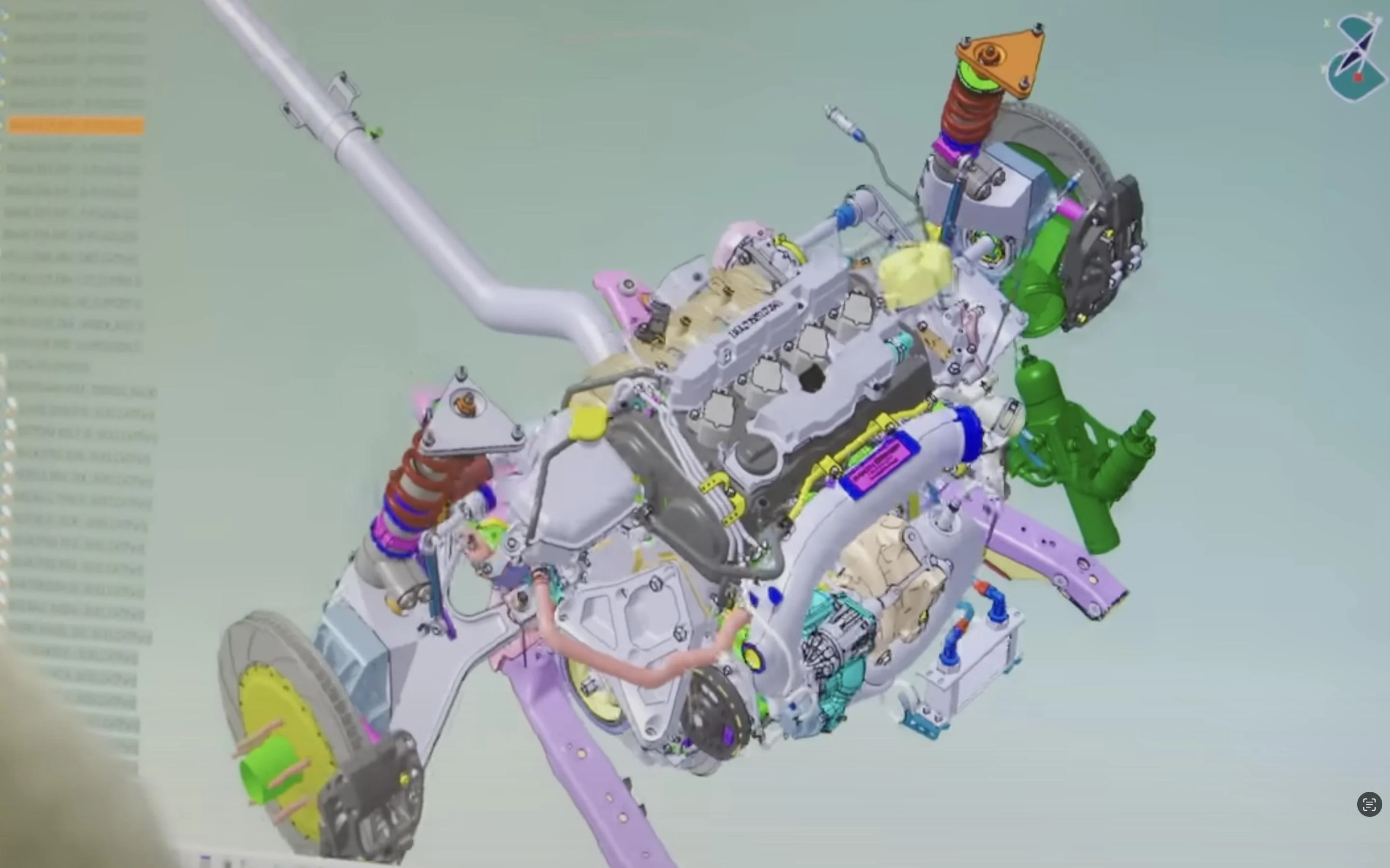

The CTR TCR car doesn't have the dual axis strut design. It's a standard MacPherson strut.
Got it. The way it was outlined here I thought it was based on the TC car and the only changes were the dampers listed in the far right column. I couldn't find a picture online to confirm until finding some obscure YouTube video of them working on it just now.
https://hpd.honda.com/Articles/Touring/TypeR
11th Gen Honda Civic Enlightening read on wheel offset and effects on suspension and steering TCR Suspension
Thanks for this drawing. This knuckle design is just crazy. I took a few pics of these cars last month:
https://www.civicx.com/forum/threads/fk8-and-fl5-tcr.85629/
