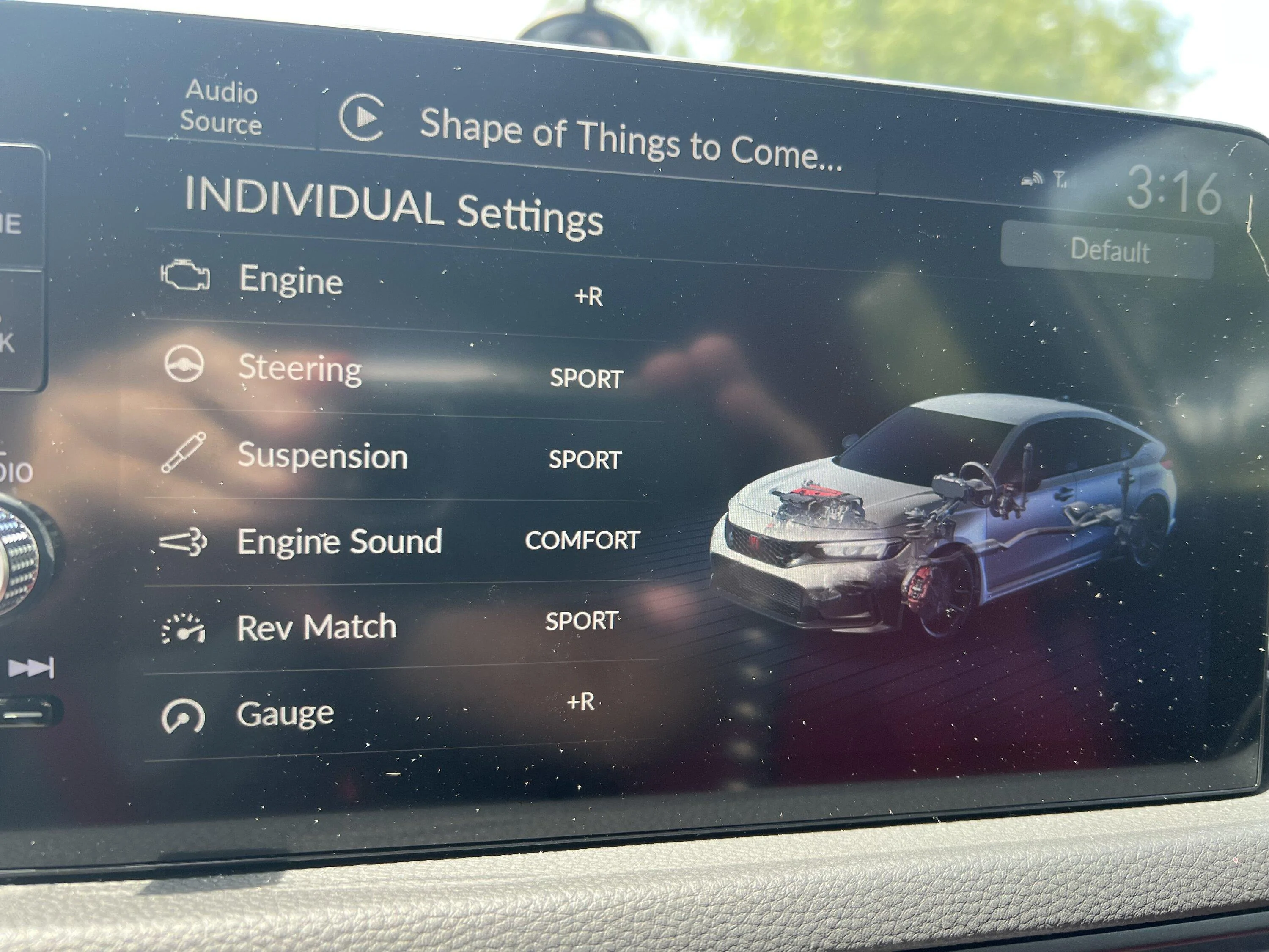

Acura ITS ADS installed.
I can definitely attest that everything works properly, including push to hold for full stability/traction control off.
I differ from the video reviewer in post #72 a bit. He said: "Way smoother and softer, less aggressive"- I found that not to be accurate. My take lines up much more with how Savagegeese reported it. If you are expecting this to be a transformation in how the car handles fast corners, it is not.
There is a backroad I take with extremely sharp corners, and an on-ramp at the end where you might find yourself entering at extralegal speeds. ;) How the shocks behave on track and in high speed corners is unchanged- the car will still bounce in +R. But I would say it bounces less. I would postulate that the best way to describe it is like this; There are 4 settings that have been setup with this system-
Setting 1 most aggressive= +R in CTR, not used in ITS
Setting 2 second most aggressive= Sport in CTR, Sport+ in ITS
Setting 3 third most aggressive= Comfort in CTR, Sport in ITS
Setting 4 least aggressive = not used in CTR, comfort in ITS
To summarize, it feels like everything is just moved down a setting, with a new comfort setting added.
All that said, I had an FK8 for a couple years, and still have access to driving one often. Even with the ITS ADS computer, the FL5 is still much more aggressively dampened than the FK8. I cannot report on the Limited Edition car, as I have never driven one of those.
I don't regret this mod, but to answer if it's right for you, read the bit a few paragraphs up about the settings, or test drive an ITS.
I think I prefer it right now, because having stability control fully disable with damper settings more like FL5 Sport is more desirable. Also, comfort is even more comfortable, but not too soft and unusable like the FK8's comfort was.
Thanks for reading!

Installed as well - had to try it. Below are my initial thoughts. I like it so far.
The first 15 mins of driving I wasn’t that impressed and didn’t seem to notice a big difference and was thinking it’s a cheap mod what was I really expecting. After driving some more I started to like it. Comfort is softer than stock, but not as soft as ADS cancelled. Looking back at ADS canceled that was probably a little to soft so I’m fine with this. Sport was similar to stock comfort, but I’m not sure it’s as good. I really liked the stock comfort mode so I’ll need more time with ITS sport to see if it matches up. Sometimes sport mode felt a little bouncy. +R is awesome. Did I just say that? Seriously, I drove more in +R mode than I did in the past 5 months of owning the car. On some roads +R felt less bouncy than the sport mode, I’m not sure how that’s possible - maybe it was just the road. +R is still firm and a little bouncy, but it didn’t shake the back of my head like stock version.
Overall, I look at it as giving up the stock comfort mode, which I drove 100% of the time and really really liked it, but now getting a little more comfortable comfort mode and a sport and +R mode that I can actually use for daily driving. I’m actually looking forward to driving the car more and testing sport and +R mode. Lastly, I felt like you don’t need individual mode anymore because you can actually flip between modes and they are appropriately dampened, which I really like. It was nice flipping modes and seeing the dashboard change and the road firmness mirrored it. I’m going to keep ITS unit plugged in for now and keep testing.
