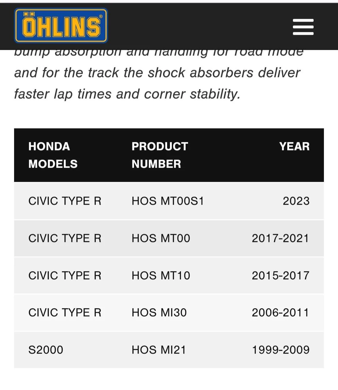

Hold up, this is the exact same part number for the kit for the FK8. I thought that it didn’t quite fit right with height adjustments?
I checked that before posting. The part numbers are different.
FL5 = HOS MT00S1
FK8 = HOS MT00

That's great news about the Ohlins!
