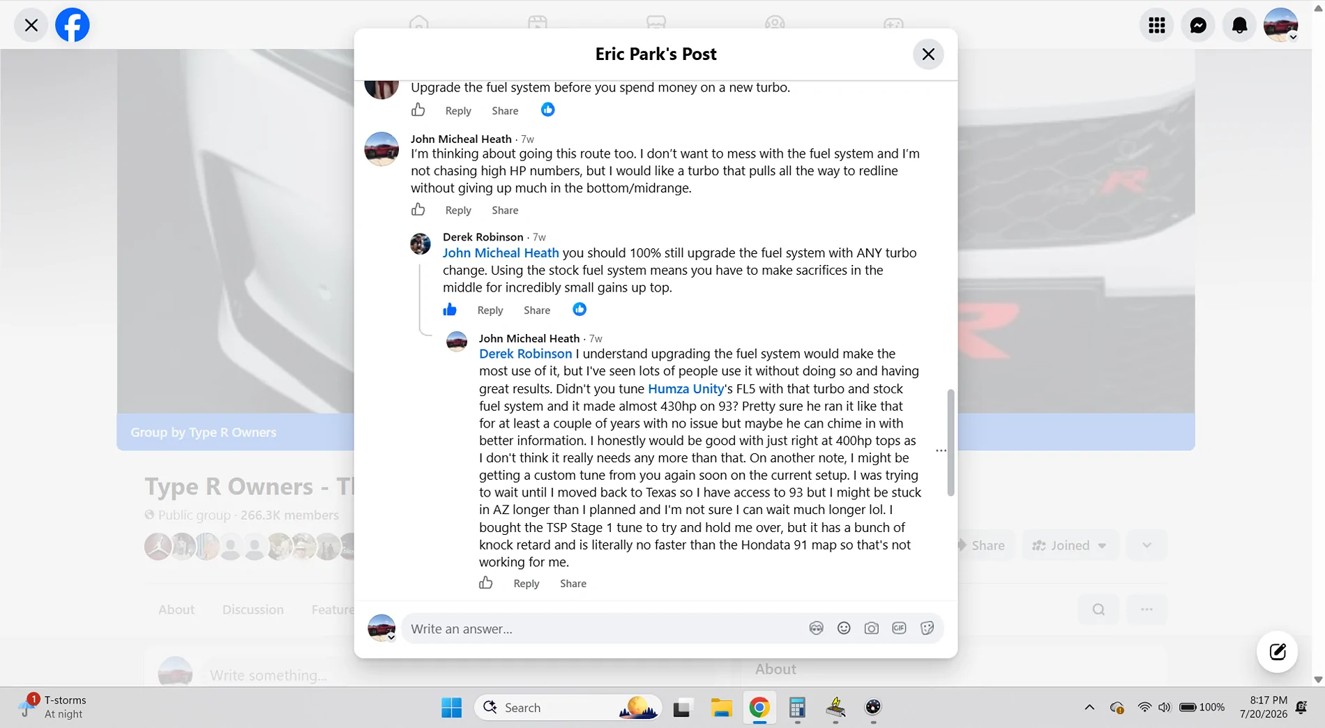

Also, here's a couple of examples of what he has said. One from a comment I made on someone else's post on Facebook, and one from an email directly from him when we first started talking about parts to use, what I was going to use the car for, etc. I forgot that his response was to using flex with 91 octane as that is what I am limited to here in AZ at the moment, but I doubt that would change once I move and have access to 93 again.
11th Gen Honda Civic Anyone Want to Share Data Logs w/Kuro Turbo? Untitled
Email Quote -
"You can certainly use ethanol if you want, but you will operate on razor-thin margins for the maximum output available when confined to the stock fuel system... especially when your base fuel is ACN91 (which tends to require a richer mixture to avoid knock, taxing the system harder natively).
There's absolutely gains to be had from ethanol use instead of just the low quality 91; but I strongly suggest installing an upgraded high pressure fuel pump at the very least to make it worthwhile with the least headaches and highest level of reliability."
