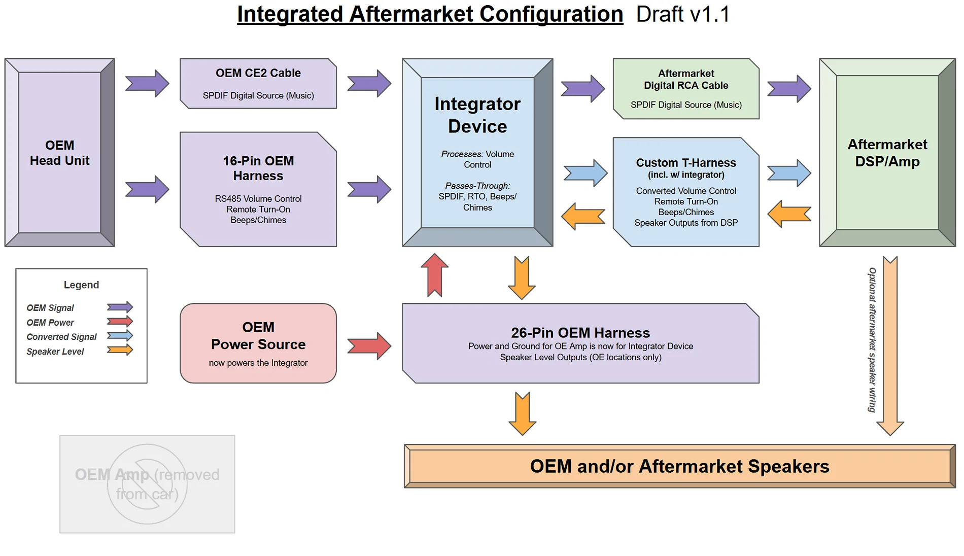

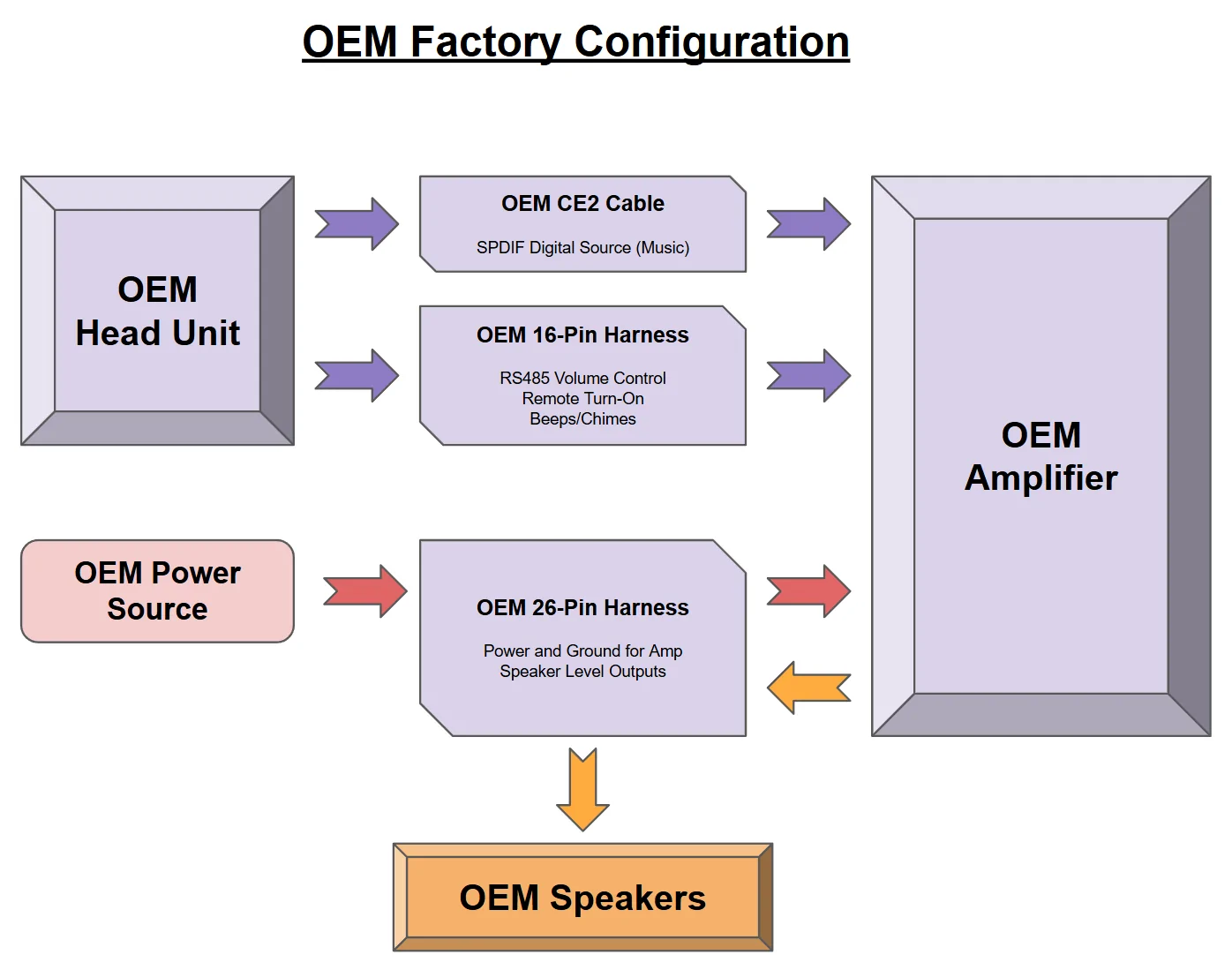

Wiring Diagrams as requested!
I included the "before" along with the "after"
11th Gen Honda Civic BUILT: Digital Factory Infotainment Integration Honda Civic Bose / Acura Integra ELS 1774625463023-s7
11th Gen Honda Civic BUILT: Digital Factory Infotainment Integration Honda Civic Bose / Acura Integra ELS 1774626304149-
Keen eyes may have noticed that I decided last night to make this a totally plug-and-play affair, integrating the factory power source originally for the factory amplifier, to now power the Integrator Device. Since this travels on the same OE harness that also feeds the amplified signal to the speakers, this frees things up to build a custom T-harness between the Integrator Device, Aftermarket DSP/Amp, and the factory speaker wiring, making everything plug-and-play (you just need to provide power and ground for the DSP amplifier, as well as supply your own RCA digital cable of appropriate length for your chosen DSP install location).
This also means that the factory amplifier can be fully removed from the car, and the Integrator Device can be installed in its location in the passenger kick panel.

BTW this is going to require a full redesign of the PCB, and the enclosure will need to be larger overall. But I think that's a small price to pay for the integration, and since it can now be installed in place of the factory amp thanks to the T-harness, I don't think the additional size will matter (and it will still be smaller than the OE amplifier anyway).

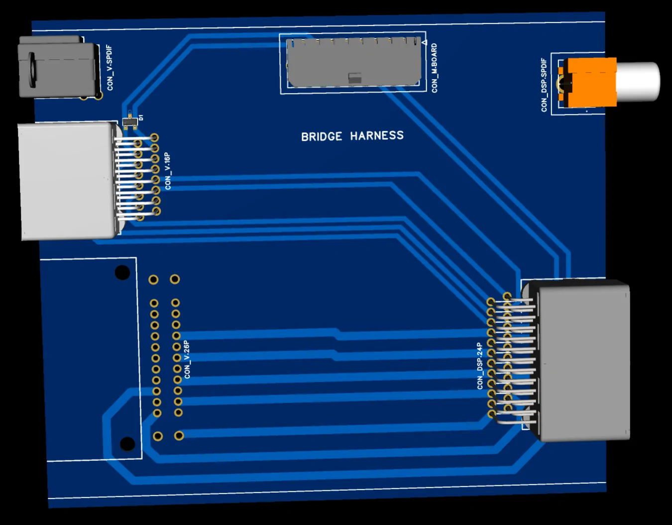

Ok folks, I spent probably 24 full hours this weekend working on an idea I had on Friday night (I couldn't sleep the whole night because of it).
Here's a sort of list of evolutions that have happened, in order, which should hopefully give some context to the progression:
  1. I moved away from using an Arduino microcontroller, to instead building my own microprocessor network. Reasons for this change were: automotive-grade reliability, as the Arduino isn't designed to operate permanently in an automotive environment, which sees wild temperature and humidity ranges that a "home" device isn't designed for. Moving to "bare metal" allowed me to pick high temperature range components all the way down to resistors and capacitors. The second thing I'll be able to do in the name of reliability is to apply a conformal coating to the whole device, which is another automotive manufacturer-grade manufacturing step that prevents corrosion over time, as it creates a hermetic seal over every surface. The final reason to do this is to get back some board real estate, which I knew I was going to need for the next idea I had...
  2. ...which was to bring onboard the entire "T" harness assembly into the device. I won't bore you with the details, and just say this took the most time to do. This strategic change makes the device truly drop-in. On one side of the device you will have the three exact same connectors that your factory amplifier has, arranged in the exact same order and orientation. On the opposite end of the device you'll have the SPDIF output, and a custom harness that I'll supply, which contains all of the cabling to run to your DSP, all in one bundle. Speaker wires, remote turn on, and the volume control all in one neat package. You're just running that one harness and a digital coaxial cable to your DSP amp. That's it.

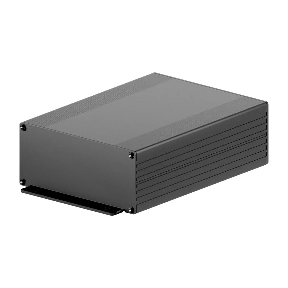

  3. Finally, in order to enable (2) and not have a massive footprint, I realized I needed to split the platform into a motherboard and daughterboard, which would sandwich on top of each other in a clamshell enclosure (see below for a manufacturer photo of the exact enclosure I will use). There will be a simple internal bridge connector between the two boards for them to talk to each other. There's a hidden benefit to this change that might actually be the most powerful of all so far: The motherboard contains all the logic for the volume control while the daughterboard houses all the power, I/O and passthrough signals, and consequently all the vehicle harness connectors too. Why does this matter? Well, I've learned that current gen Honda/Acuras do not all share the same pinouts across models. Even the Civic with Bose is slightly different from my Acura with ELS. So, to add new cars, I only need to develop a new daughterboard, which is much less complex than rearranging the logic circuitry just because the I/O has changed.
The first two models I will build are for the Acura Integra ELS system, and the Civic Bose system. Once those are successfully beta tested by early adopters (ahem), I will purchase the service manuals for all other current Honda products to see what needs to be changed on the daughterboard to support additional models.

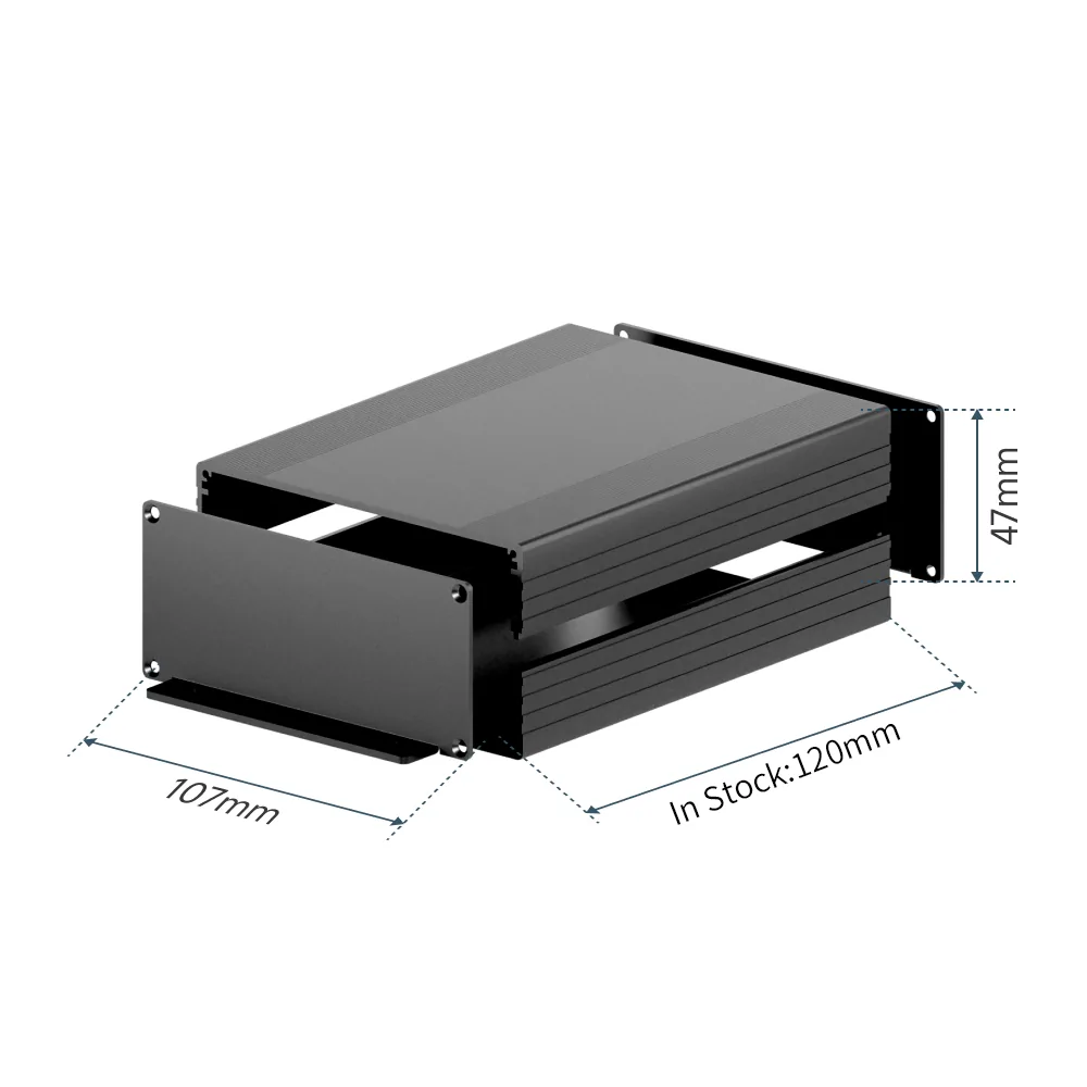

Oh, and by the way, the dimensions of the enclosure are 4" x 4.75" x 1.85", and the end caps have integrated mounting tabs for surface mounting if you like. I anticipate this unit will simply replace the factory amp, which is much larger than this is, so it can probably be secured into place inside the kick panel with zip ties, but the tabs are available to anyone who prefers to fabricate a custom bracket for a pro-level install.

Now for some pics - the enclosure, and the daughterboard. For the daughterboard, one of the OEM amp's connectors is so new that the manufacturer has not yet released a 3D step file for it, so it is missing from the 3D render pasted below. I've emailed them asking if they can send one - we'll see!

It's super interesting.
From experiences of the 10th gen, please check, that the signal delay should be as little as possible as hands free telephone might have a issue.
There is for the 10th gen a similar Metra Kit available, but it's not 100% perfectly usable as somehow you will get a huge delay for the hft system and it echo's too much.

If I were to guess (and I am) that sounds more like an ANC (noise cancellation) issue. On aftermarket systems ANC should be excluded as the DSP doesn't know what to do with the additional signal. My device leaves those pins floating for this reason.
