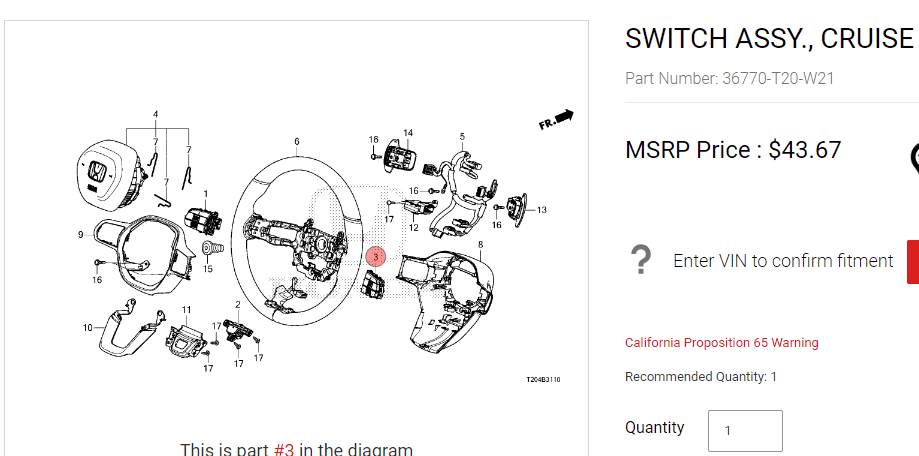

My only thing is both button packs are a different part number from the 22-24 Si so I don't know if you will be able to control the cruise functions with the new cluster.

Then we will need this.
11th Gen Honda Civic Cluster swap 1723752251073-bc
So around $630 or so.

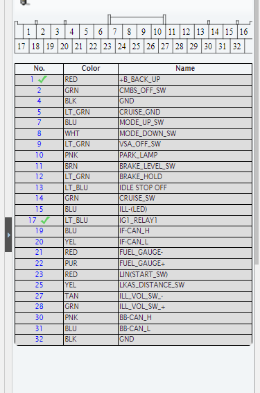

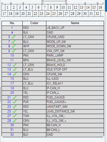

PIN diagram for the 22-24 Si
11th Gen Honda Civic Cluster swap 1724346441889-hc
25 Si
11th Gen Honda Civic Cluster swap 1724346503652-6r
Same size 32 pin connector but the only difference I see is in the number 2 spot on the 22-24 Si is a green wire for the CMBS (Collision Mitigation Braking System) and on the 25 Si harness that spot is empty.
What does this mean? Will it still function just an error code on the cluster? No idea until someone tries it I suppose, just adding more information.

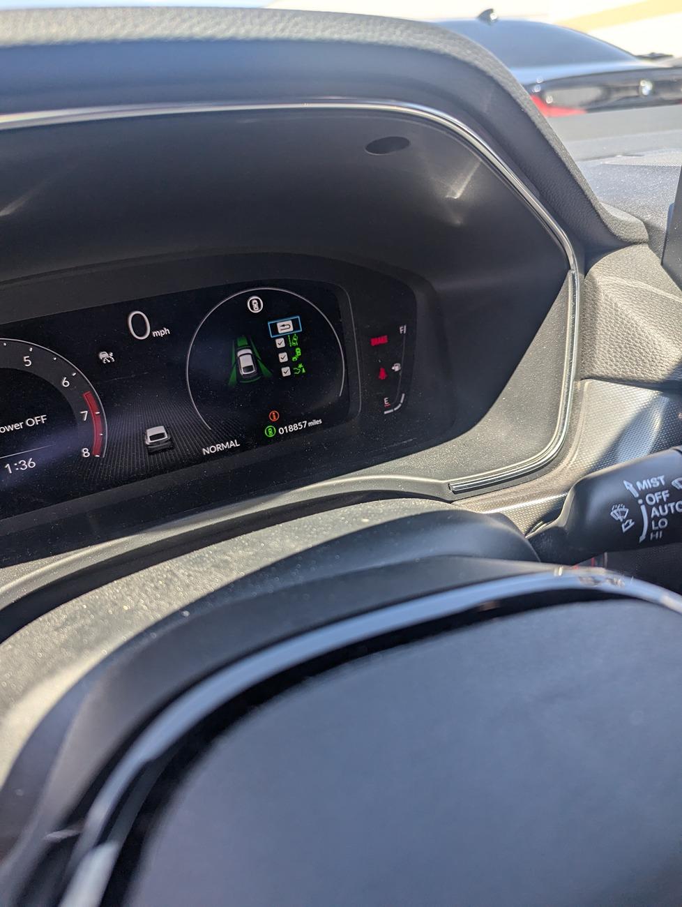

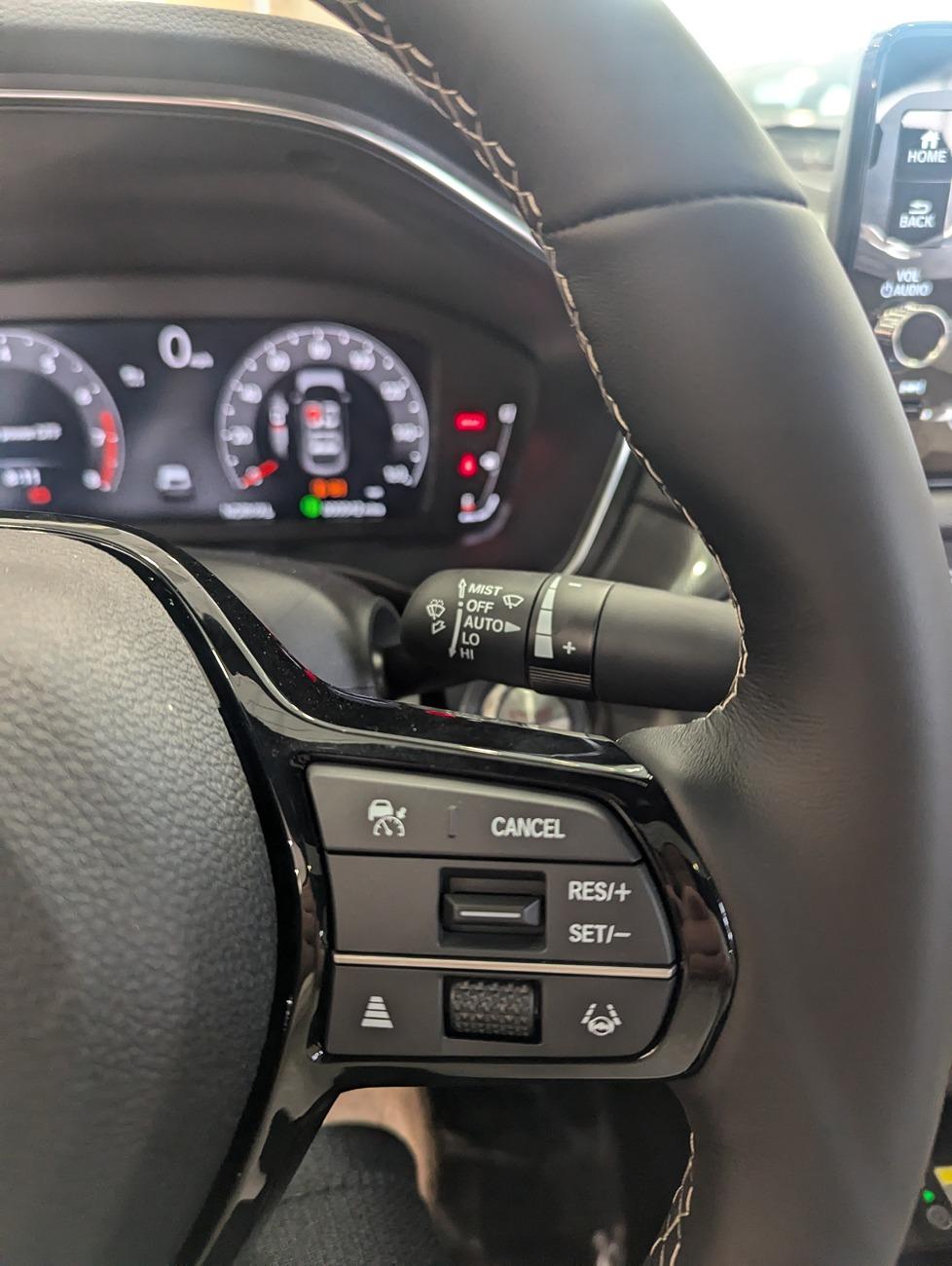

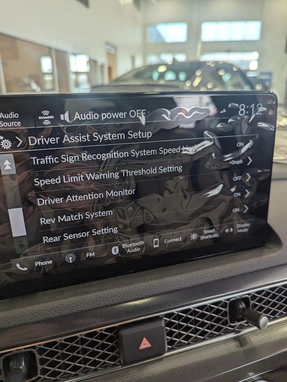

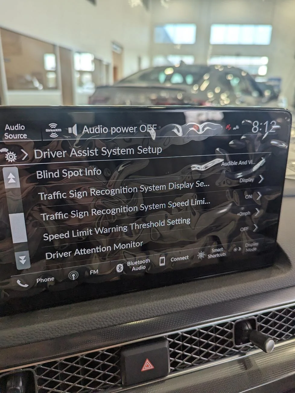

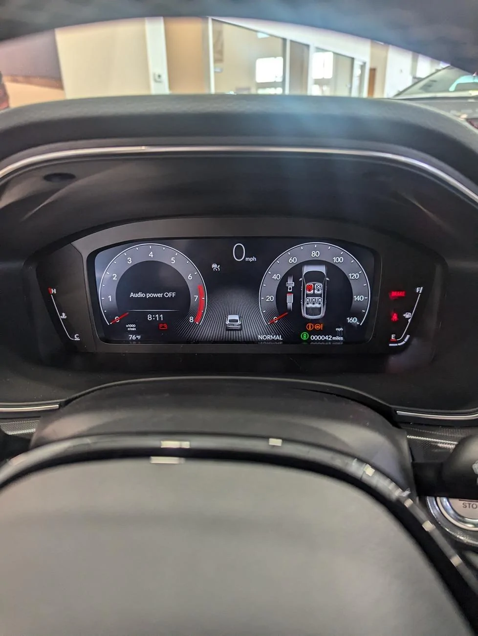

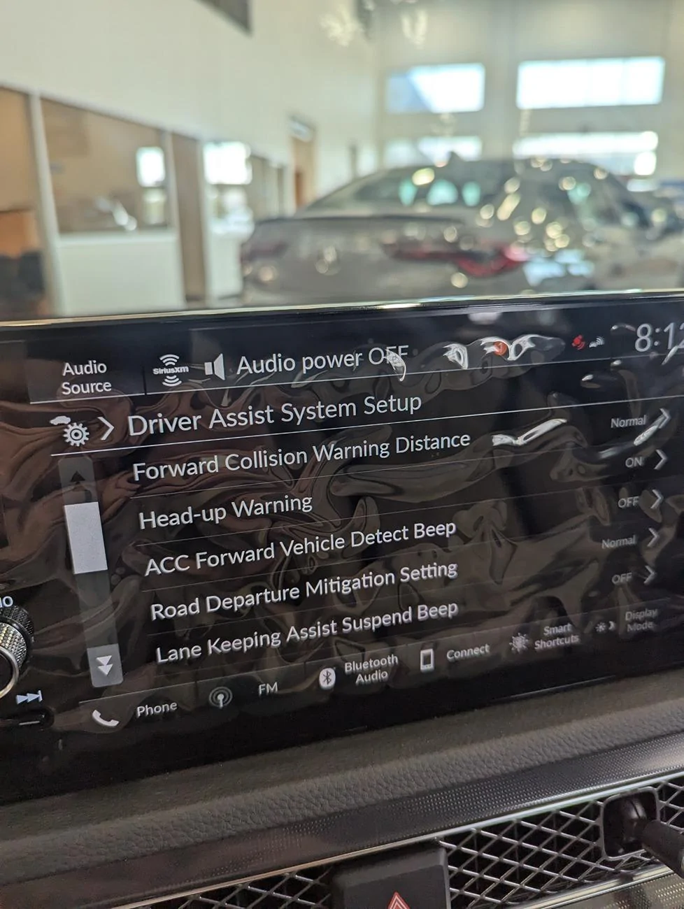

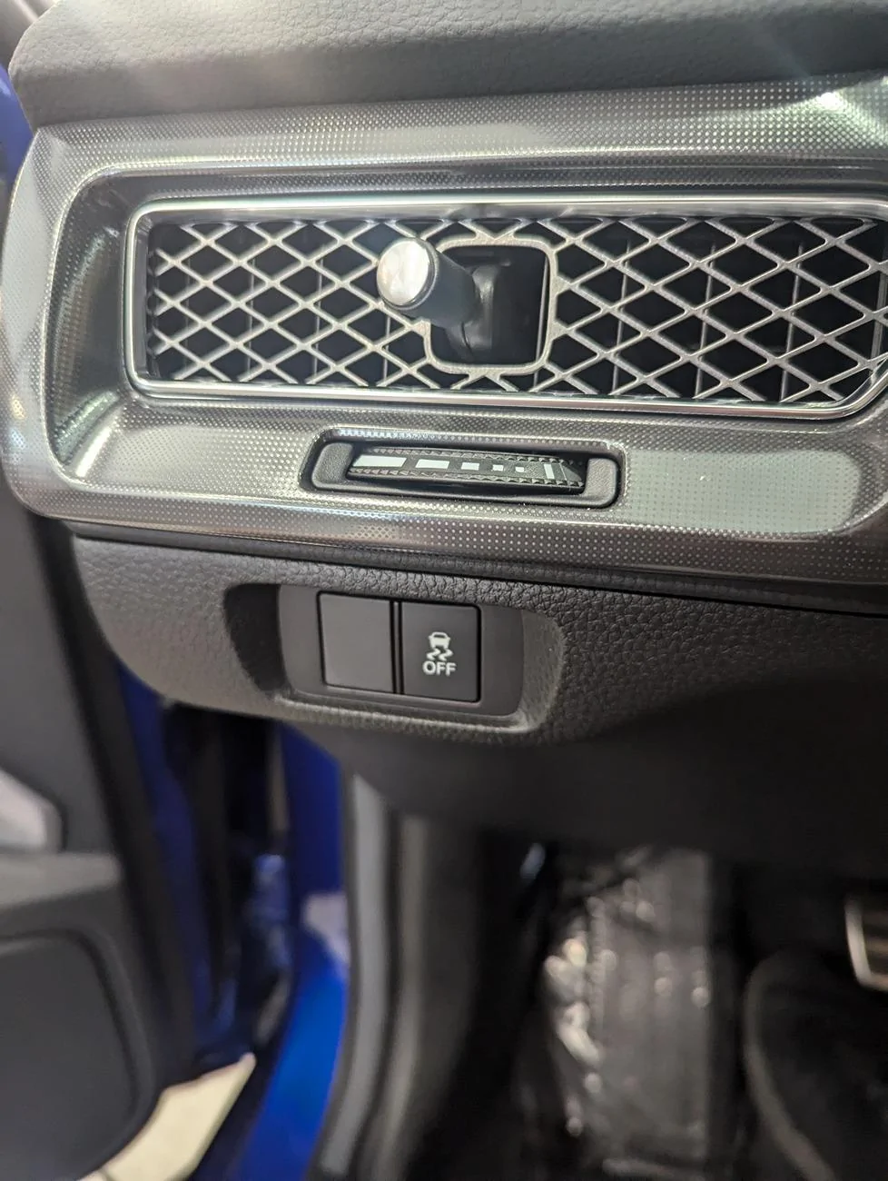

I have to find out where the controls for the Honda Sensing are tomorrow as there is no button on the left side like on our cars.
11th Gen Honda Civic Cluster swap PXL_20240823_001124501
11th Gen Honda Civic Cluster swap PXL_20240823_001130850
11th Gen Honda Civic Cluster swap PXL_20240823_001228896
11th Gen Honda Civic Cluster swap PXL_20240823_001128798
11th Gen Honda Civic Cluster swap PXL_20240823_001127204
11th Gen Honda Civic Cluster swap PXL_20240823_001221635
11th Gen Honda Civic Cluster swap PXL_20240823_001225552
ayospoonay
Josh
Oct 7, 2019
177
153
Orlando
2022 PWP Si
It’s not looking good…
Shankmeyster
Shankmeyster
Mar 15, 2017
53
2,257
570
AZ
23 Type R

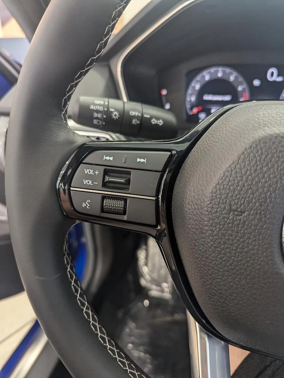

Turns out the whole of Honda Sensing is controlled through the scroll wheel on the left side control. We don't have that on the Si so you were right we need both the left and right and the harness for it. All the controls you don't get on the left one are on the right side of the digital cluster. We don't see that because the cluster is half analogue. With the full digital the left side is for audio controls and stuff like that and the right side is for vehicle controls.

Sorry I meant to type right side controls on the steering wheel. There is a scroll wheel on the right side now that controls the right side of the cluster.
