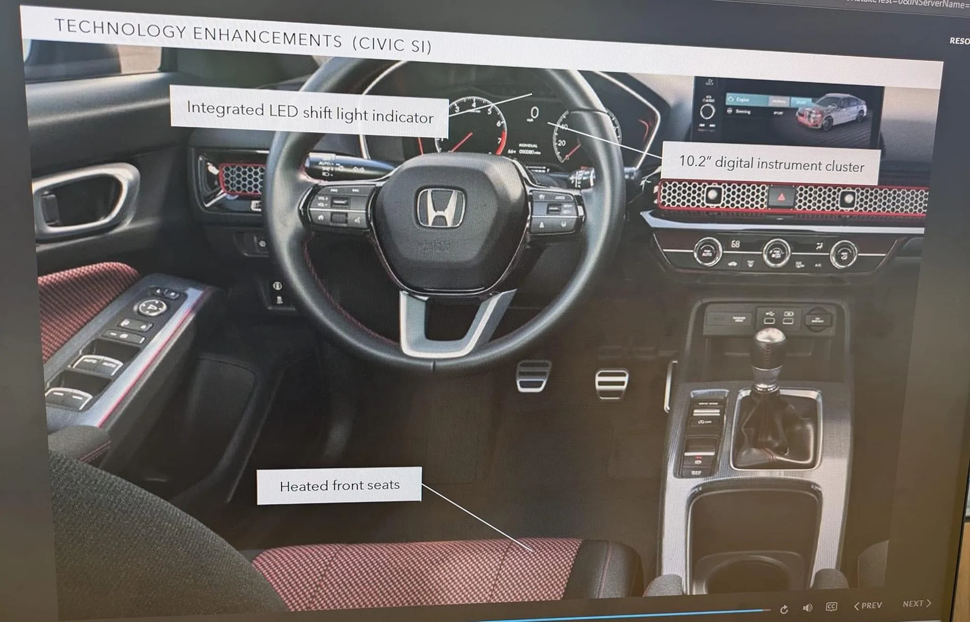

I still don't understand why they would get rid of the temp gauge. That thing is kind of important in all cars.
ivancook
Ivan
Jun 30, 2024
2024 Civic Si
I plan on ordering one as soon as it comes available. Only "issue" I see from the leaked photos is still no temp gauge.
Part number for the 2025 Si cluster is - 78100-T38-A02
As of now the release date for it is August 5th.
Where are these leaked photos?

11th Gen Honda Civic Cluster swap 1721746256275-gs
11th Gen Honda Civic Cluster swap 1721746286633-ly
Looks like a temperature gauge is confirmed!

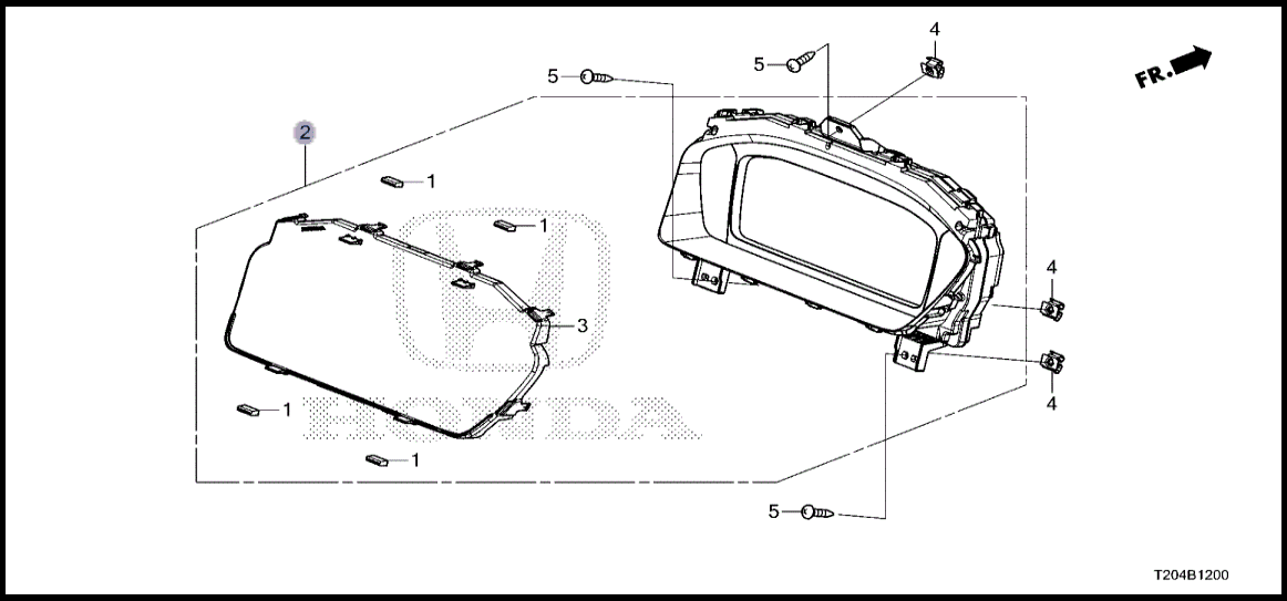

What did you remove to get to this area? I just ordered the cluster lens for the 2024. I will probably pay someone to do the job (auto places) that install and do work like this, as I do not want to risk damaging anything. Or even an auto body. For now, I am dealing with the small scratches, but I know years from now, the lens will have to be replaced. There are a few other threads on this.

Luckily the lens is like $10
