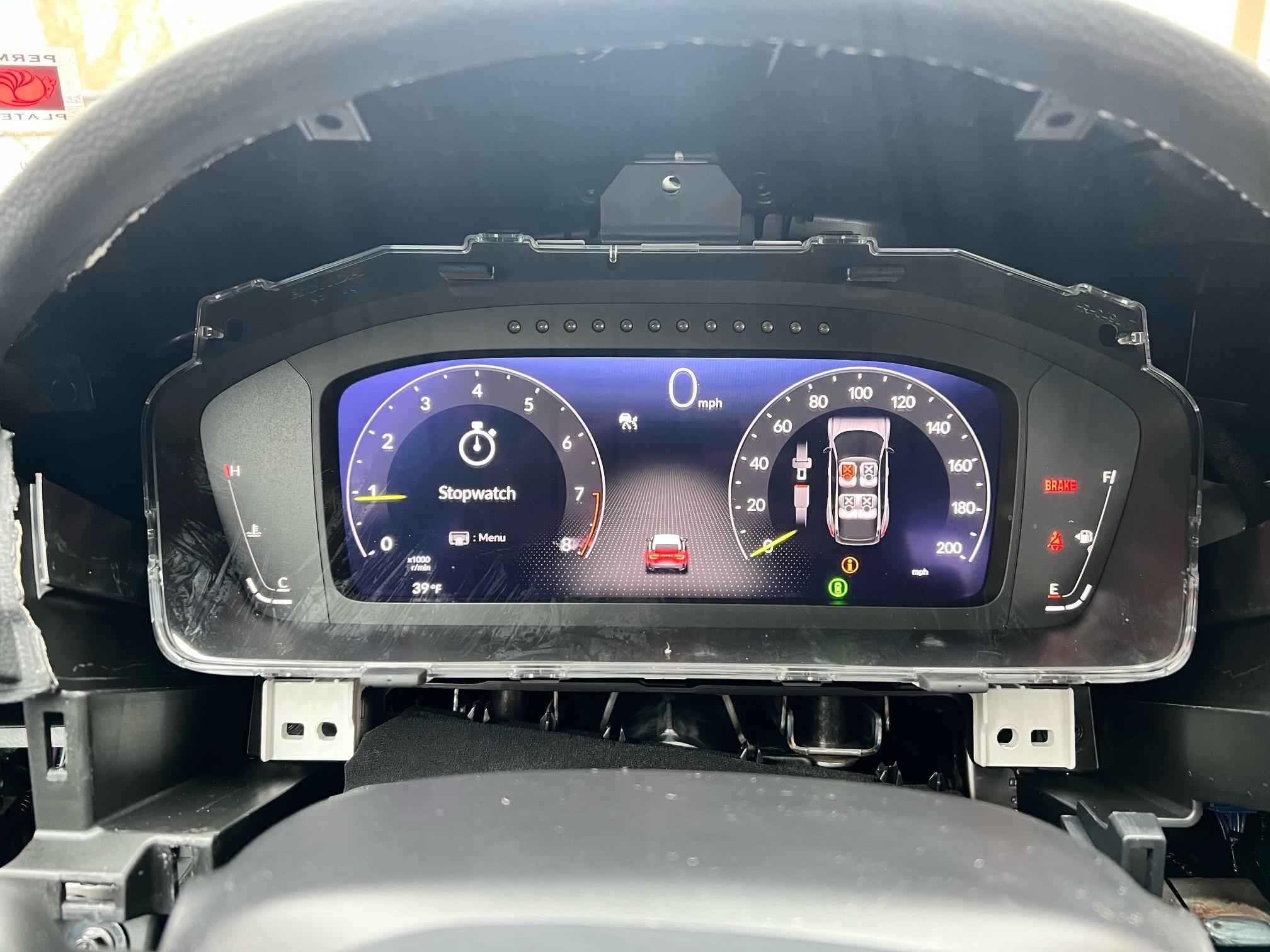

Now who wants to be the guinea pig to swap either a Canadian Si cluster or the new Integra cluster into a US Civic to get the full readouts and full digital? Just looked at one of the new Integra clusters to see what the difference really is and look at this. I just wonder if it's a plug and play like the old ones. I don't have a pic of a manual one yet, but I'll see if there is one around.

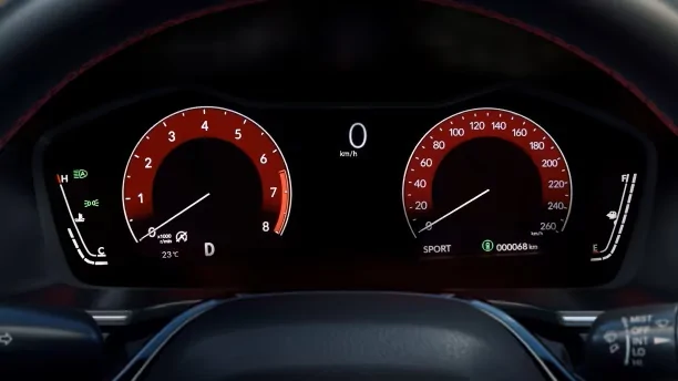

And here's the Canadian Si cluster. I think the bezel and mounting is different between the US Si and all the others.

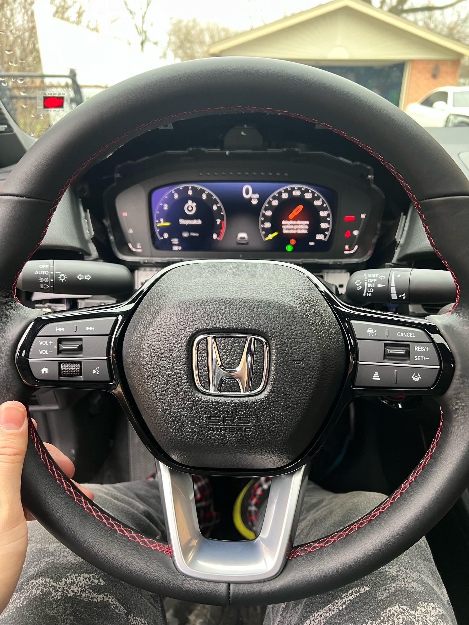

It has been bugging to know if a FL5 cluster works in a SI. I have a 2024, and I just plugged it in. Sadly, the damper message appears. I also cannot control the cluster because the steering wheel switches are different. I just purchased on Ebay a type-r wheel with the switches so that will be in by the end of week. Would be nice to be able to control the cluster.
