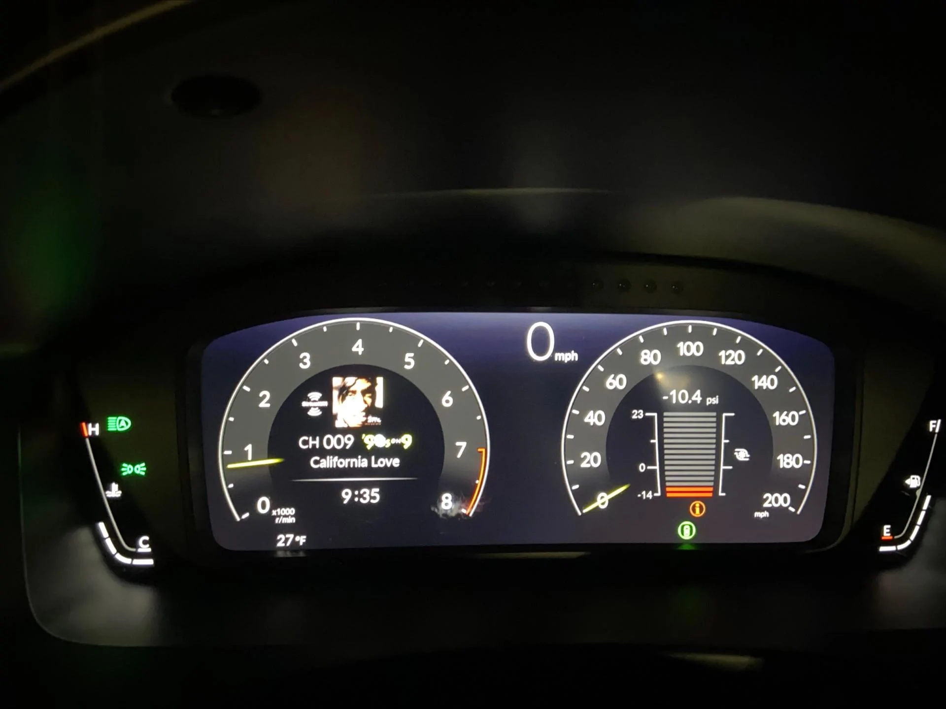

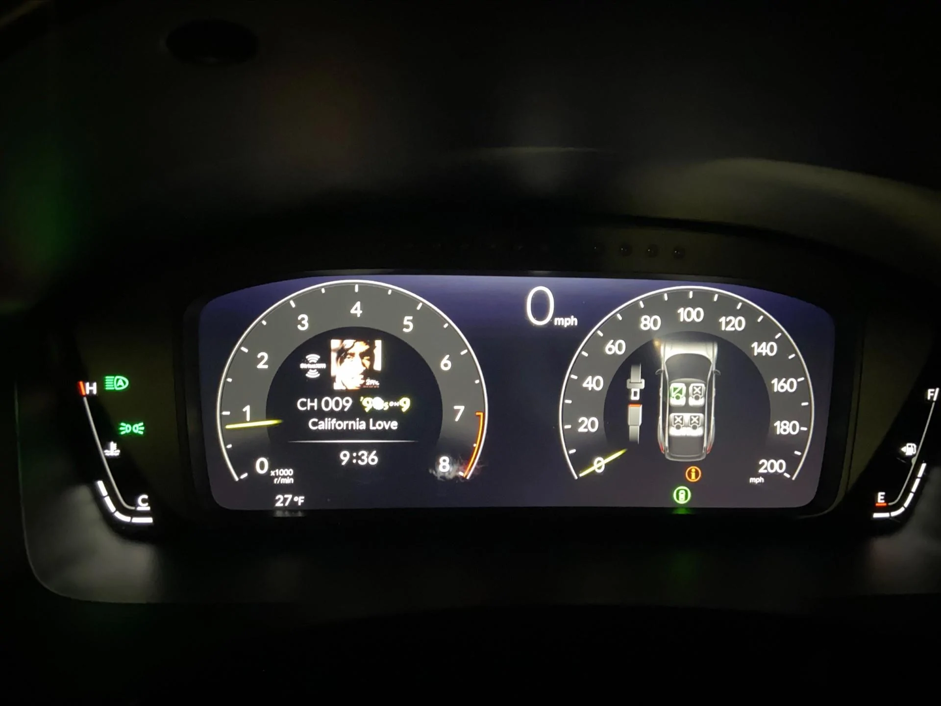

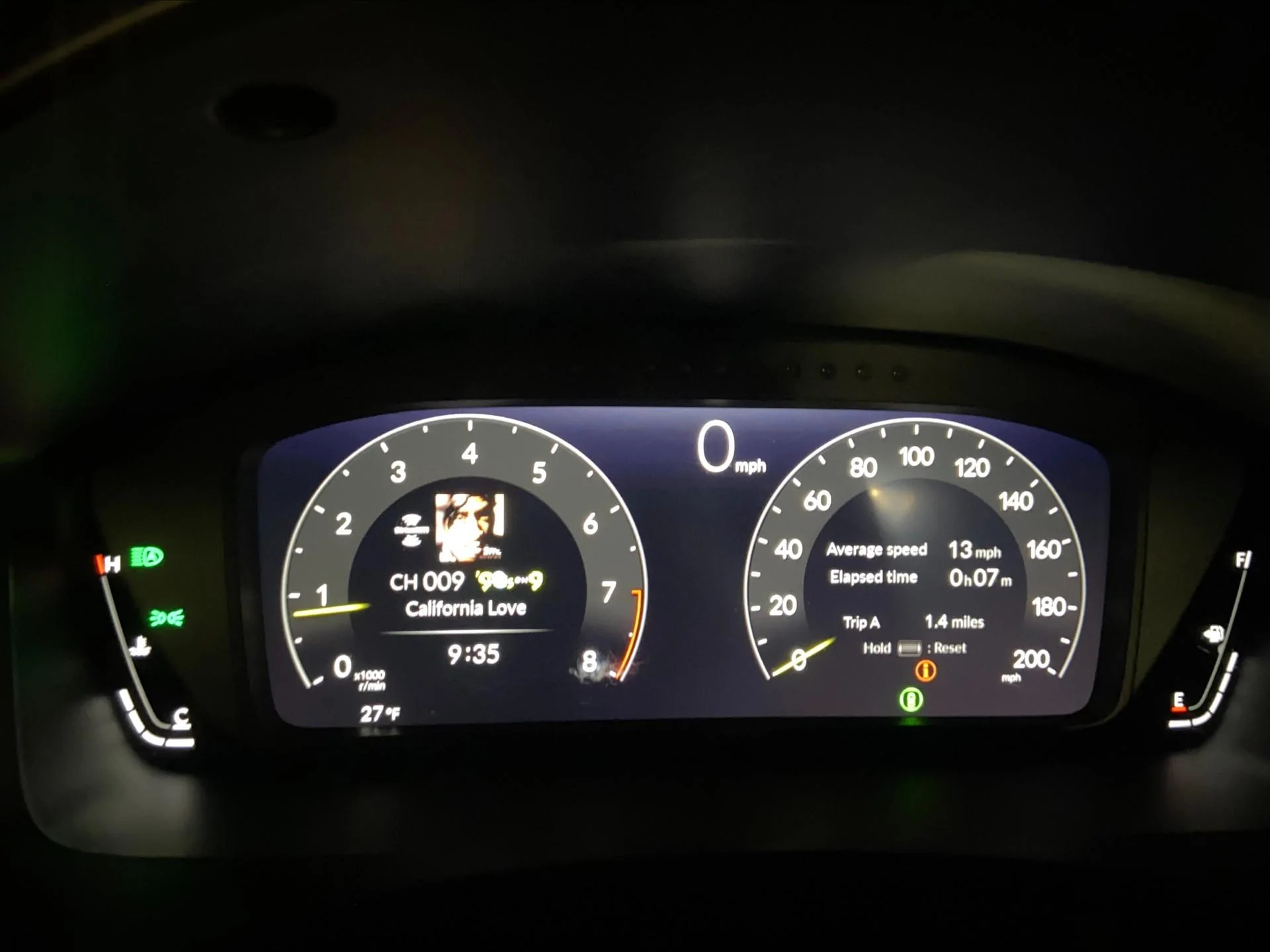

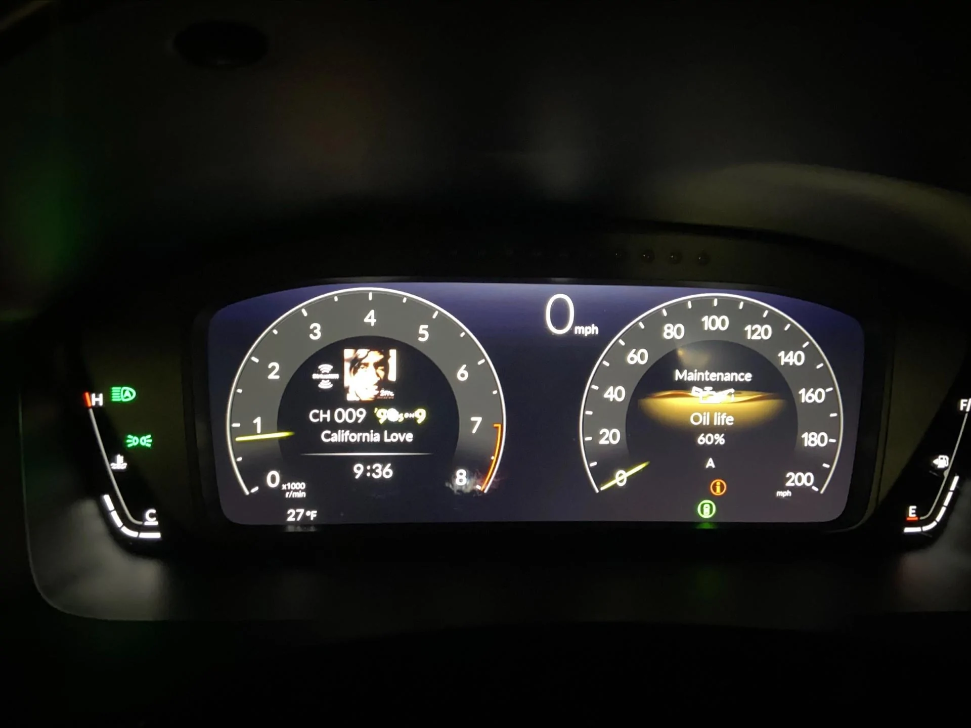

Hi everyone - wanted to update the group! Happy Saturday as well, I know it is not as cold here in Michigan as it once was.
So, as you know this thread is about adding the FL5 cluster into the '2024 Si I have some statics to help put if this is a route you want to go.
My used Type-R steering wheel came in. I tested it quick so I could use the wheel controls and found out the cluster now has 100% controllability! I since the wheel was slightly more warn I used my Si wheel. This is how I got it to all work.
1.) You have to use the small wiring harness from the type are wheel and controls and swap them over to the SI steering wheel.
2.) Mileage stays with the cluster not the ECU
3.) I ordered the center switch bank with the "R-mode" button, I am hoping this allows the cluster to go into the race-dash mode. It will take a few weeks to get it.
I am SO very happy with this cluster. I love a full digital cluster as it really cleans up the area. The yellow digital needles are a nice touch too. If the R-Mode" works after swapping the switch bank, that will complete my journey on the up swing.
I took photo's of all the screen options we in the USA don't have on our SI's.
Please do remember that the explanation point circled in orange will be on the cluster as we do not have the ADS system on our cars. Not sure if that will ever be able to be turned off.
Thanks for following : )
