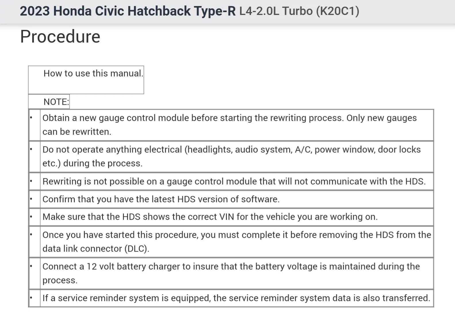

That is something I do not know. Right now I can't even tell mileage on the Type-R cluster as I do not have controls for the steering wheel. I just went on eBay though to buy a used type-r wheel with controls. So we will see. I could always plug the US spec in then go drive 5 miles and let you know where the mileage stays.
Mileage is stored on cluster. Page from Honda's procedure for installing new gauge clusters and rewriting odo mileage:
11th Gen Honda Civic Cluster swap Screenshot_20240130_104223_Chrom
That is very beneficial thanks for noting this! I was just going to test it, but now I do not have to!
