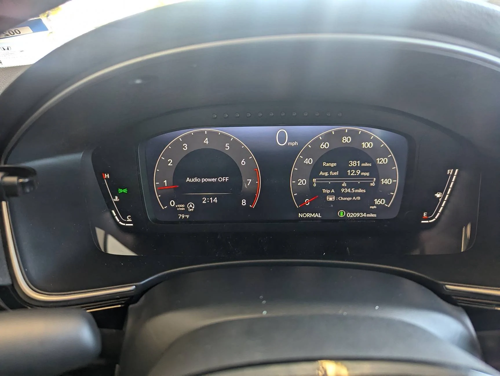

It's going to be happening in a Honda shop so might be hard to do that. Happening tomorrow though so we shall see.
Shankmeyster
Shankmeyster
Mar 15, 2017
53
2,254
565
AZ
23 Type R
Had to be programmed by Honda but everything functions as it should. Mileage is correct. Also they said once you swap you can't go back. The original cluster gets deleted and locked out or something. You'd have to get a fresh OEM cluster to switch back.

EVERYTHING WORKS! ??? I'll post video of going through the controls when I'm home later. You need all 4 parts from my post. Had to be programmed and installed at Honda to avoid mileage discrepancy but it's all good and you get new features. ?
