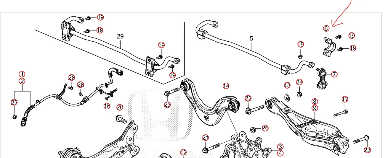

Does the Civic Si share the same rear sway bar brackets as the Civic sedans?

Does the Civic Si share the same rear sway bar brackets as the Civic sedans? I've been looking at parts sites and I'm looking for the exact part number of the Civic Si rear sway bar brackets. For some reason, DreamShop and Honda Parts Now don't include it. I looked under my Si and the brackets look identical, but I'd like a confirmation.
If anyone has any more detailed diagrams and could help out, that would be great!
2024 Civic Touring Sedan brackets:
P/N 52308-TBA-A10

It maybe not listed on the SI because the bushing is bonded to the bar and they do not come separate. But from what i can tell, the bracket itself is the same, granted that the bushing is appropriate for the size of the bar. I would just upgrade the swaybar to RV6 if I can because it is cheap and come with billet bracket.

Yes. I put an Si rear sway bar onto my 2022 ST and reused the brackets and endlinks which were perfect fit. The bushings are bonded to the bar so those cant be bought separate.
