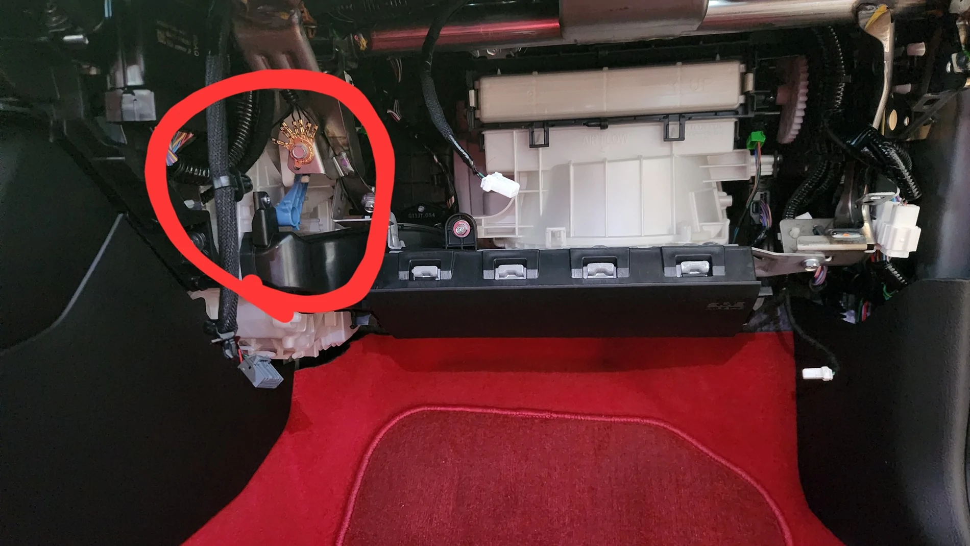

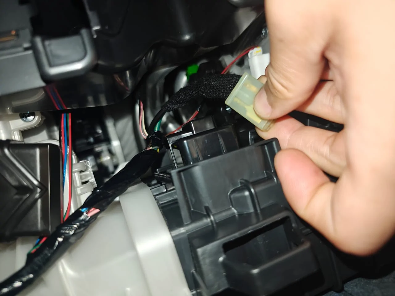

This glovebox rattle has been driving me nuts for a while and I finally took the time to resolve it.
When the car vibrates, this wire was hitting a plastic piece causing my insane rattle. To resolve it, I wrapped part of the wire with a small strip of velcro. Then on the plastic part, I placed a small round velcro piece. That way it would hold steady.
My test drive confirmed the fix and I hope it helps others.

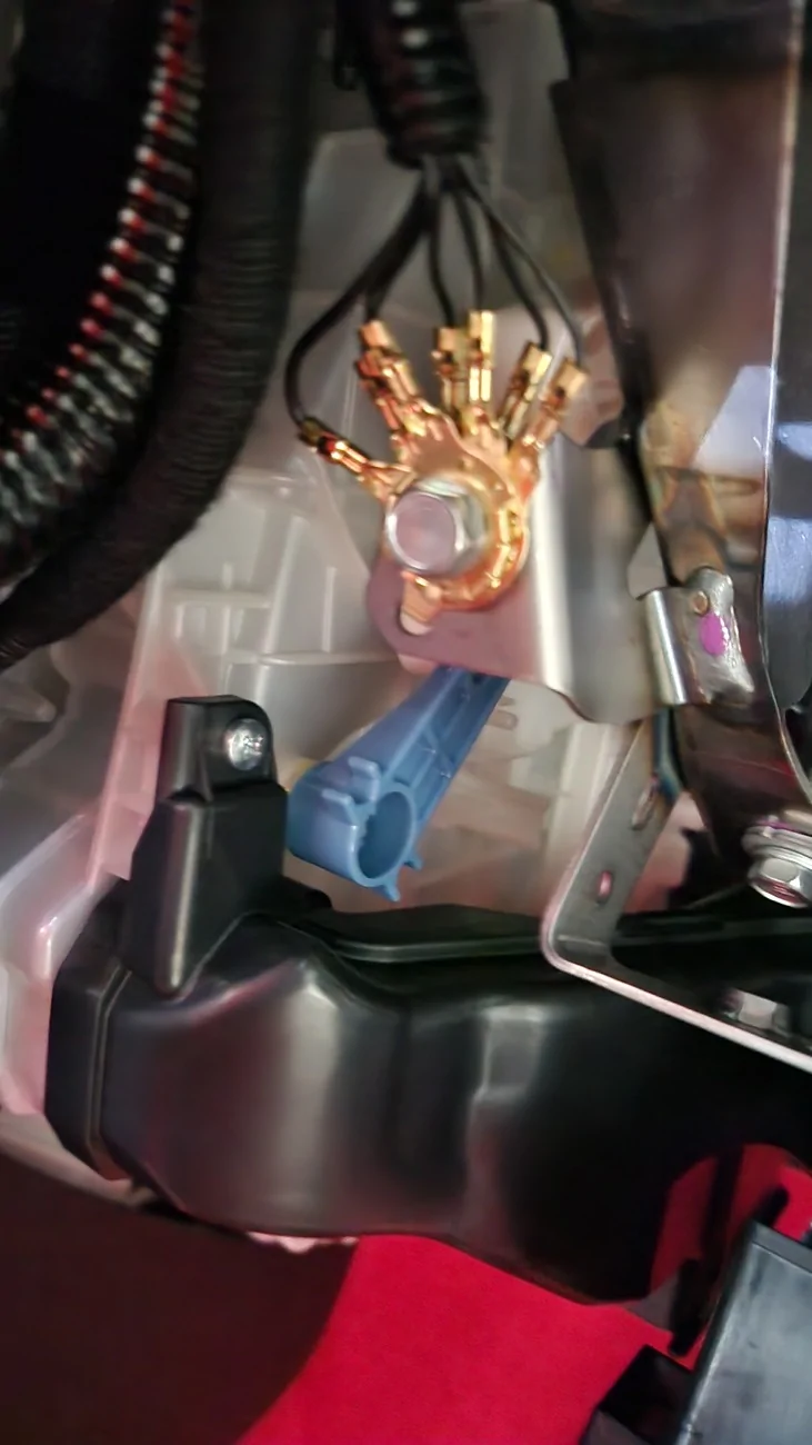

I noticed that this blue thingy also wiggles a bit and makes noises. Does anyone know what is that?
No idea. But let me know if you solve your rattle! From 4 miles is brutal.

That's an HVAC duct flap for redirecting air between two paths (ie feet vs face).
Ohhhh that makes sense. I was wonder what could possibly be there. Thanks!

I wrapped that wire. Noise seems to be reduced. Still happen from time to time. I also put a lot of soft CCF at various panel gaps/contact points. So not sure what was the main source of the squeak.

anyone have instructions on how to remove the panels around the glove box? i got the glovebox removed, but not sure how to proceed next.
