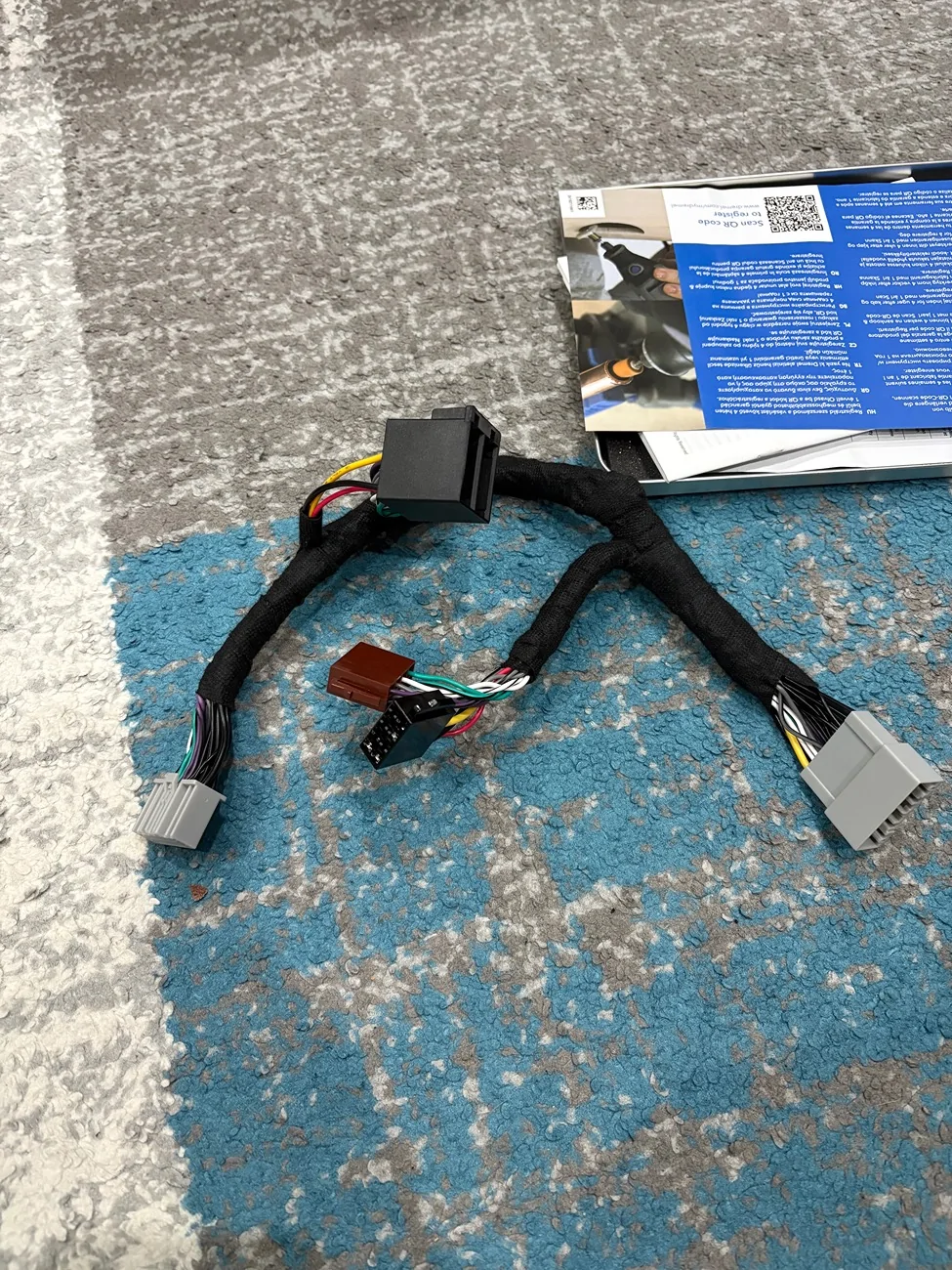

11th Gen Honda Civic FL5 Base Audio Upgrade IMG_0671
^This is what was supplied with the kit btw, thought I’d show this for anyone curious

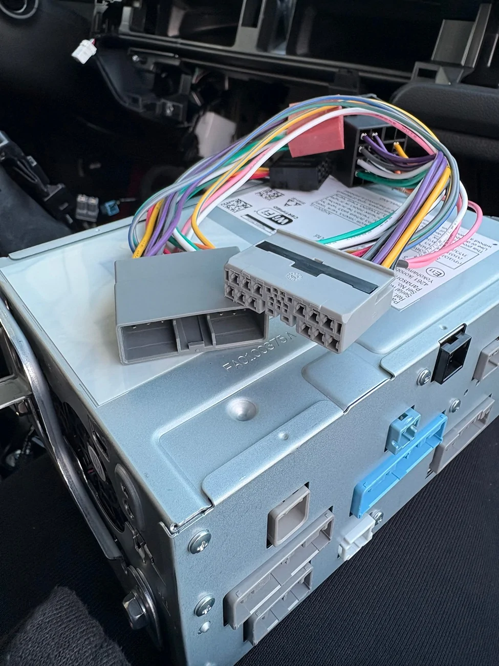

11th Gen Honda Civic FL5 Base Audio Upgrade IMG_0699
mix of the wrong adapter and the one I bought with the right plugs since it didnt have the male side for the power or the female power side, illumination wire wasnt needed, which is obvious

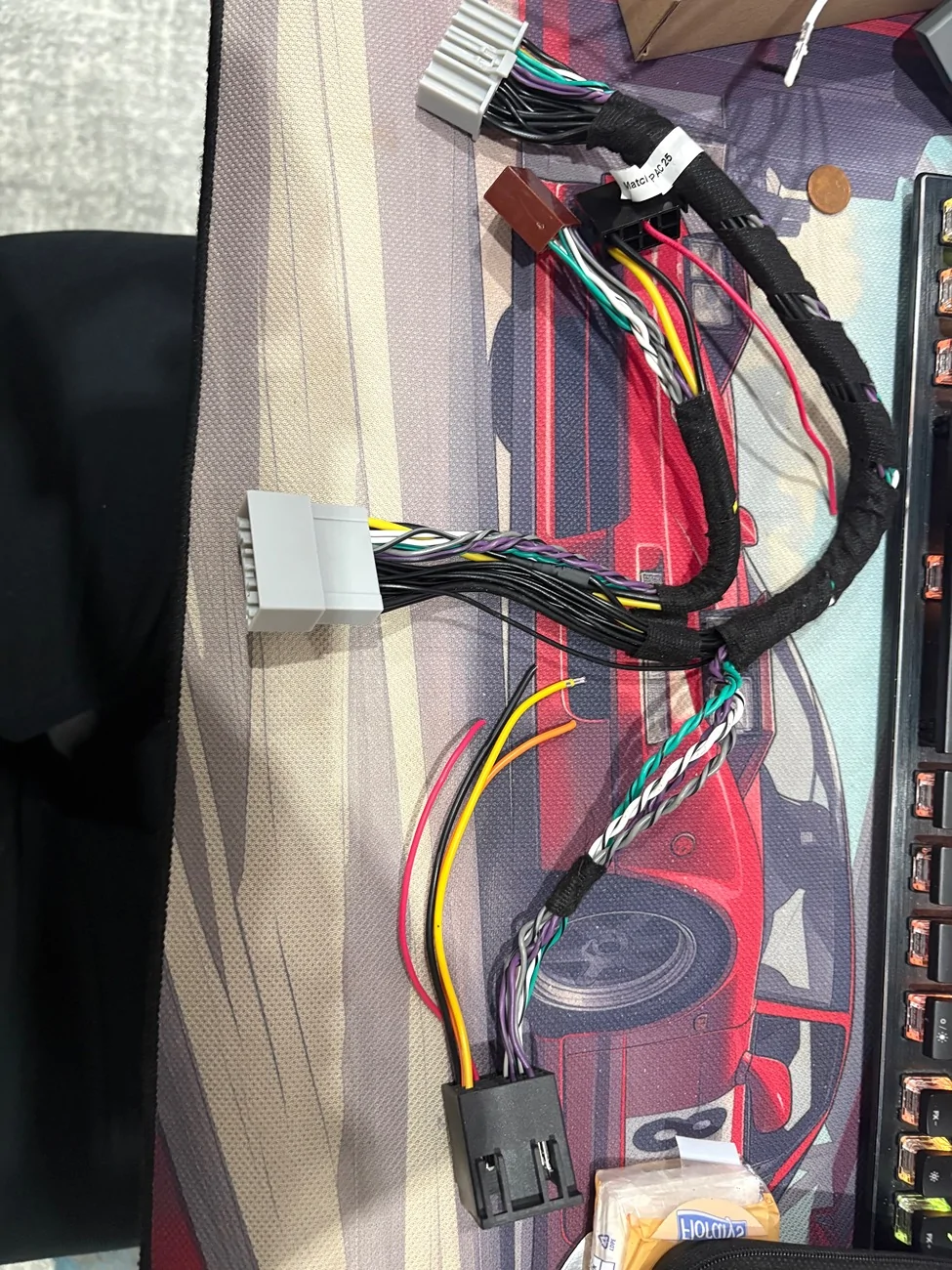

11th Gen Honda Civic FL5 Base Audio Upgrade IMG_0704
finished product of the two :)

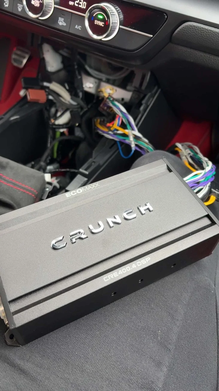

11th Gen Honda Civic FL5 Base Audio Upgrade IMG_0721
crunch dsp plug and play wired :)
Thought i’d share these pictures, will share the pinout if anyone wants to rebuild this harness
