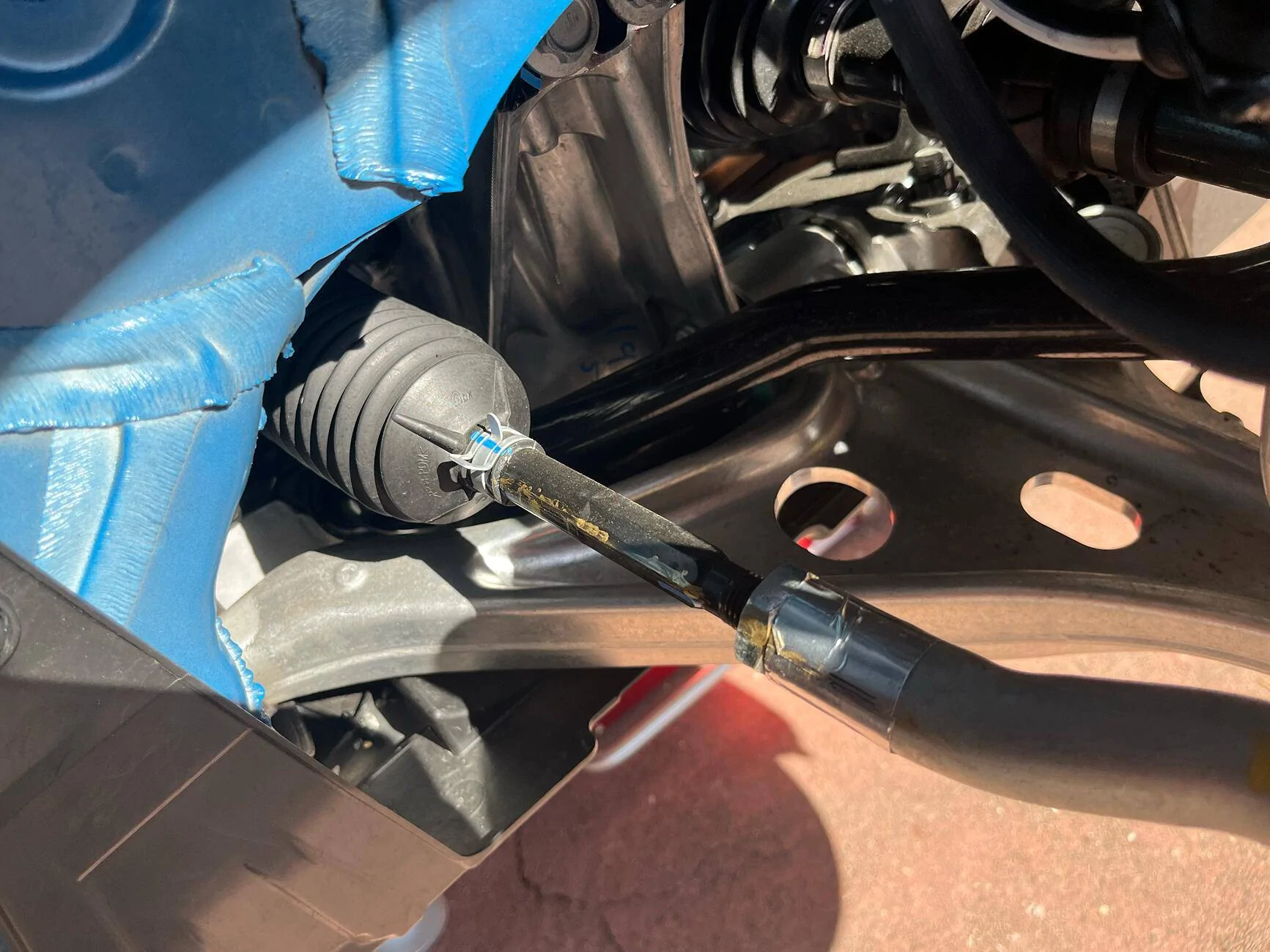

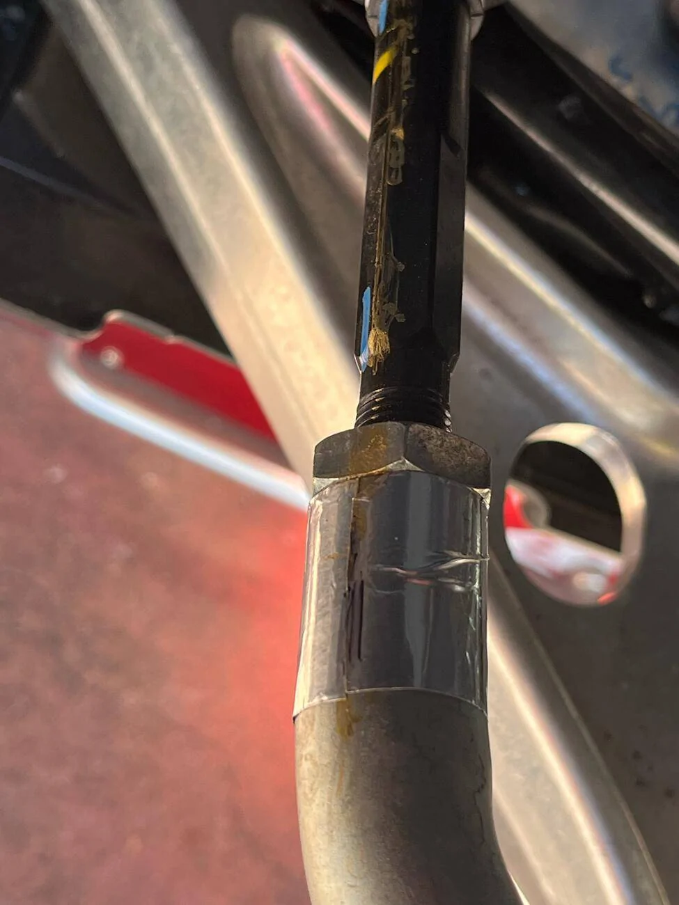

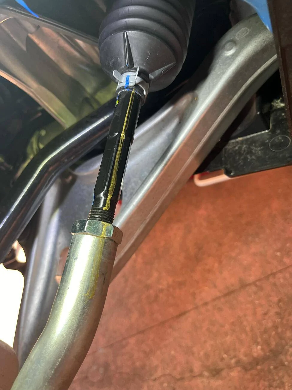

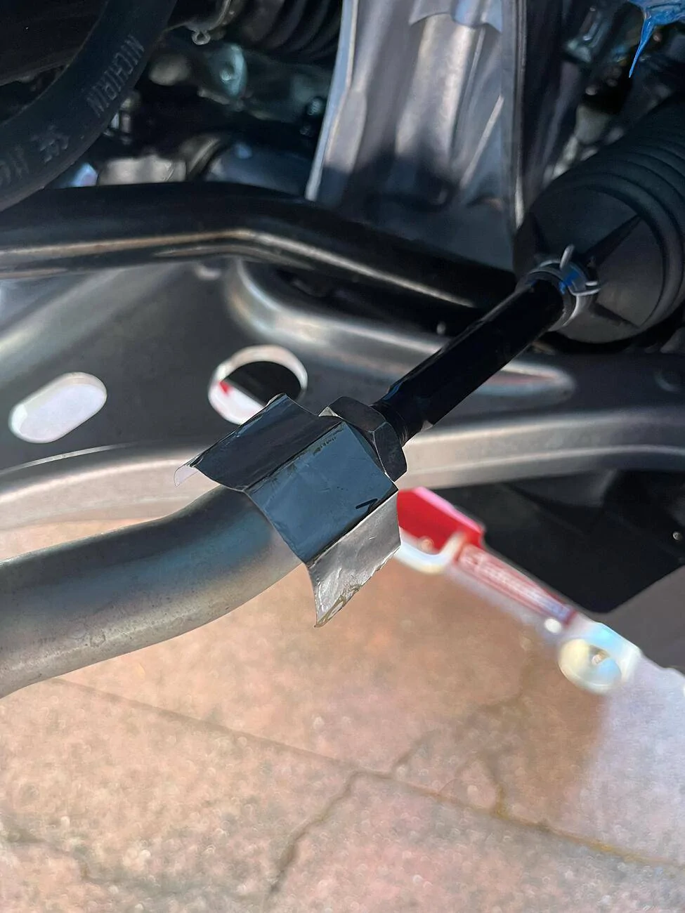

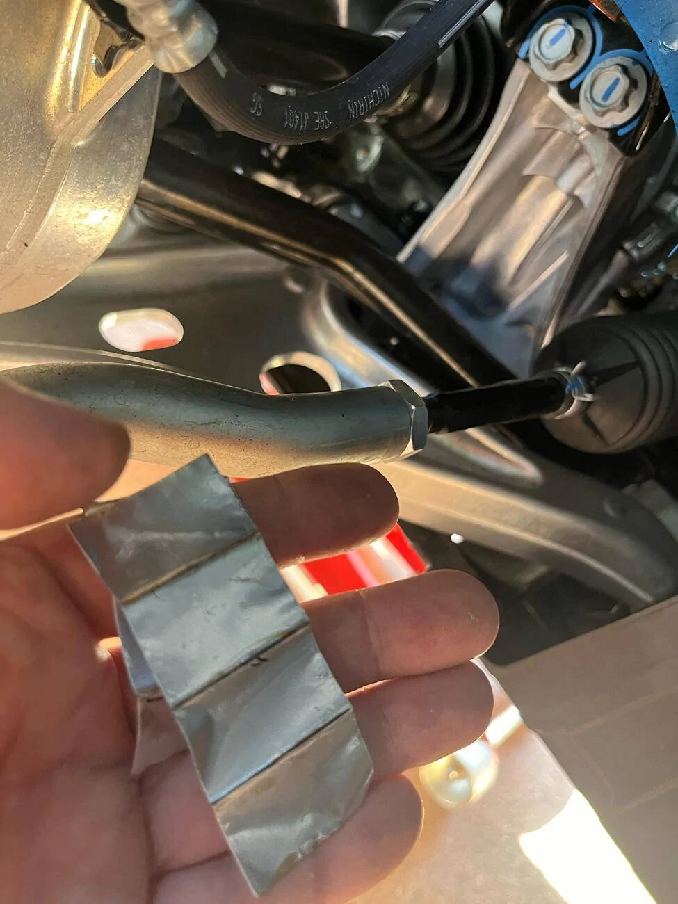

I taped quarter - increments. I believe I'm close to zero and will also try another quarter turn for slight toe out.
Have you noticed much better performance with zero toe vs toe out?
11th Gen Honda Civic FL5 Front Camber (Strut Pin Removal) tempImage3ltNfO
11th Gen Honda Civic FL5 Front Camber (Strut Pin Removal) tempImageQaXZ2s
11th Gen Honda Civic FL5 Front Camber (Strut Pin Removal) tempImageZOmGoM
11th Gen Honda Civic FL5 Front Camber (Strut Pin Removal) tempImagemTOcgz
11th Gen Honda Civic FL5 Front Camber (Strut Pin Removal) tempImageoE7ziQ

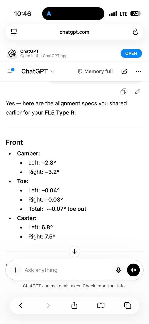

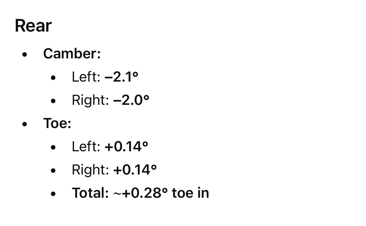

Can you post the alignment spec.

This is my alignment with me driver sitting - so that's why you'll see camber a bit different on drivers side - I was running on stock 265/30/19 rims and tires, and now I've simply put bigger tires PZERO CORSAs 275/35/19
11th Gen Honda Civic FL5 Front Camber (Strut Pin Removal) 1789600304436-q2
11th Gen Honda Civic FL5 Front Camber (Strut Pin Removal) 1789600321703-5l
