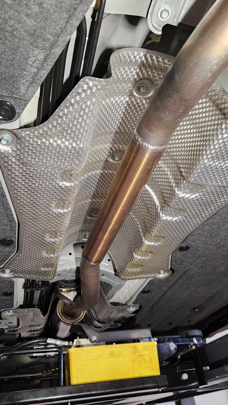

  • I don't have a picture of my own car, but I'm attaching a photo of another user's res delete. My setup the same. Is this a "front resonator delete" or "mid resonator delete"? Seems like an obvious question, but I swear I read / heard that this is a front resonator delete.

Yes, I was looking to get that midpipe. Do you have any experience with it? How would it sound with the mid resonator already gone?
If you do this (MRT front resonator delete), already having the mid resonator removed, it will be louder than what it is right now and may not be what you are looking for.
Best bet, outside of replacing the exhaust, would be to install a vibrant resonator at that location where they removed the OEM resonator already to ease the exhaust tone and go from there.
Circled in red is the front resonator (MRT delete here).
Circled in blue is the mid resonator (already removed on your Type R).

As others have said, you don't want the MRT piece, that is just taking out another resonator whereas it sounds like you want to add back a resonator. I'm honestly surprised it made that much of a difference. I did the MRT piece, removing the smaller resonator, and the difference is SUBTLE. Did they make any changes to the muffler? Removing resonators or maybe changing out the resonated exhaust tips?
That would be my guess as well (maybe the rear muffler is also deleted?). I have my mid resonator deleted, just like OP and it's not that loud. As a side note, if the rear muffler hasn't been mess with and the valve is still intact, then check to see if the fuse for the valve is pulled. If it is, put it back and set engine to comfort which will make it sound almost (90%) stock!

^ sound in comfort is barely discernable from stock. Remove both in comfort it becomes audible but not by much. Leave it alone and put it in comfort.

It turns out, the previous owner also did the fuse pull trick to keep the valve open all the time. I haven't checked on the removal of the muffler yet.
Thanks for the advice, I will not be going for the MRT piece. I may end up just keeping it as is, or as
LogicalCC said, installing the vibrant resonator.
