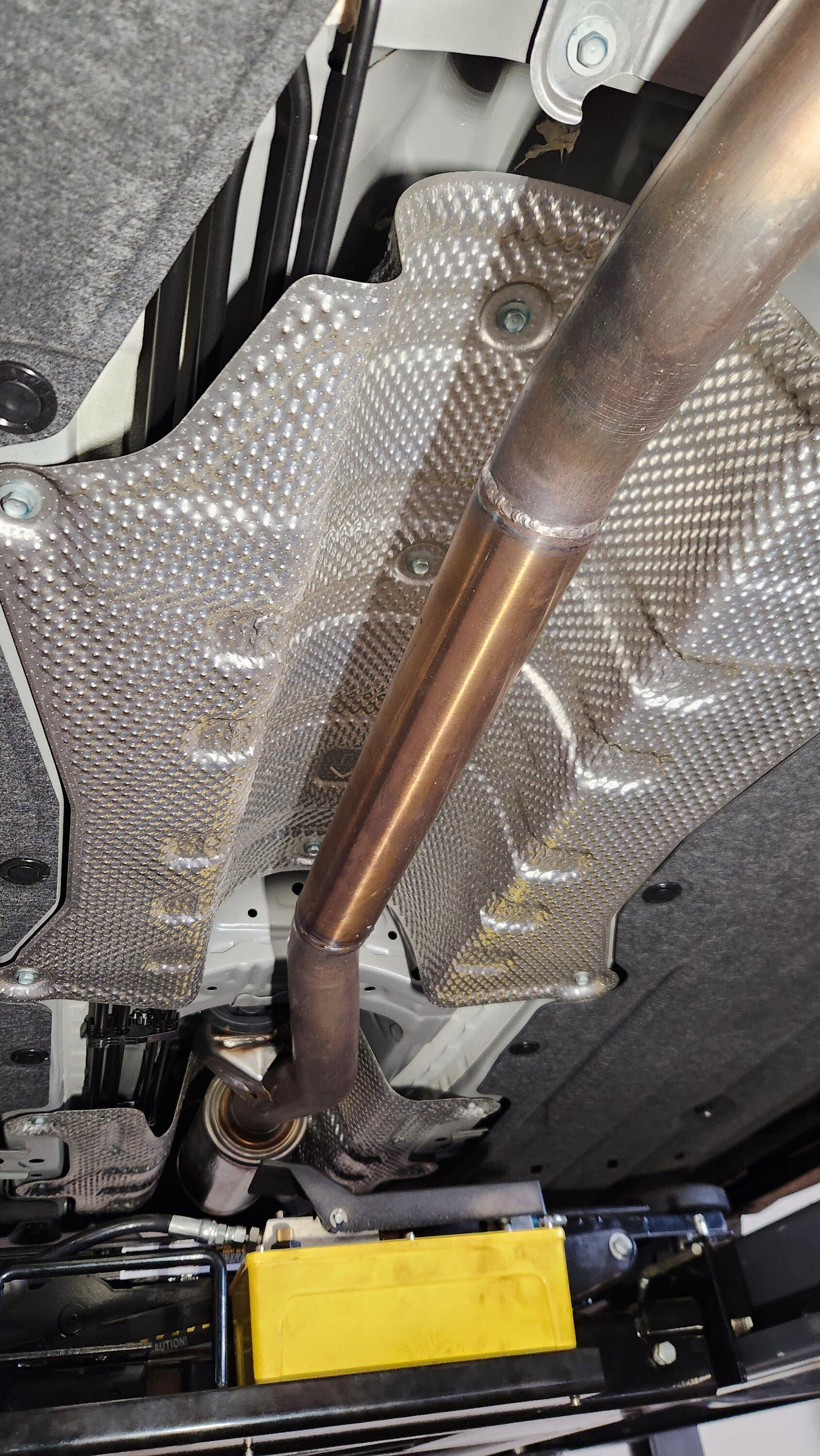

I've deleted the main resonator and TIG'd up a 2.5" 304SS pipe in place. I left the front resonator in situ. Very happy with the results. Small weight saving too.
No pops or bangs but it does reveal a nice burble from the outside between shifts.
I imagine deleting both would be quite droney though...
