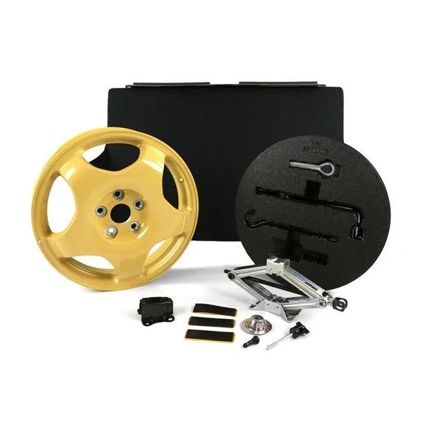

We do not have a specific spare wheel kit for the FL5 listed, although we have had it confirmed that the FK8 spare wheel kit will work and fit iin the trunk.
Please see the product listing here Genuine-honda-replacement-space-saver-spare-wheel-kit
11th Gen Honda Civic FL5 Spare Tire ? s-l1600_5_1200x630
Genuine Honda Replacement Space Saver Spare Wheel Kit | Honda Civic Type R | FK8 2.0T K20C1 | 2017+
DESCRIPTION Genuine Honda Replacement Space Saver Spare Wheel Kit HONDA Replacement Space Saver Spare Wheel Kit. This is a multiple-piece kit, comprising of everything you see in the product images. This is a comprehensive kit, used to replace everything regarding the spare wheel & space saver tyre as well as boo

It should also be noted that fitting the kit into the FL5 cargo area, as previously well documented by Dallman, will raise the lid/floor several inches, which will need to be taken into consideration vs. storing in a tire bag and placing elsewhere in the vehicle. The Parts Dept. at a local dealership thinks a FL5 specific spare tire kit may be in development, but could offer nothing to verify it. Given an increasing number of punctures, flats, etc. coupled with the messy and limited life (i.e., , sealant expiration) of the supplied inflator, it seems like a needed accessory for the FL5. Finally, I contacted Honda USA in regards to a solution and was assigned a "case", but haven't received a reply as yet.

That is a very high price and doesn't include the tire. I think you can get the same kit from another source for a lot less.
I searched for "Honda 06421-TGH-A33ZATemporary Kit" and found at least one hit for under $200 that claimed to fit the 2021 FK8.
Earlier in this thread is a pic of the FL5-specific kit in a prototype CTR. I'm waiting for that and will carry a full size spare plus tools in the interim.

The FK8 kit raises the floor ~1in more than needed. You can clearly see that in the foam that sits inside the wheel. The FL5 kit is not that bad.

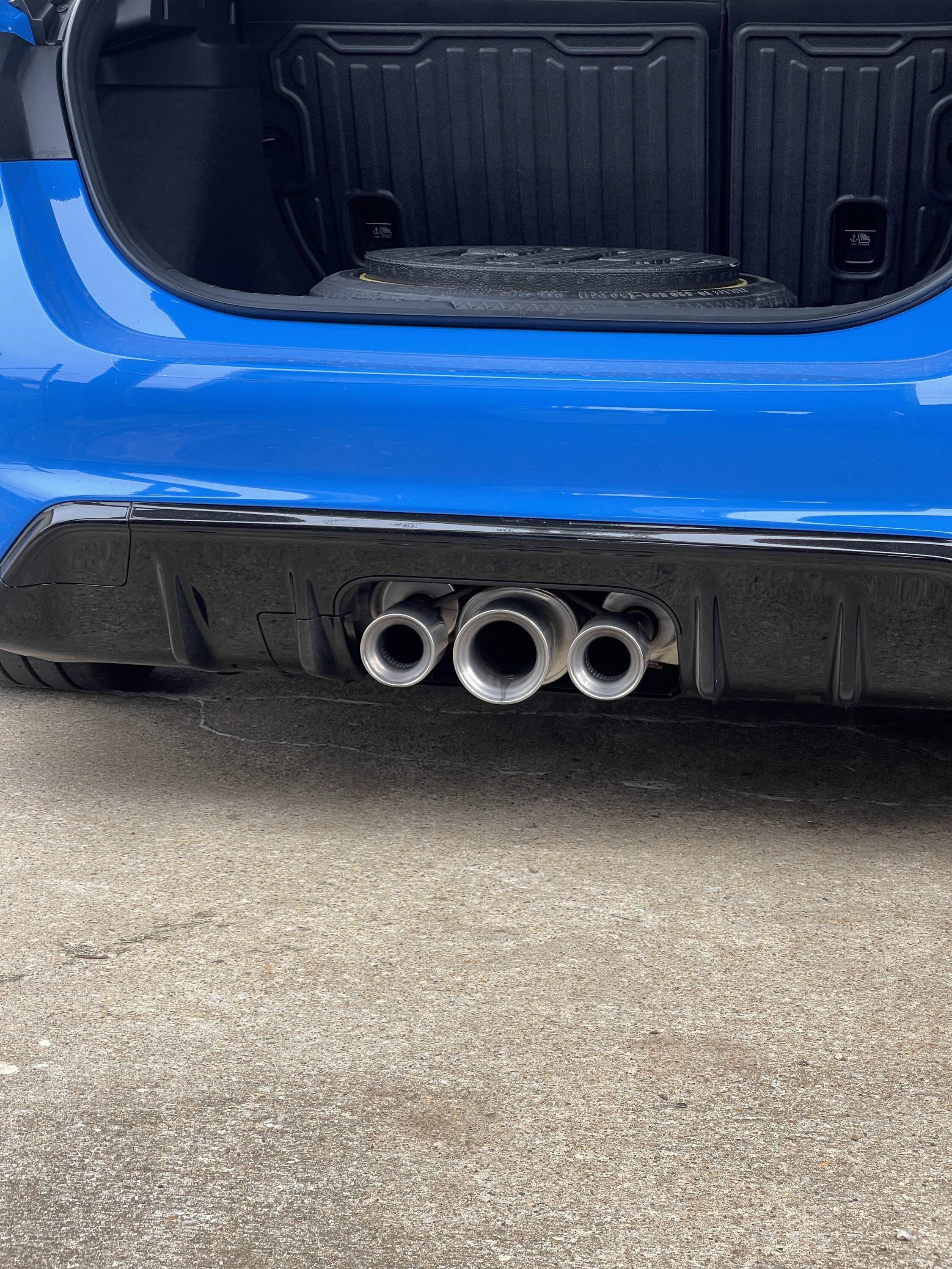

From what I have seen the FL5 kit will lose more space. I have installed the tire in under the floor cover as a reference. The tire well is very shallow compared to the FK8.

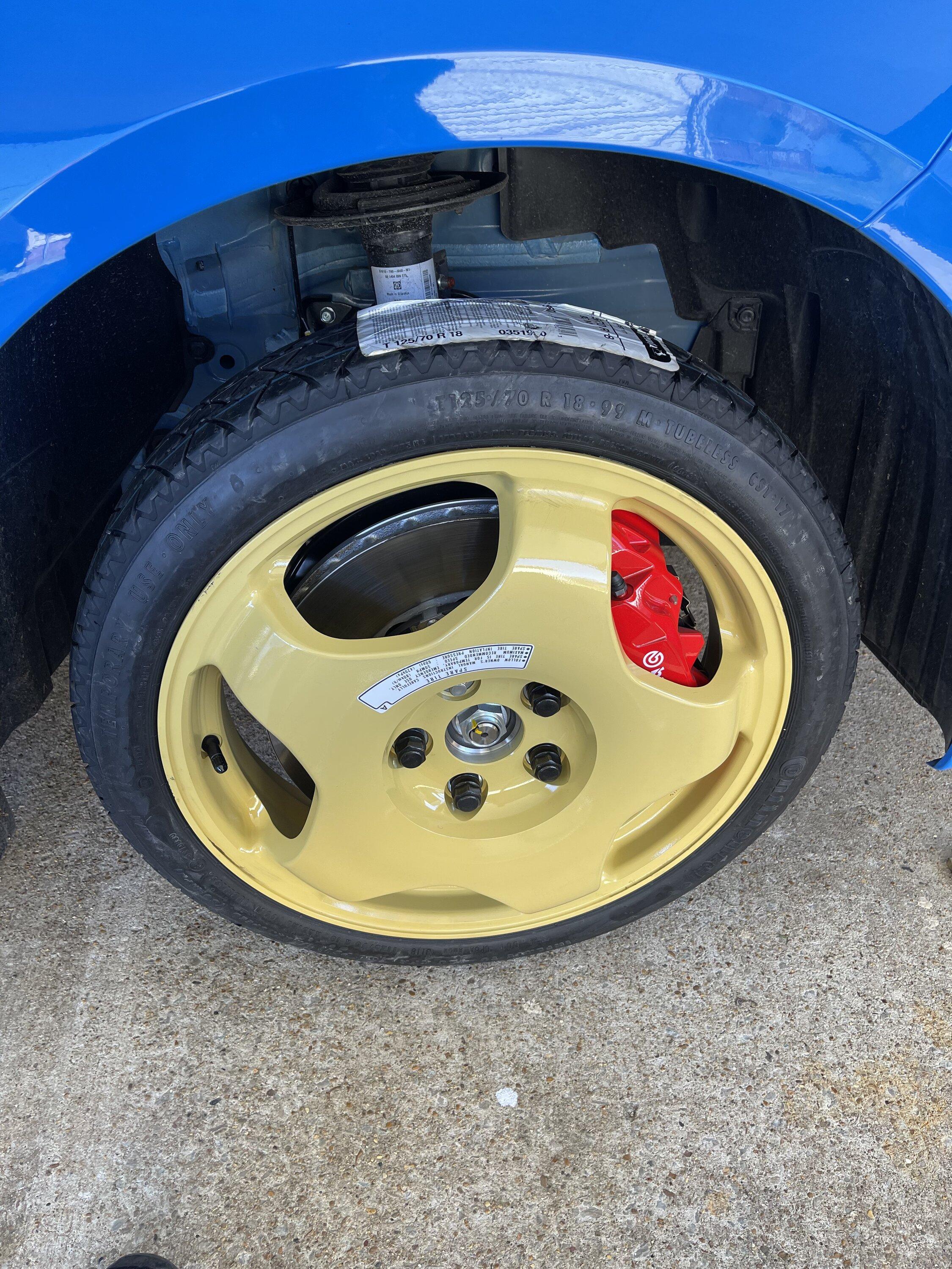

One last thing even though i showed the spare would fit on the front I would never drive the car with it there. With our limited slip differential you could really mess up the differential with that rubber band up front. I'll always put it on the back and move a good tire to the front. Unless you have a full size spare. I have one of each.

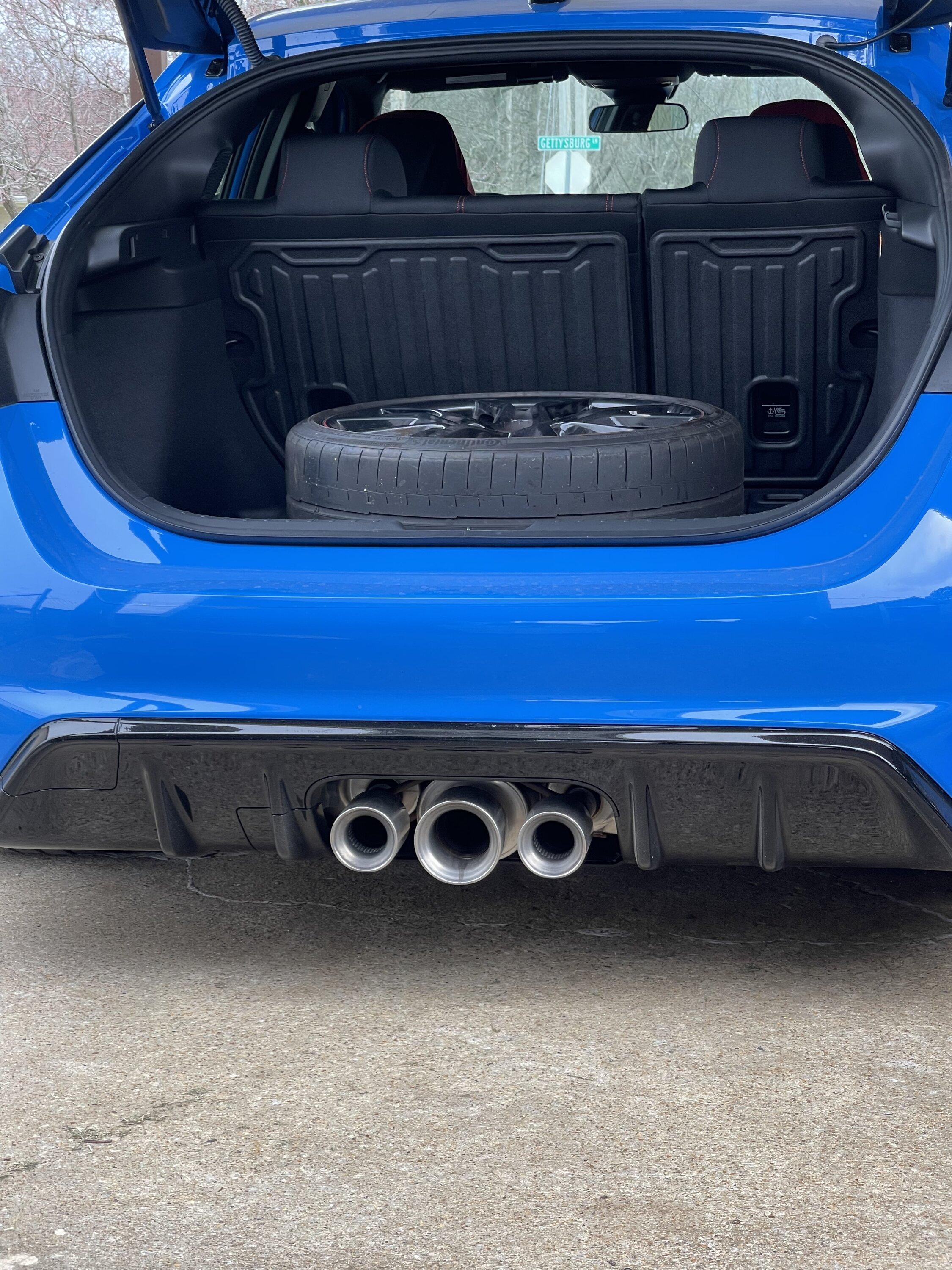

The full size spare is a extra wheel off my FK8 that got ruined by a car wash.

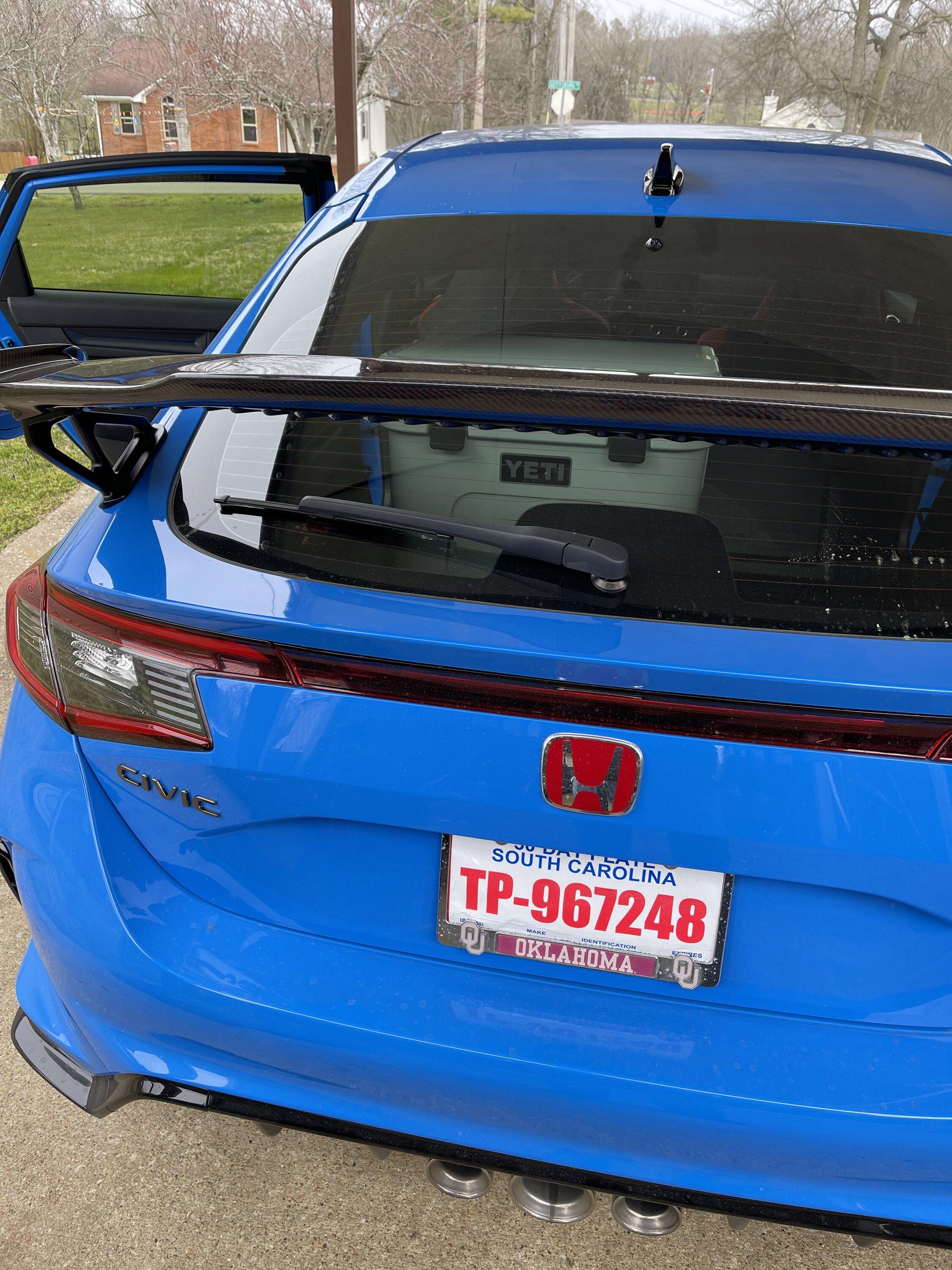

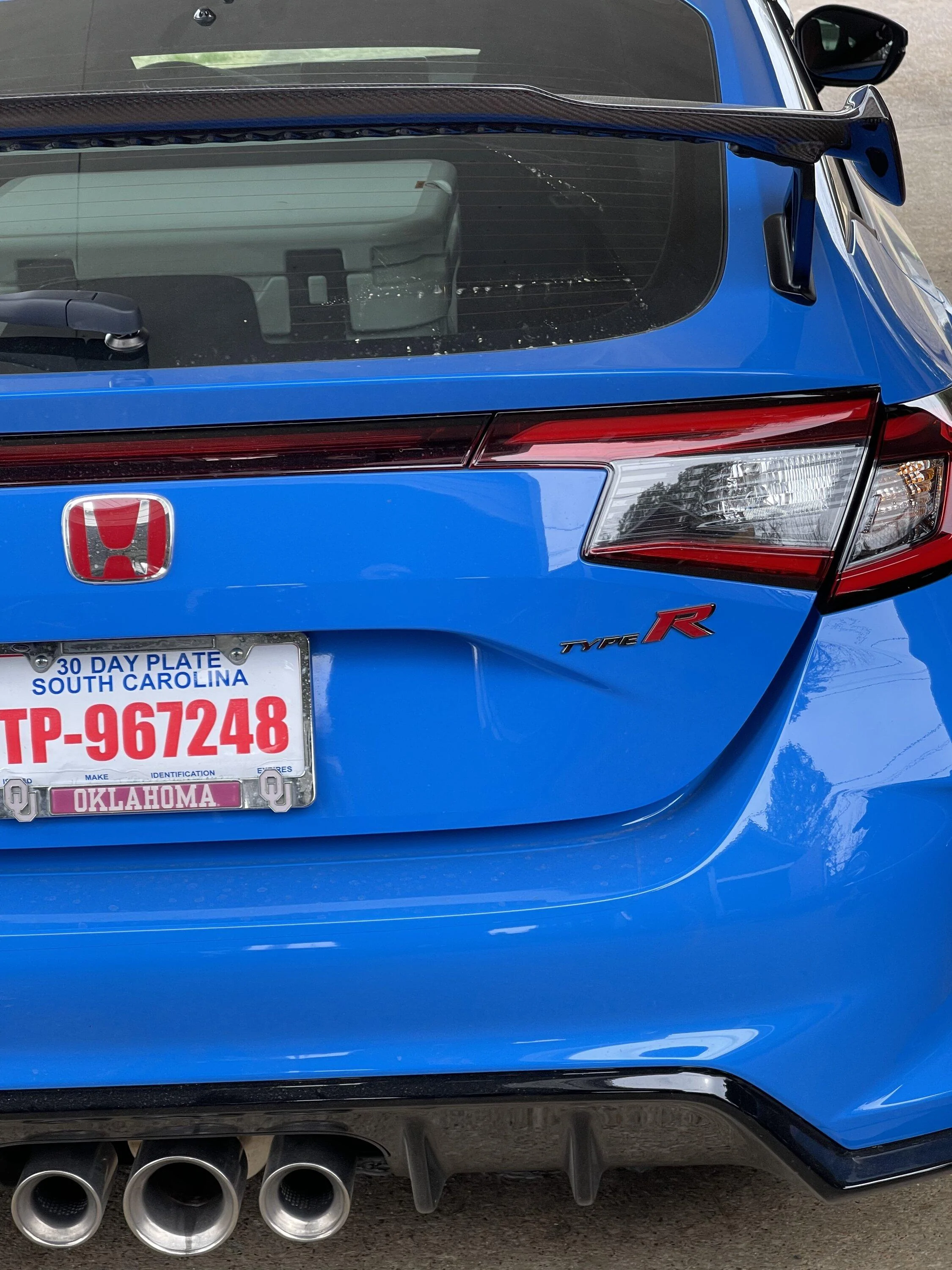

Here’s the pictures. First of all i was able to carry my ice chest in my fk8 with the spare tire installed under the tray. I don’t have the same amount of space to do it now without dropping the larger back seat. This was without the cover or tray in place. So I think we are losing at least 2-3 inchs maybe more.

Many thanks! Do you also carry a full-sized spare sometimes? Given you comment about the limited slip differential, it seems a full-size spare is warranted for long trips, yes?

On a long trip yes. But local if I get a flat I put the spare on the rear and move that tire to the front. A little more work but much safer.
