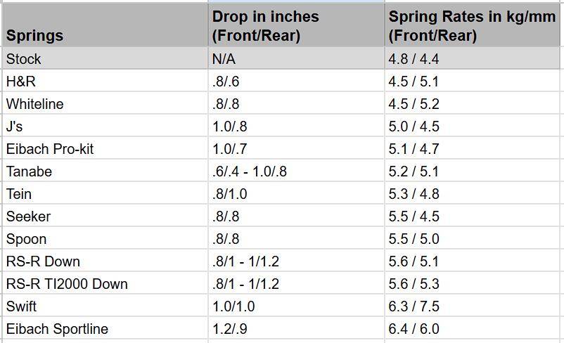

Given this is the current (nov '24) rate choice of the rest of the aftermarket it's either brilliant or a weird choice. Note that H&R and Whiteline do go a little softer in front, 7%, but not 48% softer. We can also see a pretty solid progression of lower = stiffer and if they are claiming a 1.5" max drop that 2.5k seems -really- soft.

I called Fortune Auto this morning and their sales guy ran in back to talk with R&D. R&D said that during in house testing they found the softer front rate allowed for the front to have increased turn in and less understeer, while making the back end a little bit easier to rotate.
I'm still waiting on my delivery so I can't say how balanced the car is out of the box but my general impression is the rates Honda chose were pretty well received.
I would be curious if they took the car out on a track or just drove around spirited backroads or canyons to determine this. As you stated, with the 2.5k rates I can easily see this causing more roll and dive under braking when track driving. Hell when I tracked the stock suspension it had a lot more roll than I was expecting.
