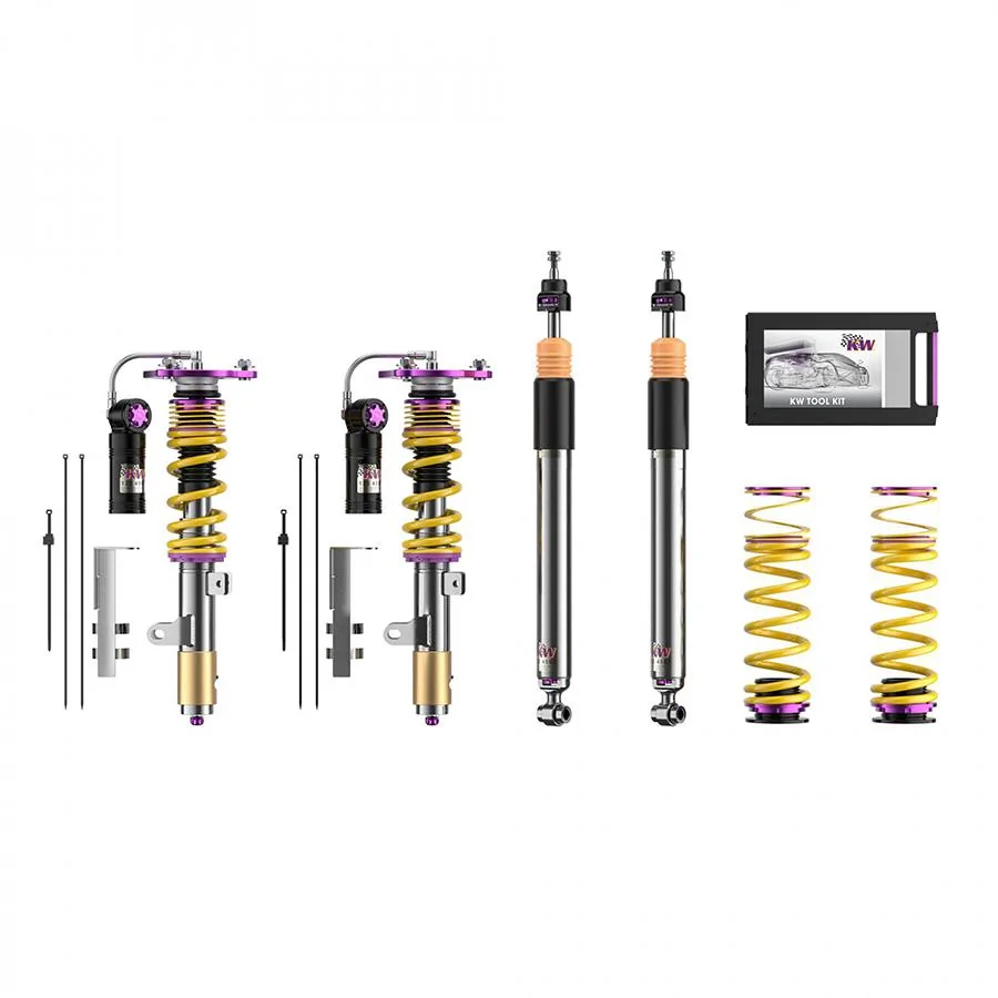

I'm considering whether to purchase the KW COILOVER KIT V3, Ohlins, or the Fortune Auto 510. The Ohlins Road and Track Coilovers are priced at $2700, while the KW V3 costs $3000. There's also the option of the KW V3 CLUBSPORT KIT, which is priced at $6000. Currently, I have a KW/MPP coilovers setup on my Tesla and I'm genuinely impressed. It delivers a near-stock feel on the freeway with exceptional rotation. My Type R is primarily used as a weekend car, with plans for track usage once a month. However, I still want to enjoy driving around the city during weekends.
are there any other options?
Does anyone have experience with these coilovers? Which one would you recommend?
