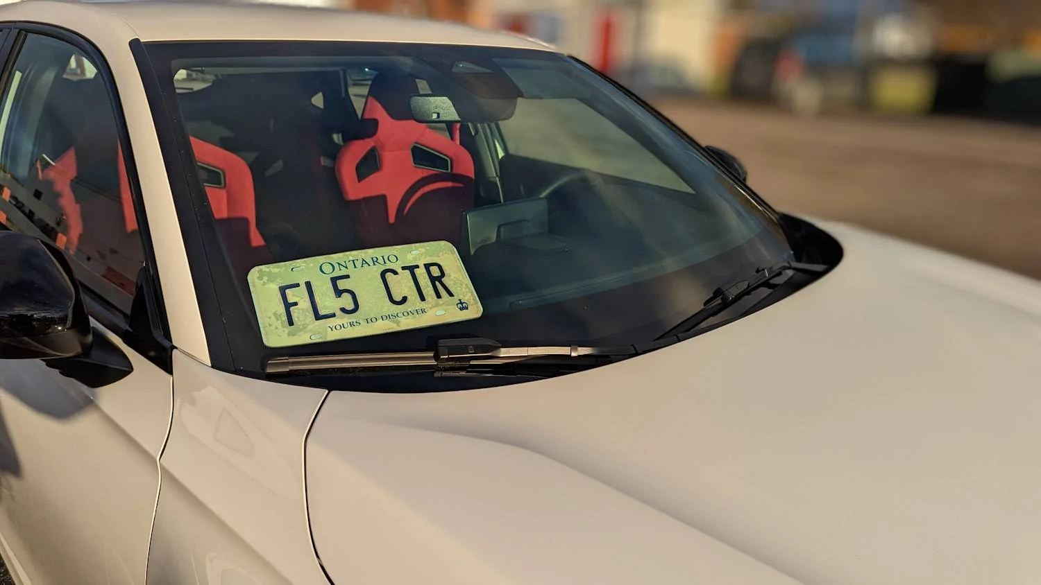

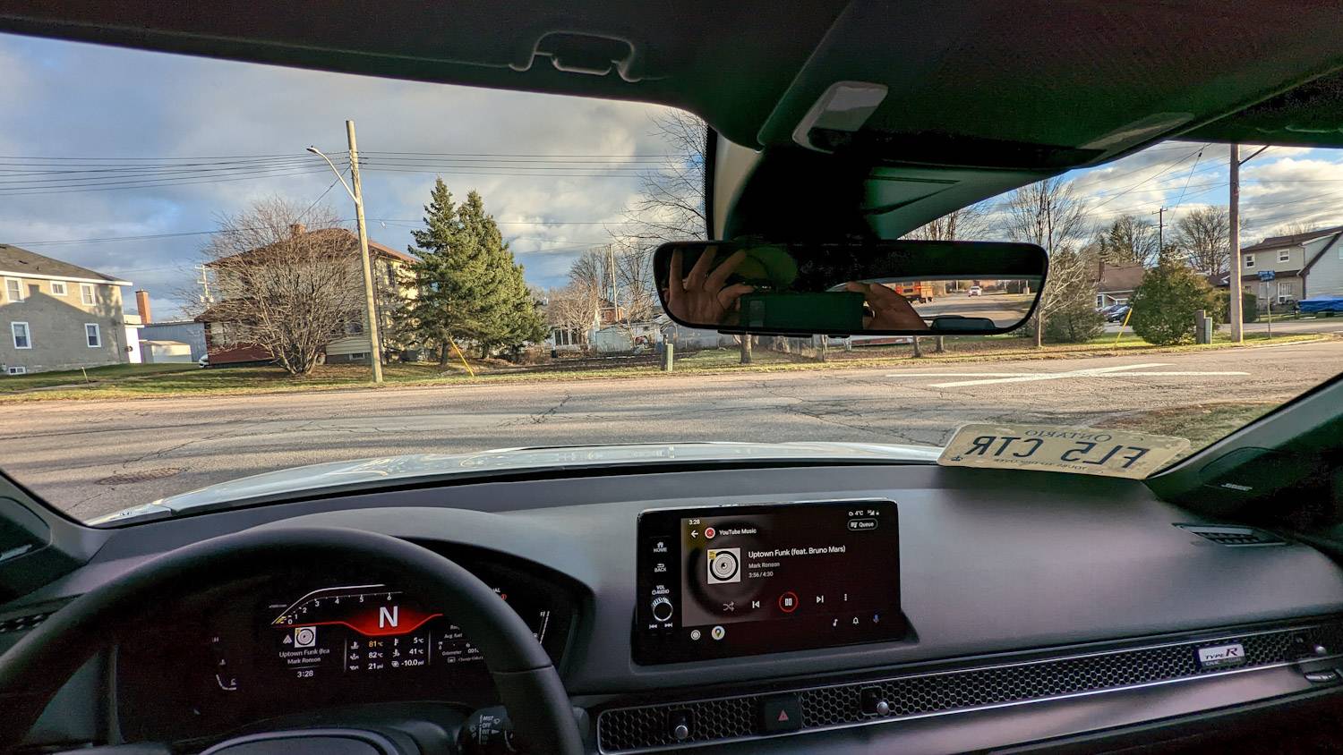

Trying something that may work. It technically is 'attached' to the vehicle. It's a static window sticker of the plate. Cost $12 at Vista Print. Worth a try. Will keep the real plate in the car and see how this goes.
That isn’t legal in Ontario
The law clearly states the front plate must be mounted to the front of the car.
You will get a ticket IF a cop cares enough to pull you over.

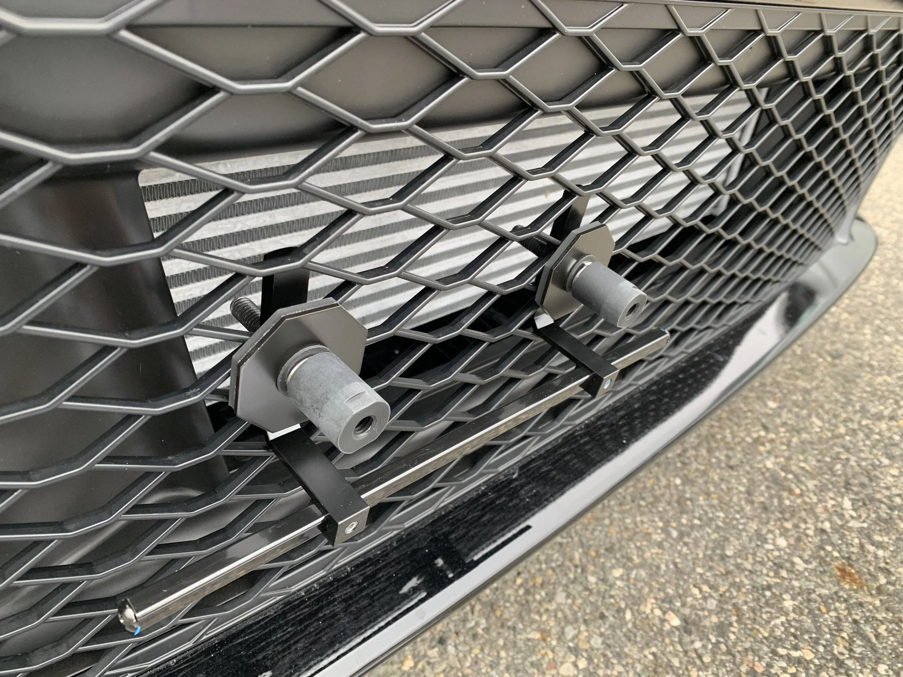

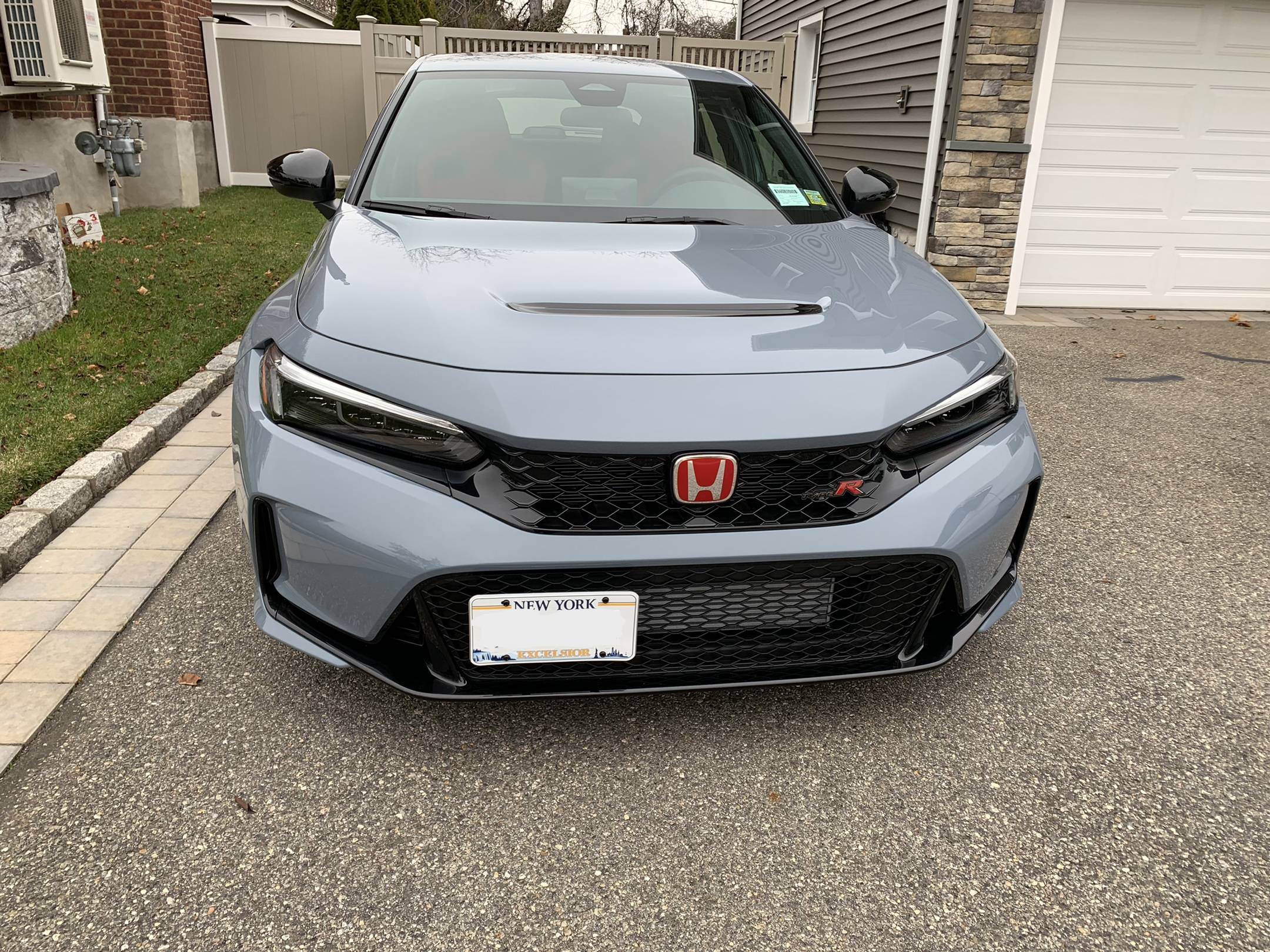

lucky-ookami and modular cal mentioned The Sly brackets.
Bought it and installed the front plate today. Here are some pics.
Observations are:
- quality is nice
- the front lower mesh grill is fairly flexible so installed it closer to the side (to try and take advantage of the grill perimeter being stiffer) but couldn’t slide it too far over otherwise the structure behind the grill would be impacted by the threaded stud
- sticks out about 1/4”-1/2” further than I would like. Will look to shorten the standoff when I have more time

@TDC50 will that block air going to the intercooler?

Yes a little but the factory grille opening is huge and the car is being used on the street so engine wont be stressed thermally.
If you were to track your car with one of these brackets on it is a simple case of removing the four small screws that hold the plate on so as not to block the grille at all. The bracket is machined aluminum so would imagine it would withstand many disassembly/reassembly operations

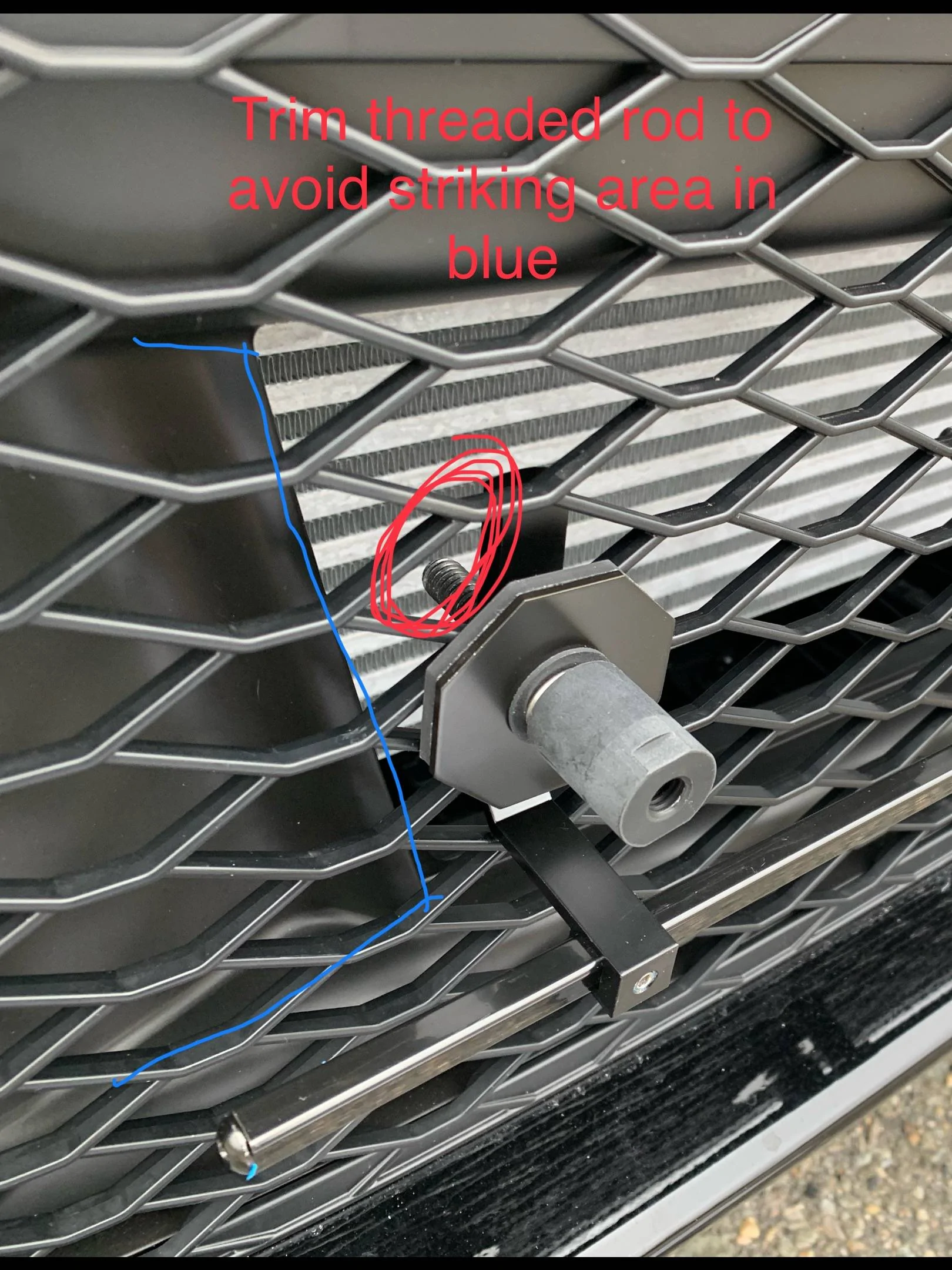

I imagine you could probably mount it or slide the bracket more to the side as well to free up some air flow. Or is this as far out as you could get it?

Here is a pic showing a constraint and how to overcome it so you can move the bracket more to the side. With that said the grill does start to angle more as you get closer to the perimeter
