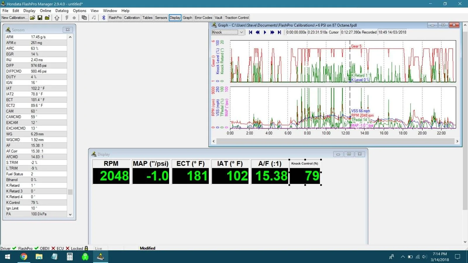

So I'm running the +6 PSI on 87 octane. Can those who are more experienced with reading these graphs and percentages tell me if I should continue or change to higher octane fuel?
There seems to be a higher Knock Control % versus having 50%-60% when on 91 octane, should I be concerned?

you guys keep talking about engine knock.......you won't get any, the computer takes care of that.
You WILL get less hp if you run regular as the computer cuts back on the power.
BUT.....Why in the world would you spend money on a tune and want to run low octane fuel?
It's like buying a $50.00 steak and putting ketchup on it!!

For those running an additional +6psi and not following the recommended octane, you are losing much more than just Hp/Tq.
Understanding that increased pressure equals higher heat is basic. The VTC does a rather good job with scavenging, but as your ignition timing decreases you will eventually understand what that pressure and heat will do over time.
At the cost of $.30/ga more for premium fuel X 12ga would take you 152 Full Fill-Ups OR 45,600mi (avg 300mi a tank) in order to match the cost of just a V.1 from KTuner.
Save the purchase of the tuner and stay on 87oct. It will provide you with an additional $550 of disposable income for regularly scheduled maintenance.
There is the ZERO tune that is basically a stock boost level with some quick adjustments. But, is that what someone would purchase the tuner for...

I really hate when people claim these cars don't knock. The computer will do what it can to prevent it based on estimate algorithms combined with knock sensor activity but it surely isn't ideal to have any knock control higher than the 49% or 54% depending on which tuning software your running. Period. Even stock.

That is absolutely correct @PowerPerLiter .
Using the correct octane a tune recommends will bring the K.Count to .49 and would NET MBT. That’s what we really want.
