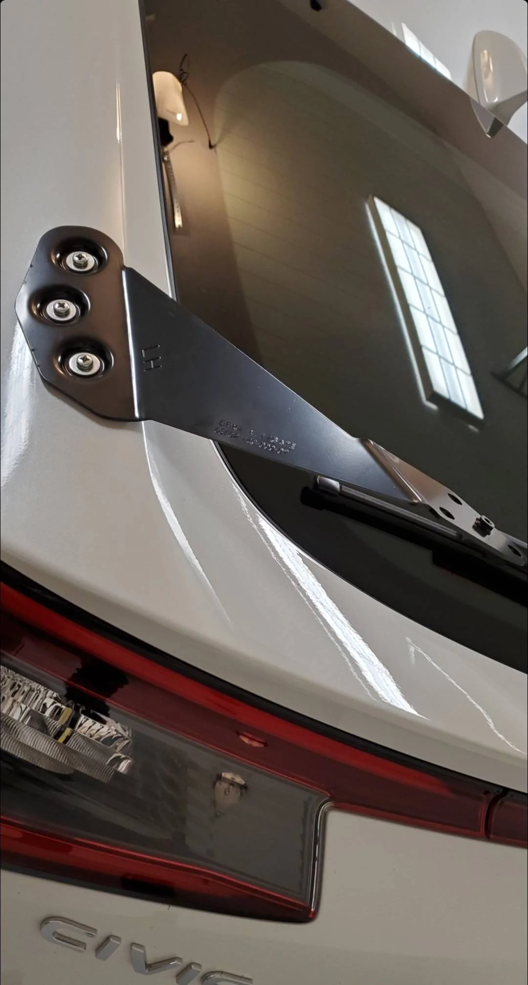

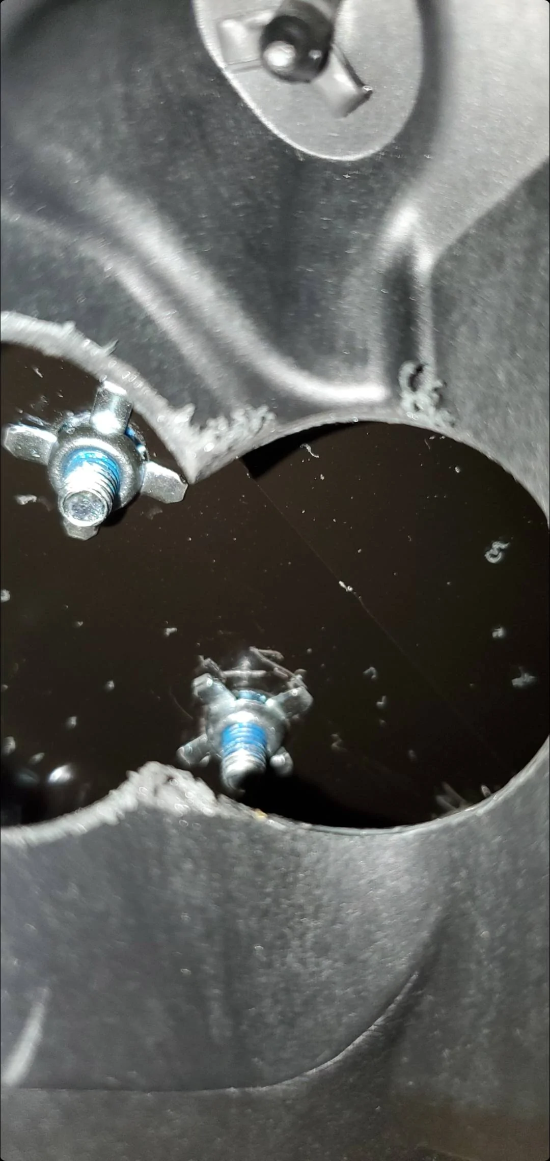

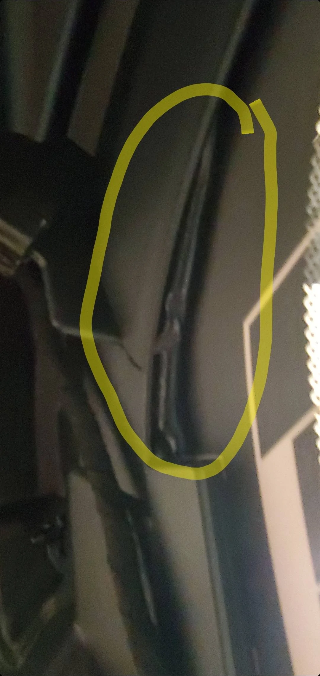

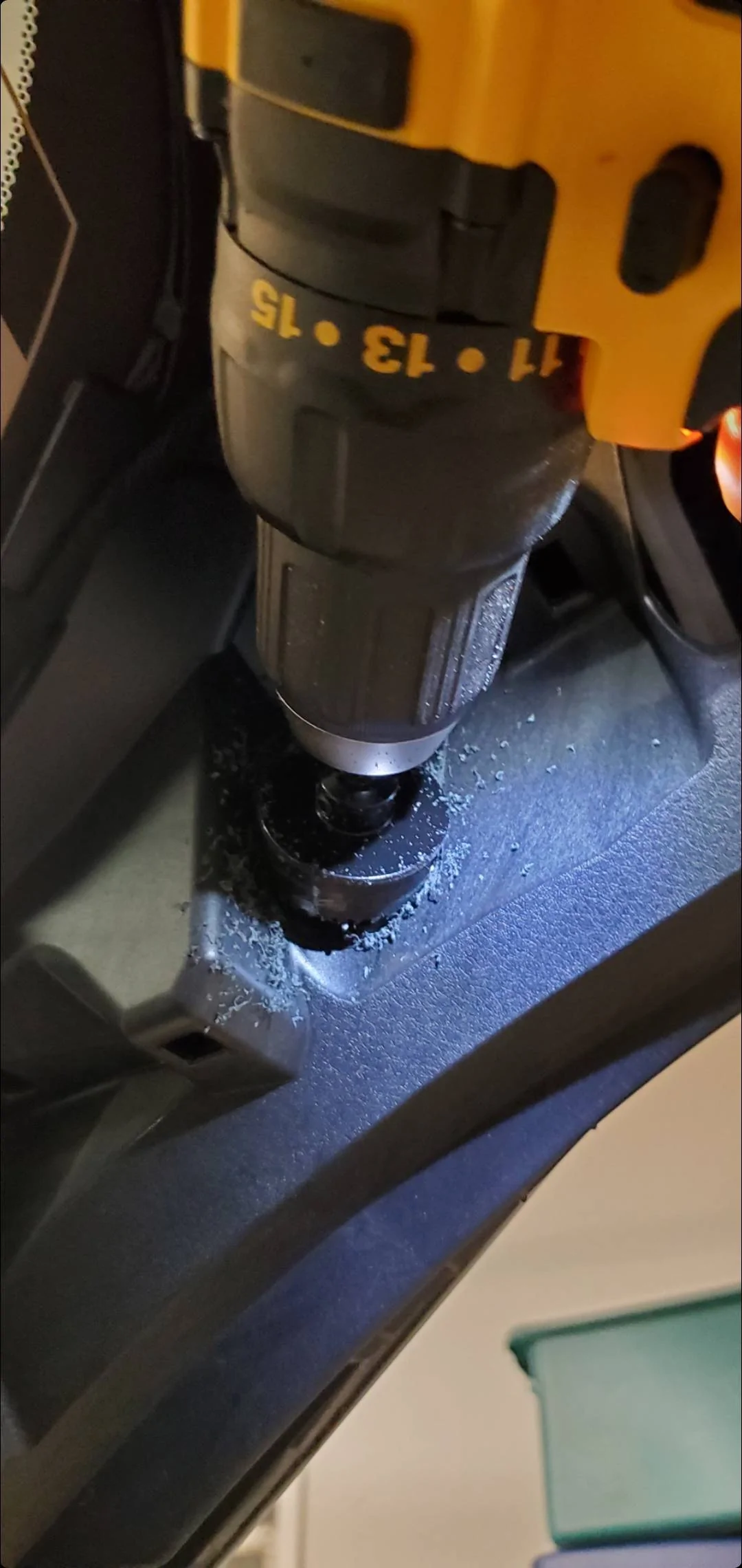

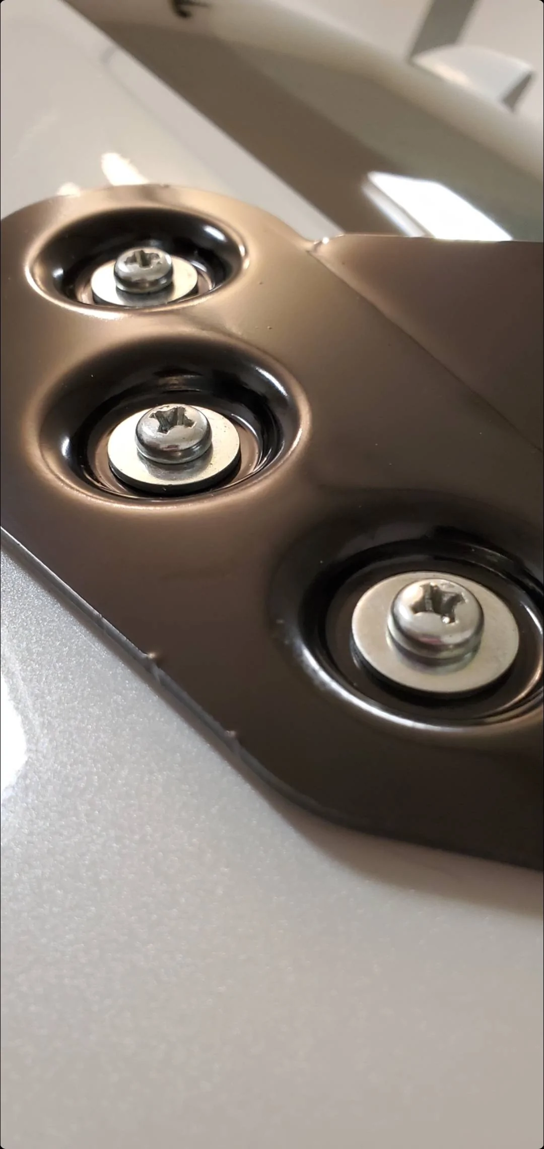

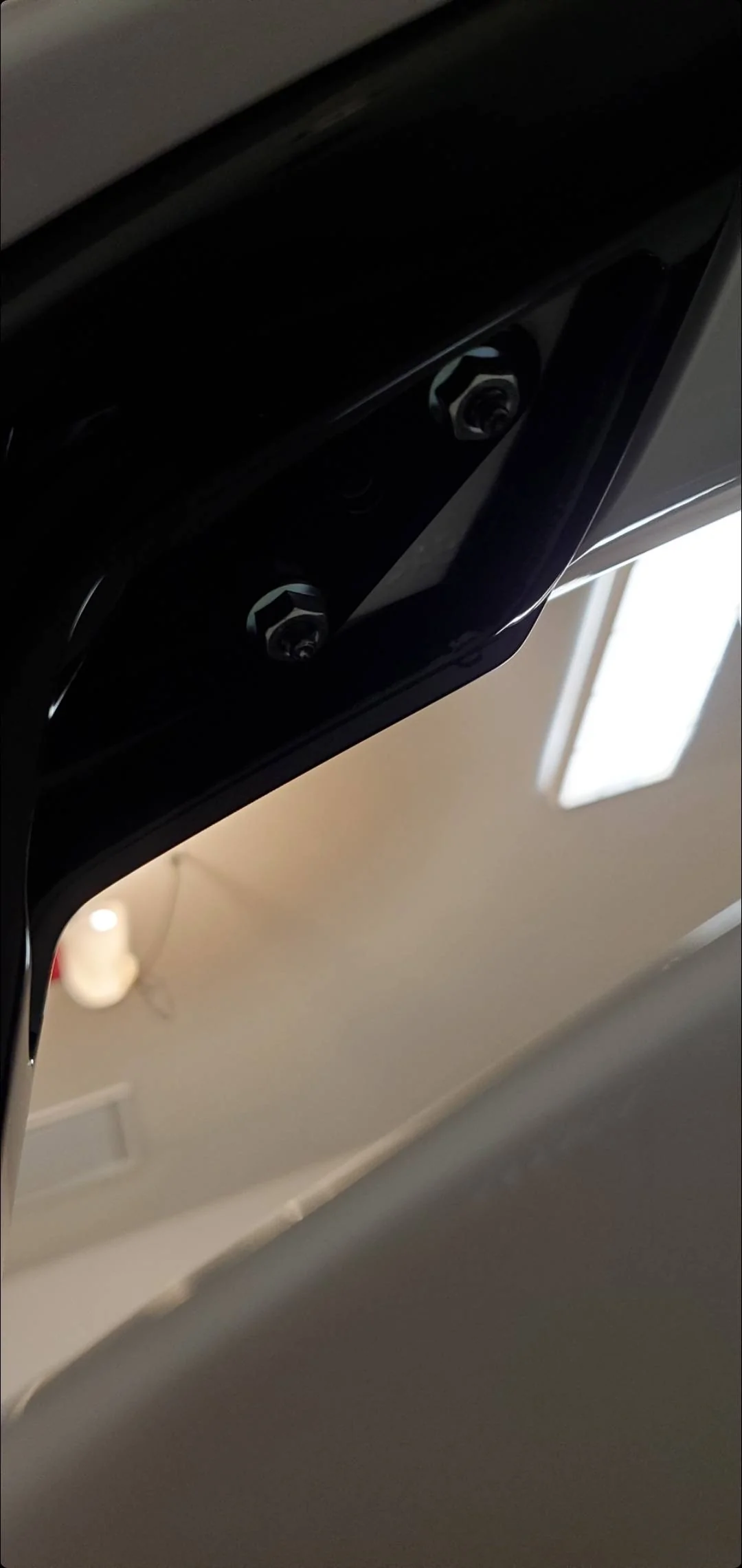

Ok I opened up some room. I may go back behind with nuts to make sure these don't back off. I used a flat head screw driver against the back side to keep these from turning so I could fully tighten them .. Got it ?

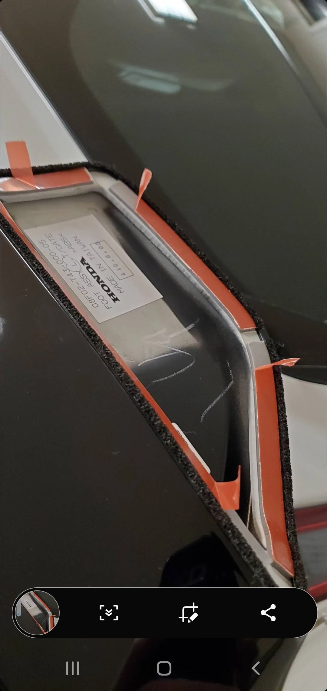

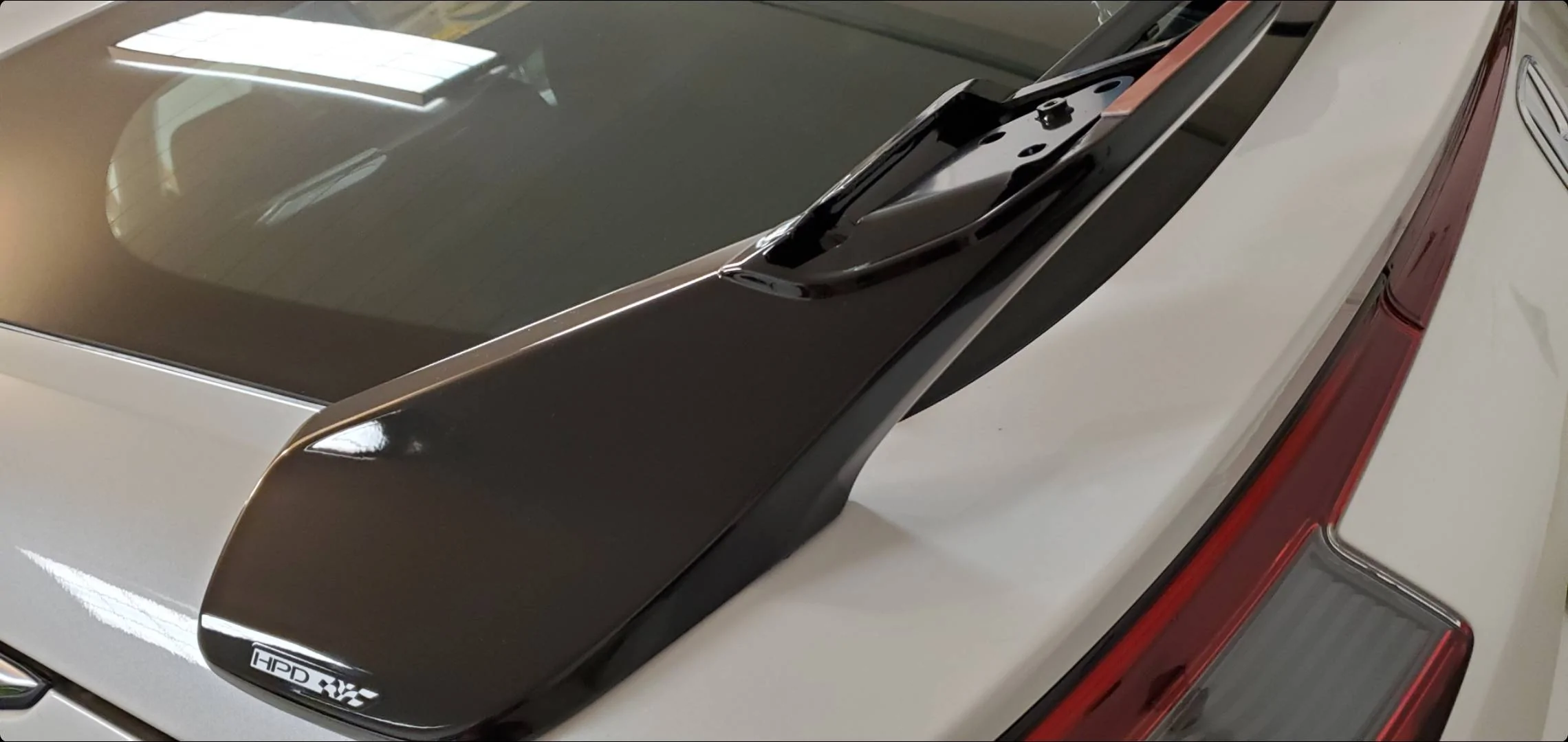

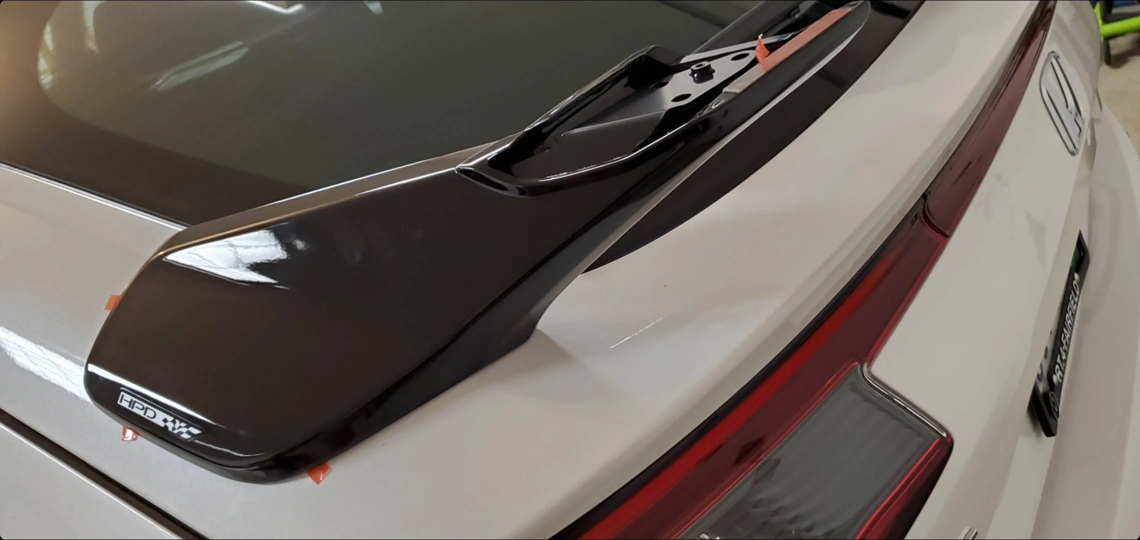

Well I did leave out a few things. Like the hatch shocks install upgrade that was included with the spoiler. Removing and reinstalling the hatch interior trim piece held with 2 screws in the handles. Kinds hidden. And I scrapped the rubber seals and put silicone adhesive because the space was very tight to work them in between the metals.
