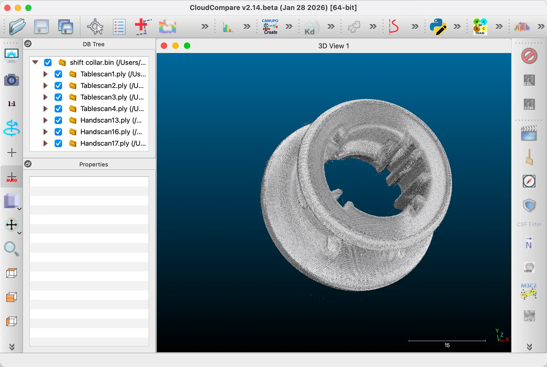

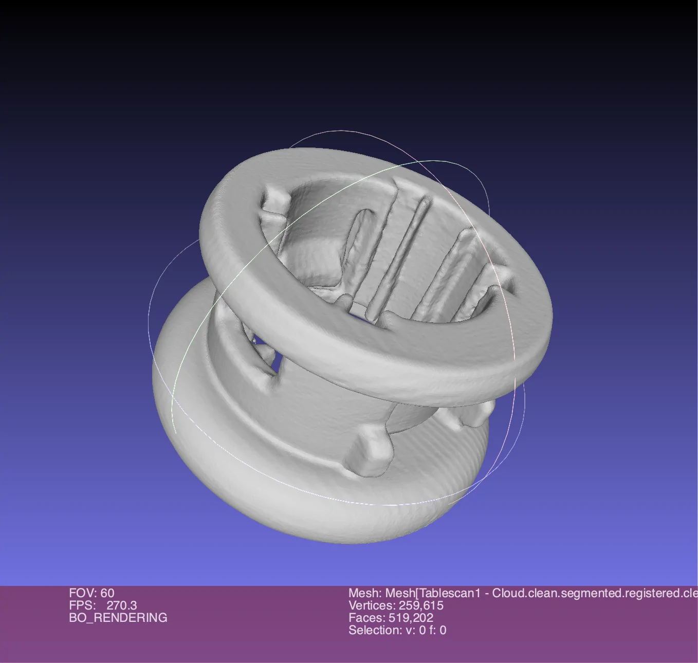

Scanning was done with a 3dmakerpro Seal Lite. I ended up doing a total of 7 scans, then using CloudCompare to align them and create a mesh which I cleaned up in MeshLab. Finally, I could import it into Solidworks and begin the long and painful process of turning it into a proper CAD model.

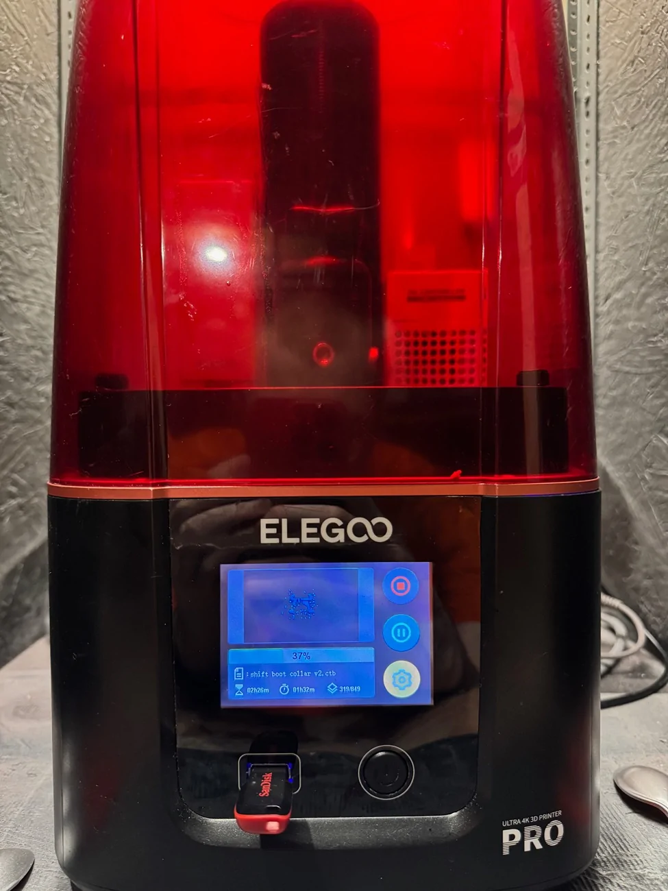

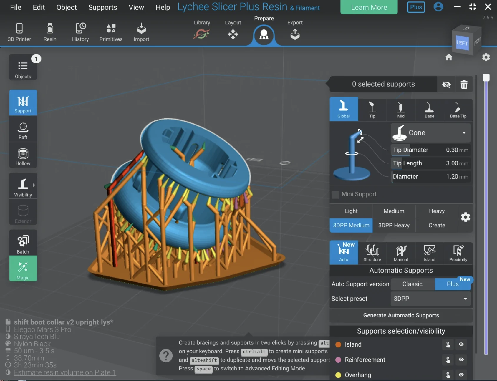

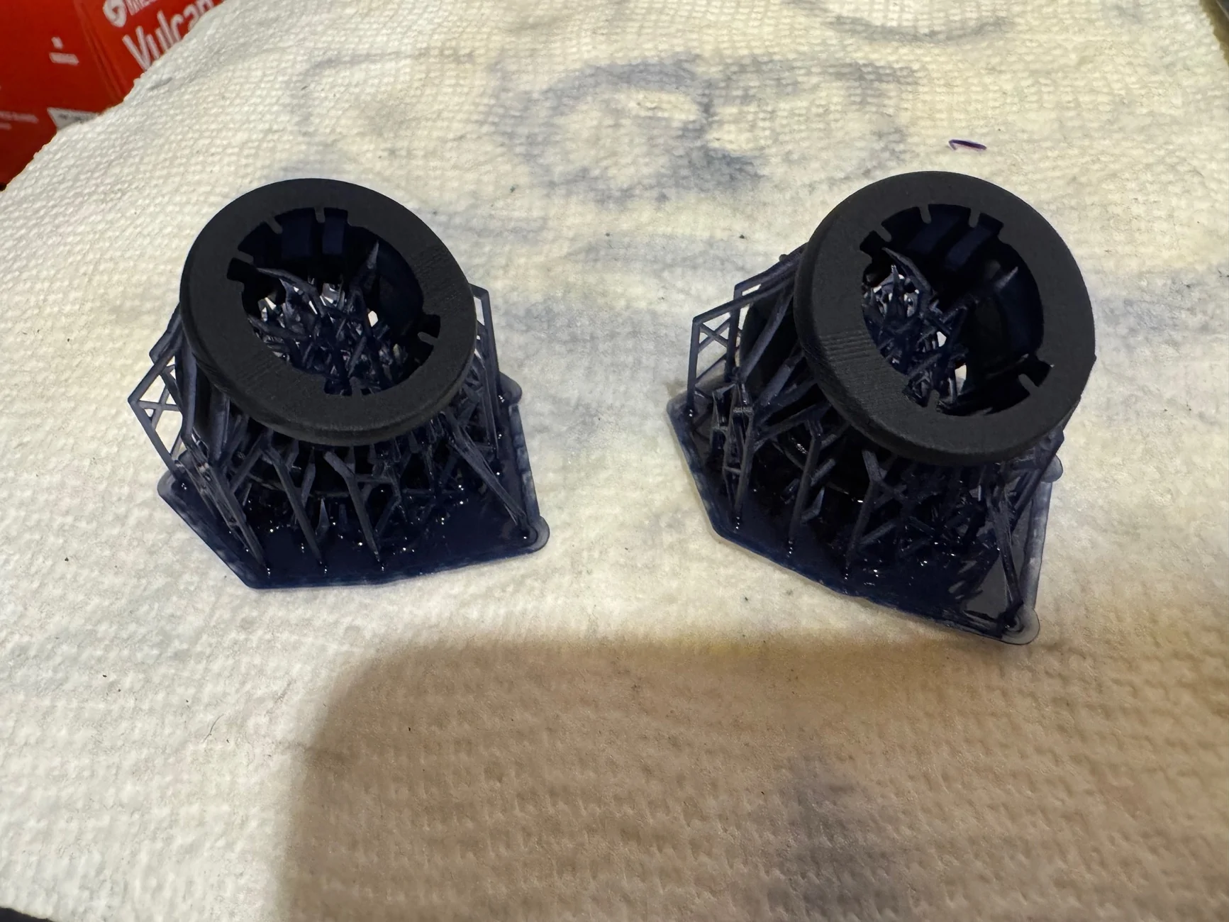

The CAD model was sliced in Lychee and printed on my Mars 3 Pro using Sirayatech Blu Nylon Black resin like I mentioned earlier. Supports were placed such that none touched any surface that would be visible when installed in the car. I included this pre-supported model in my Printables link at the top of this post. When printing, I did have to keep the chamber heated to 30C because Blu is a pretty viscous resin.

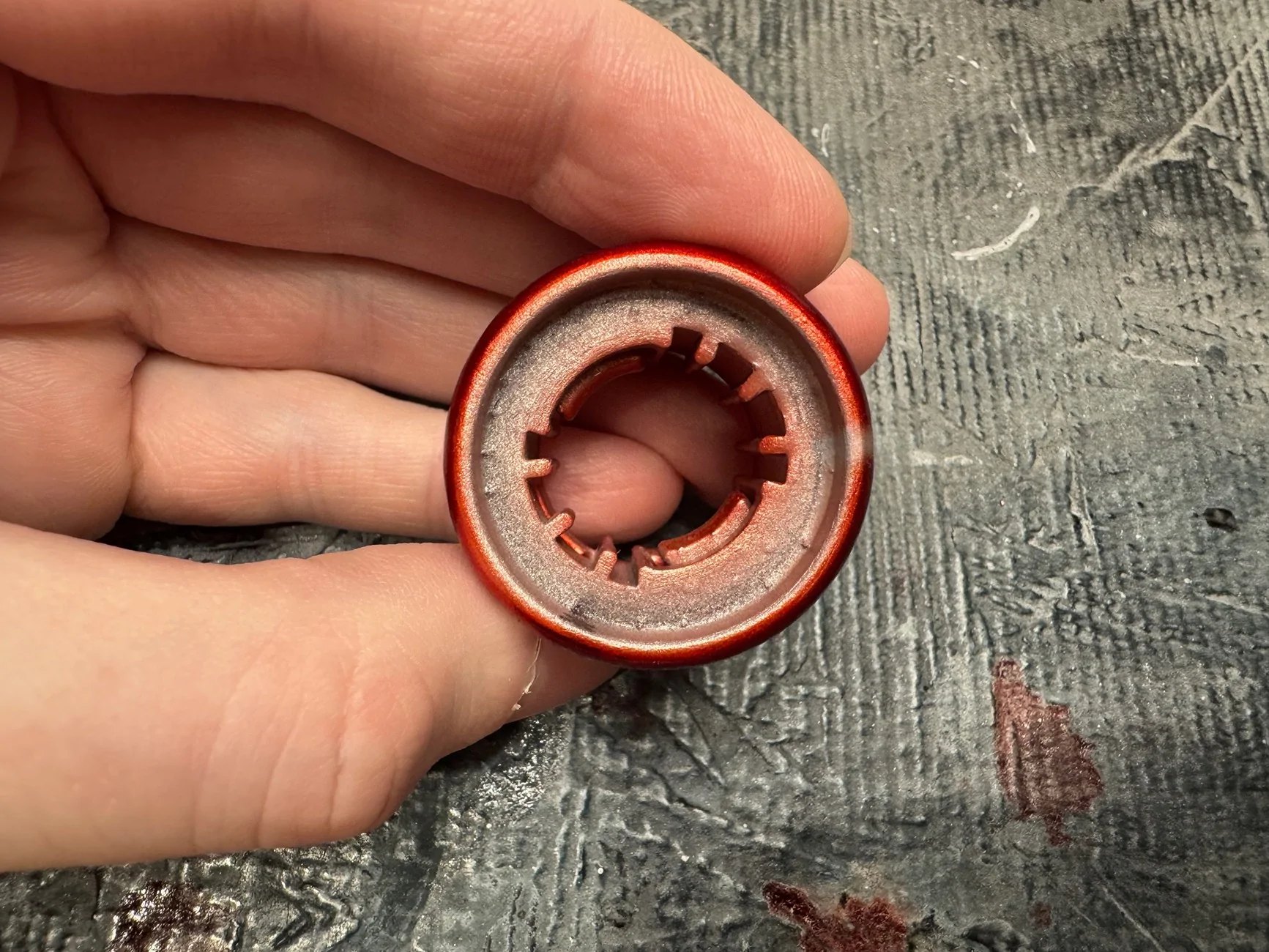

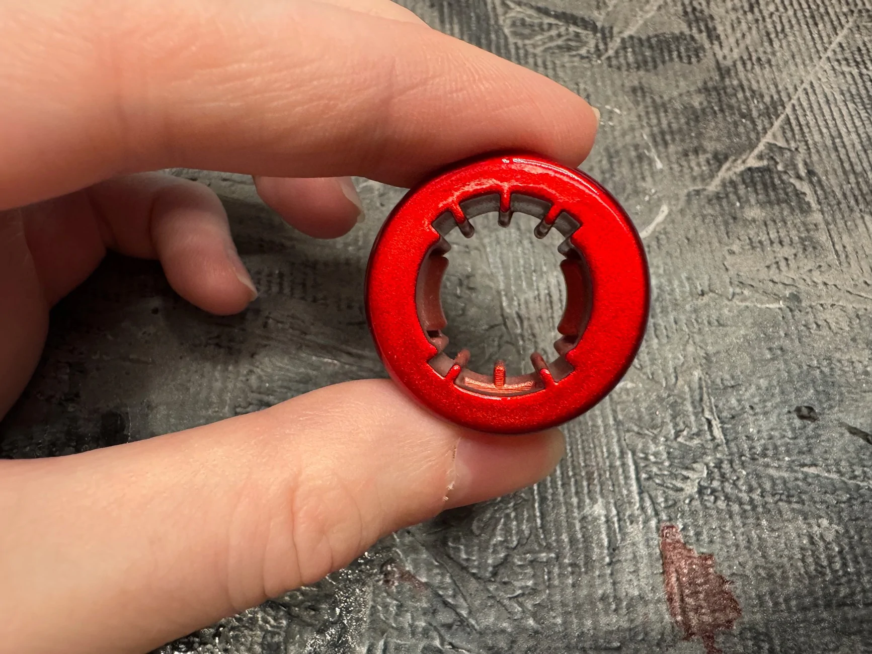

Supports were removed, then each print was wet sanded to clean up as many support pock marks as possible. I didn't bother with most of them because they wouldn't be visible or affect functionality when the collar is installed. After one more IPA bath they were put into the cure station for final cure. After that I sprayed them with primer and I was finally ready to paint. It actually took me about 3 weeks to dial in my paint stack and get the finish I wanted. I was going for a metallic candy red that would look like a plain deep red normally but turn into a bright shiny metallic red when light hits it.
This is what I ended up with. All paints were airbrushed with a 0.3 mm nozzle except the clear which I did with a 0.5 mm nozzle, and the primer which was a rattle can.
  1. Tamiya Fine Surface Primer (Grey)
  2. Tamiya X-11 (metallic base, 3 coats)
  3. Tamiya LP-52 (clear red, 6-7 coats until I got the color depth I wanted)
  4. Clear coat from the Honda OEM touch-up pen, thinned with Tamiya lacquer thinner & mixed with Mr. Retarder Mild (durability, UV protection & gloss, 3 coats)

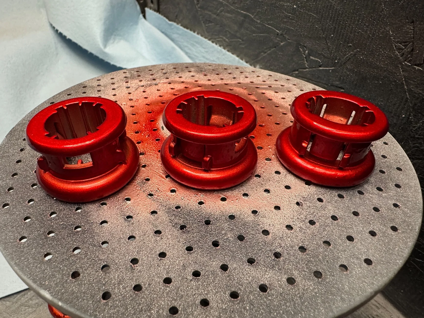

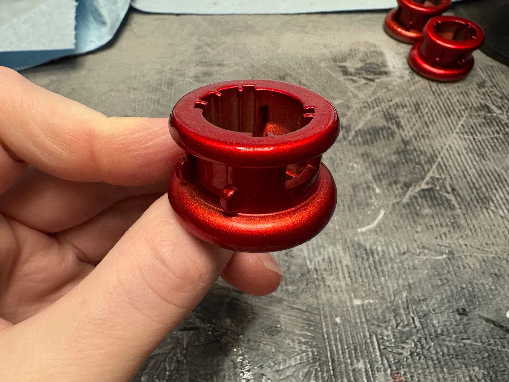

The 2 prints in the above image were test parts to see how my paint stack looked on the actual part. The ones shown below were the real parts. I made 3 in case I screwed up painting one/broke it/needed spares later.
11th Gen Honda Civic I made a 3D printable model of the OEM FL5 shift boot collar IMG_3904
Painting is finished!
11th Gen Honda Civic I made a 3D printable model of the OEM FL5 shift boot collar IMG_3974
11th Gen Honda Civic I made a 3D printable model of the OEM FL5 shift boot collar IMG_3971
11th Gen Honda Civic I made a 3D printable model of the OEM FL5 shift boot collar IMG_3972
11th Gen Honda Civic I made a 3D printable model of the OEM FL5 shift boot collar IMG_3973
11th Gen Honda Civic I made a 3D printable model of the OEM FL5 shift boot collar IMG_3869
11th Gen Honda Civic I made a 3D printable model of the OEM FL5 shift boot collar IMG_3872

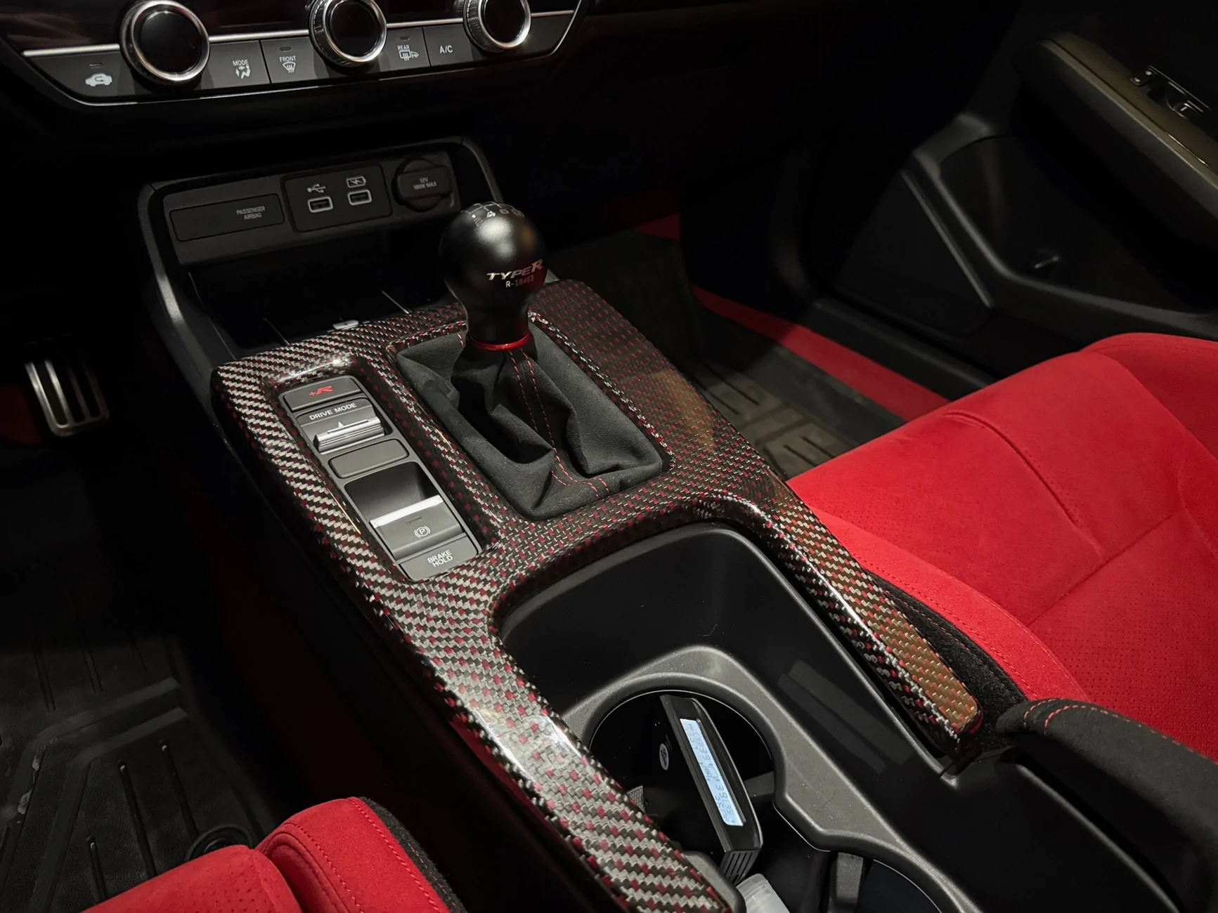

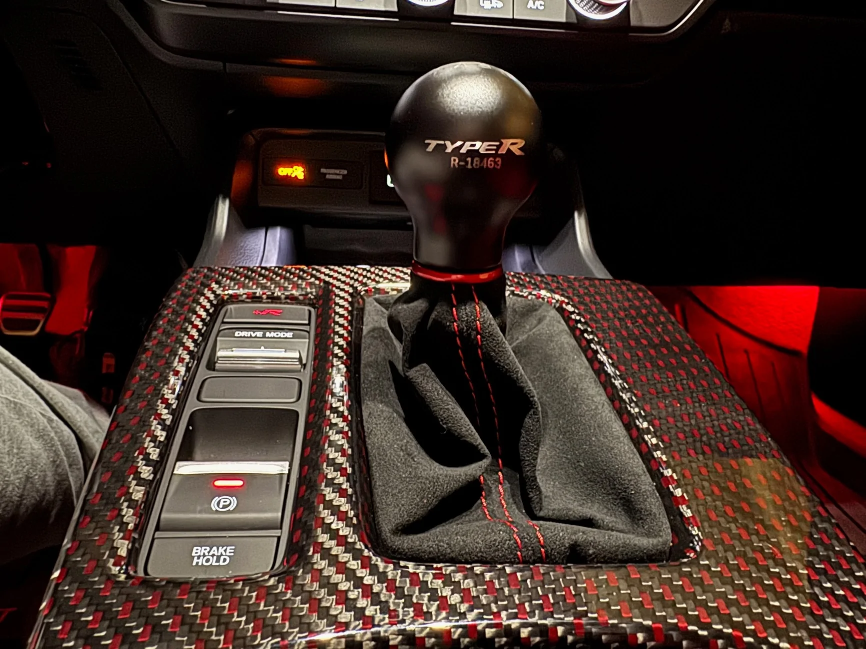

I'm very happy with the result. I think it blends really well with the red accented stitching on the boot and carbon fiber surround. In total this project probably took me about 2 months. Most of that time was spent rebuilding the OEM part in CAD and experimenting with paints to get something I liked; though the multi-day cure times between layers didn't help. Anyway I hope some of you guys find the model useful.

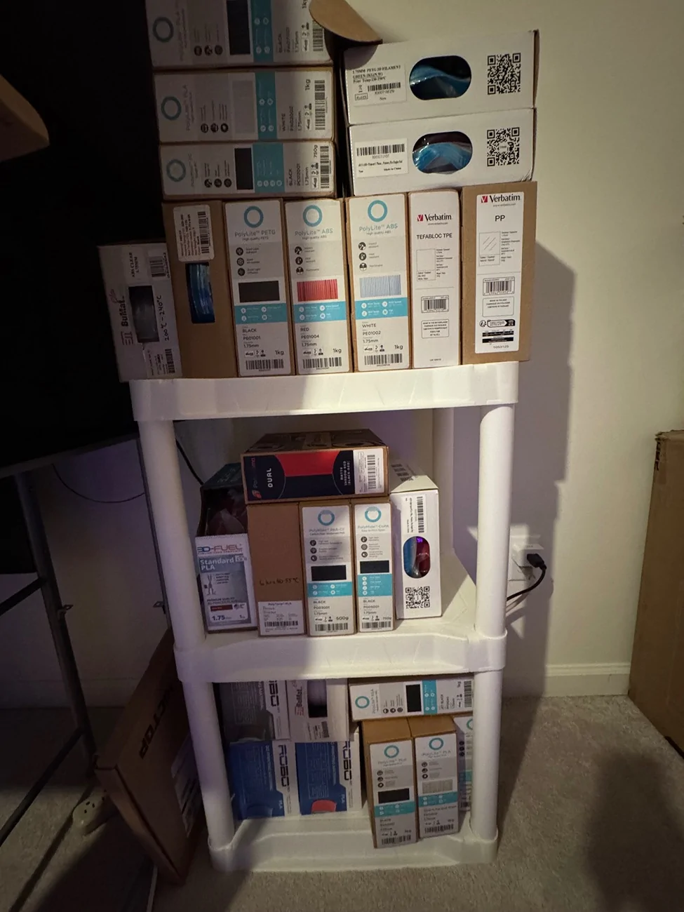

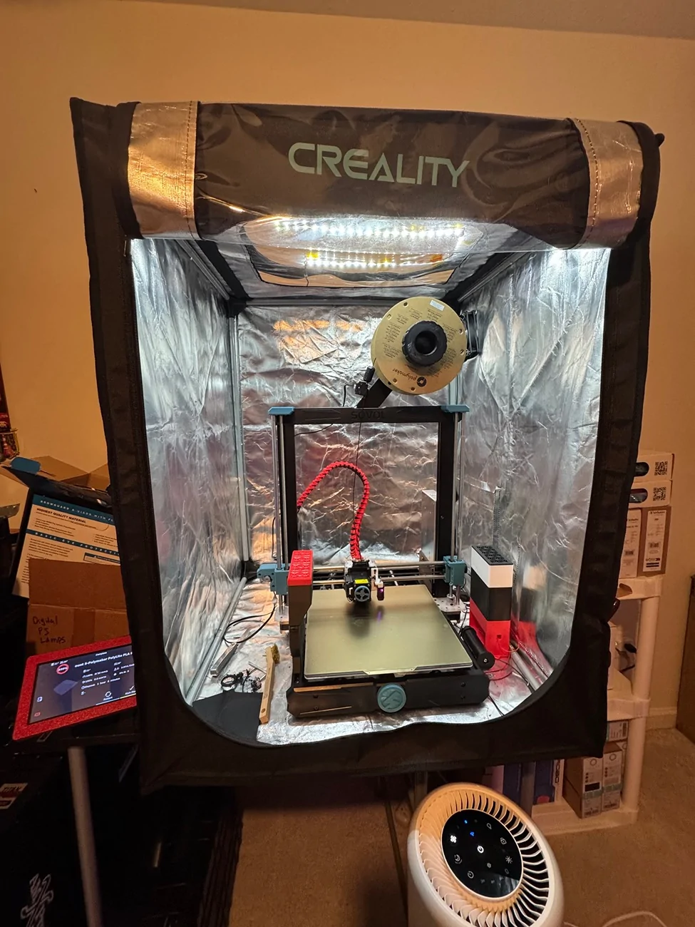

Yeah I've been wanting to install an AMS for a while. The SV06 and SV06 Plus are good printers and super affordable but do need a lot of modding for reliability and expanding the types of filament you can print. I have way too many types but mainly use PLA for quick prototypes and PolyMax PC (very high strength polycarbonate) for working parts. PolyLite PC is brittle but extremely rigid and temperature resistant which is why I used that to print brackets and stuff for the printer. I actually used PolyMax PC to make adapters for the OEM wheel center caps so I could put them on my winter wheels, and they survived 2 upstate NY winters so far. Polycarbonate in general is a pain to print though (PolyLite PC in particular likes to warp a lot, much worse than ABS) and is one that needs almost 300C at the hotend. Polypropylene is one I like to recommend if you have a build chamber. It's very flexible without fatiguing and extremely durable, but is also a pain to print. Since it's chemically stable I used it to make screw-on plugs and caps for my oxyacetylene cylinders/regulators/etc.
