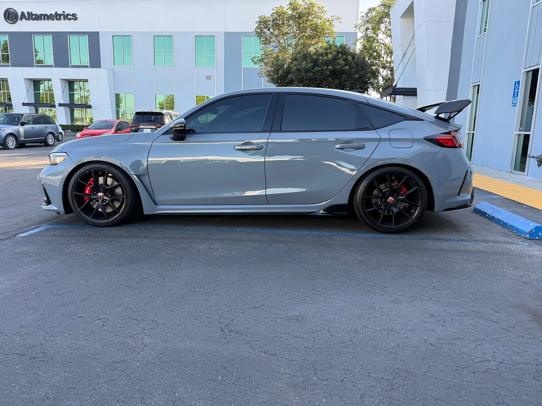

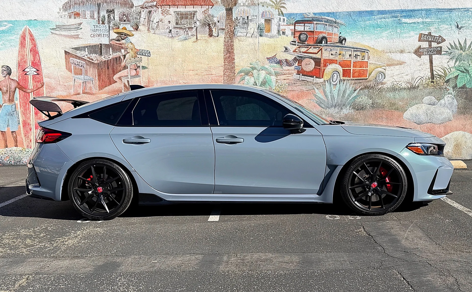

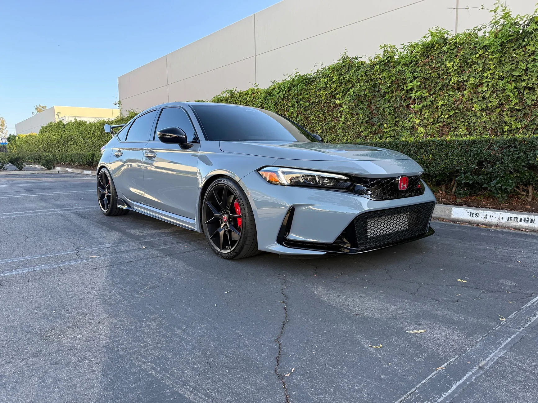

I prefer 19’s for My application anyway just spirited street /twisties and only a few possible track days.
Love the looks but with that being said if I tracked it often I would definitely probably have a set 18’s for the occasion.

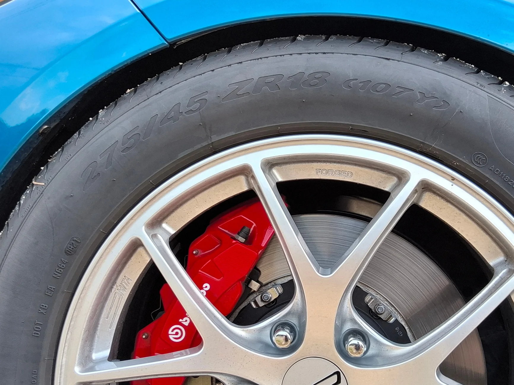

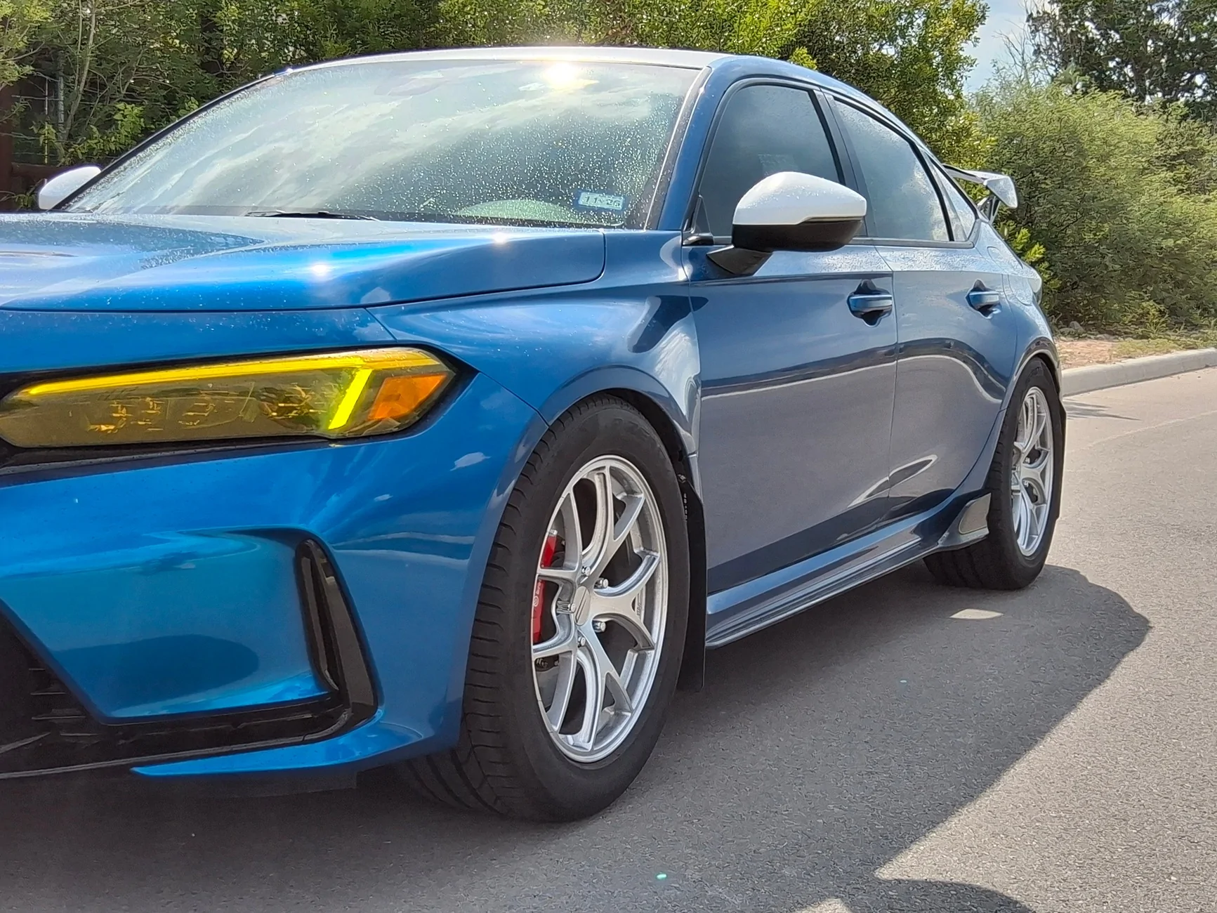

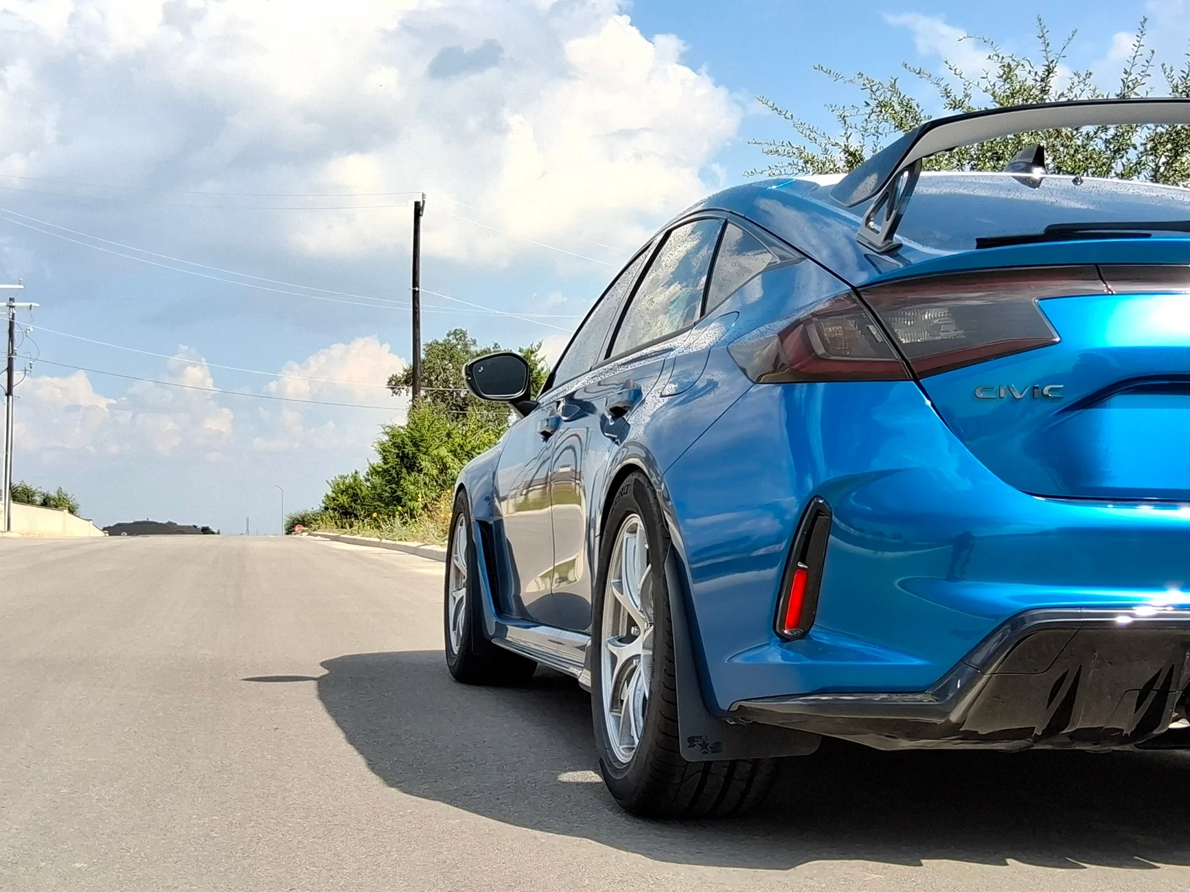

Which wheels are those?

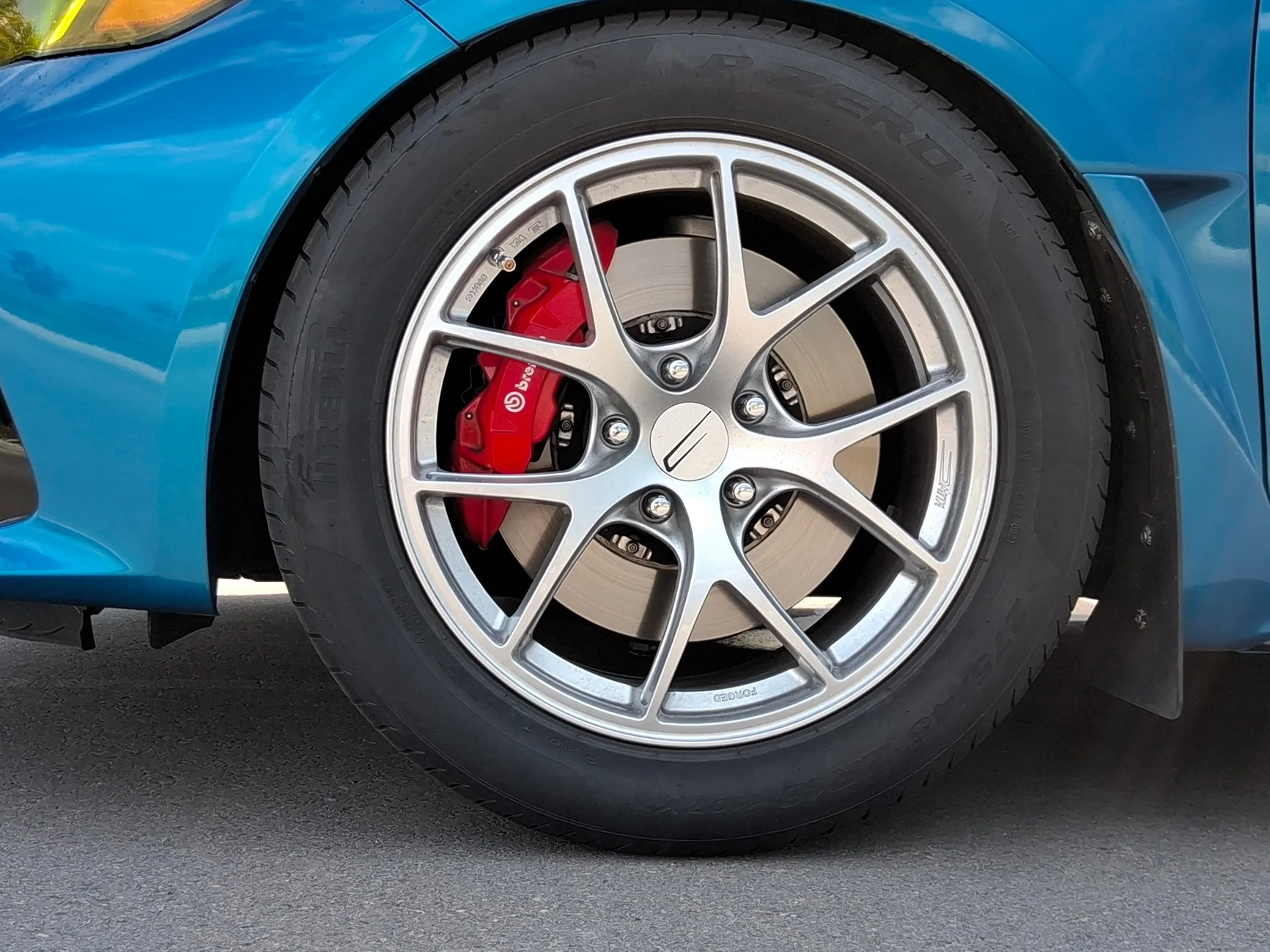

Superhatch has the Enkei TSV in storm gray (18x8.5 +38) with a performance winter tire (Michelin Alpin 5, 235/40).
... or were you asking about mine?
My wheels are the MITA Motorsports FKS in size 18X9.0, ET +45, Center Bore 64.1mm.
The tires are Pirelli P Zero in size 275/45ZR18.
My suspension and camber are OEM stock.
Once again I must state my DISCLAIMER:
I mounted these tires for science... and here I have reached the limit of tire diameter in the FL5 wheel well. I DO NOT recommend a 45 sidewall on the FL5.
The tires WILL RUB.
I am definitely going to be sizing down to a 40 sidewall from here on out.
Cheers.

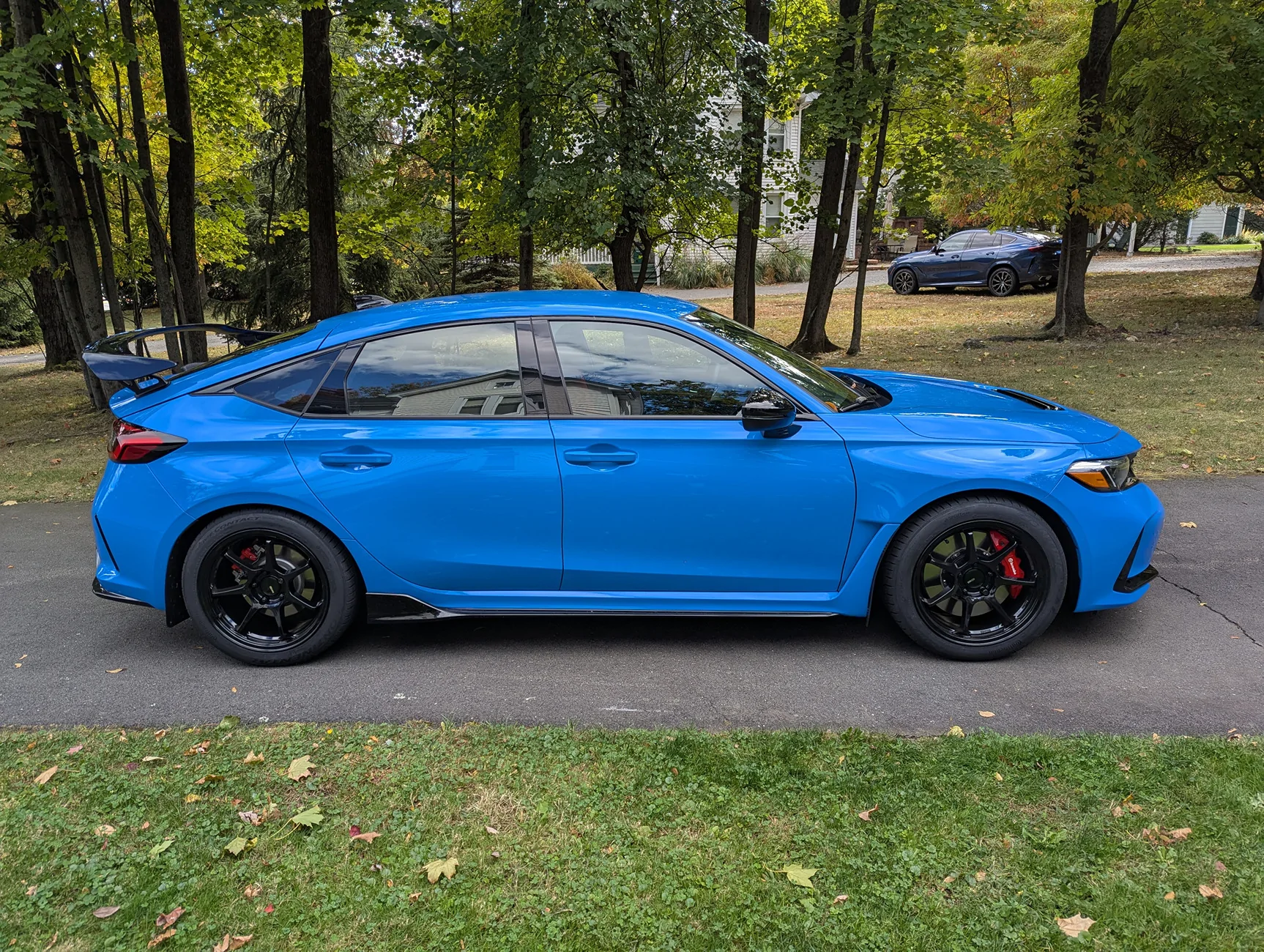

I hated the stock tires. I replaced them with Conti extreme contact 2's 265/35/19 and everything improved for me; YMMV.
I needed a winter set for a area that can get a rare big snowfall but typically we get a few inches and its plowed away pretty quickly. eg; last season my driveway required plowing 3 times.
With these considerations I went Enkei TS-7 18x9.5+45 with DWS06+ 265/40/18. They don't look GREAT but they look fine and they perform. Sure I haven't seen snow and don't expect to for a while but the ride is fantastic and the performance is just fine.
Behold my phat tire phenom LOL
I like my tires like I like my women. Nice and meaty.

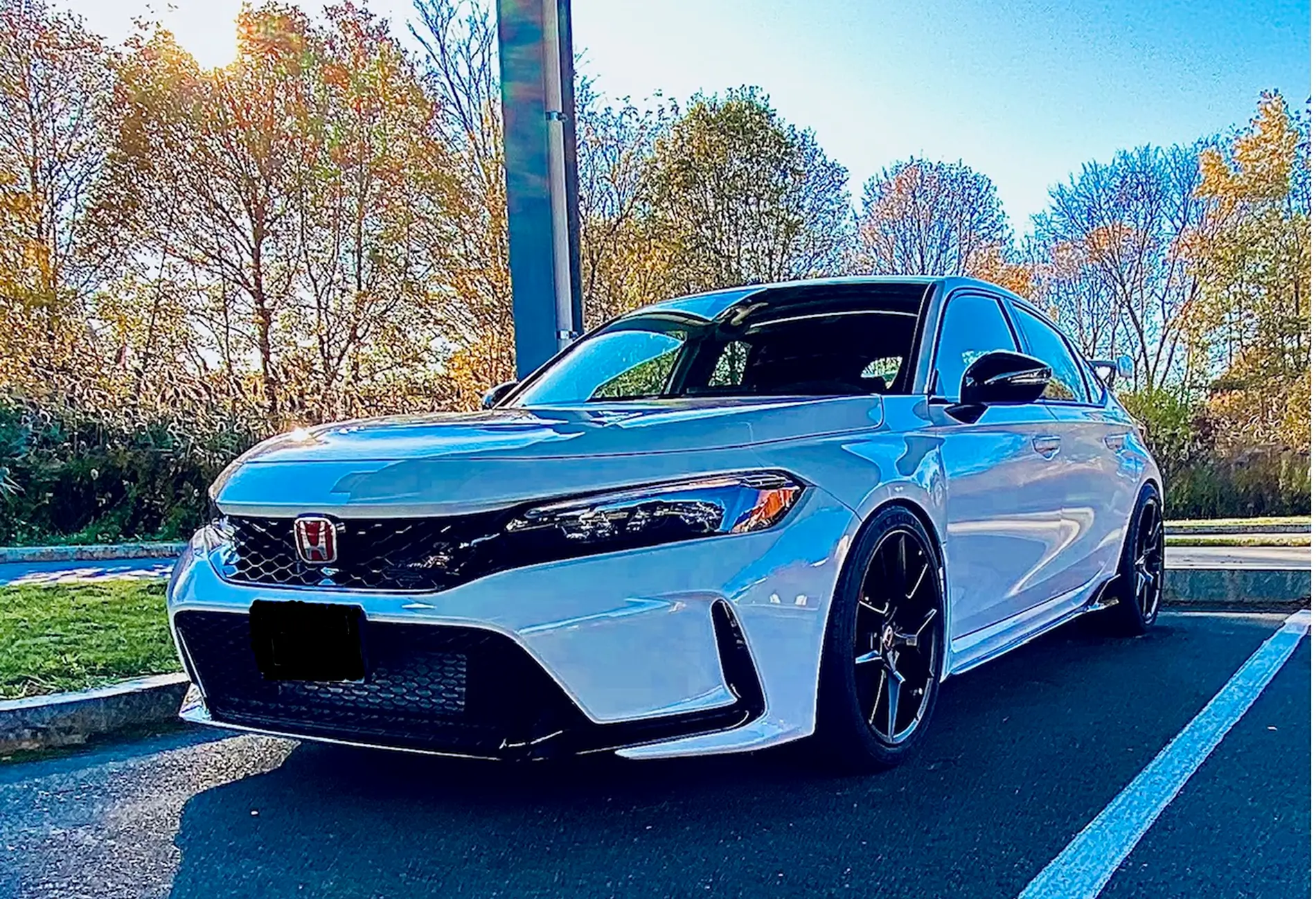

Stockers with a slight H&R drop taller 35 tire and some H&R spacers. Chefs kiss. Less is more.
