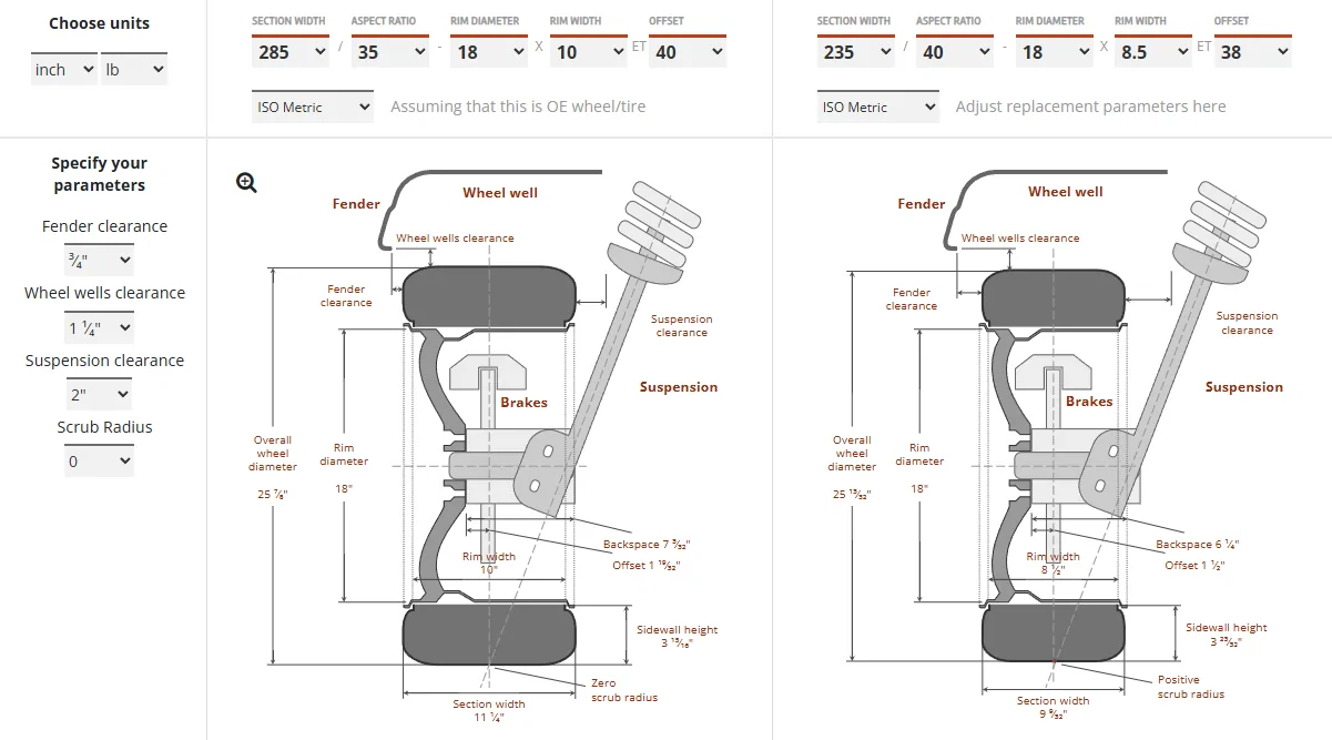

So I think part of what you're missing here is that your 18x8.5 +38's will not have the same appearance as the wider wheels that most folks use (for summer purposes) because the face of the wheel on yours will be sunken in a good deal compared to those wheels.
If you want to get a good idea of what those wheels would look like in a wider spec, you would need to run something close to a 25mm spacer all around.
Even that wouldn't be enough though, because those other options are a taller than OE tire, and you went for something close to OE tire diameter.
Calculator comparison below, with 285/35R18 on 18x10+40 on the left, and your 235/40R18 on 18x8.5+38 on the right.
Note where each setup sits in relation to the fender edge:

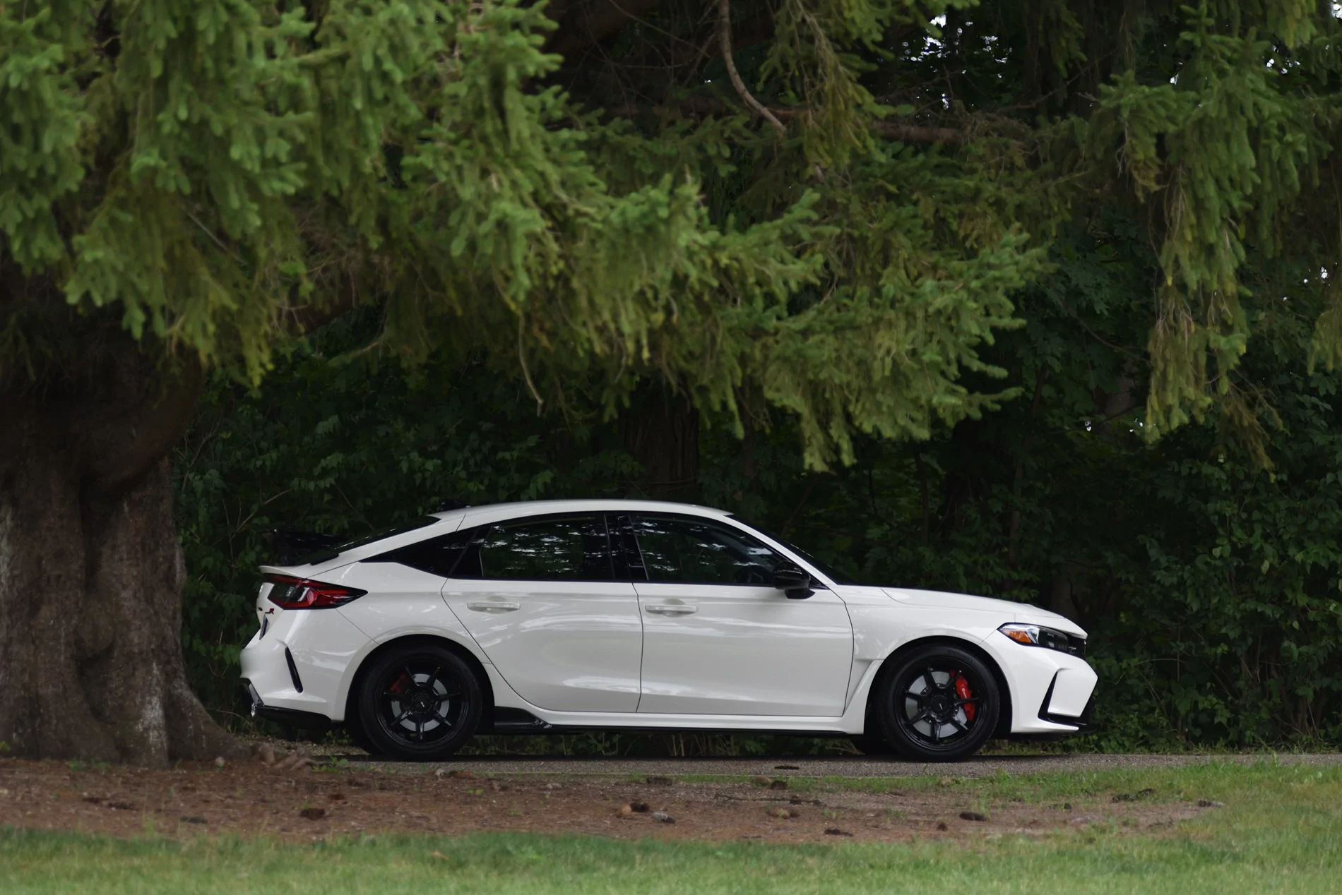

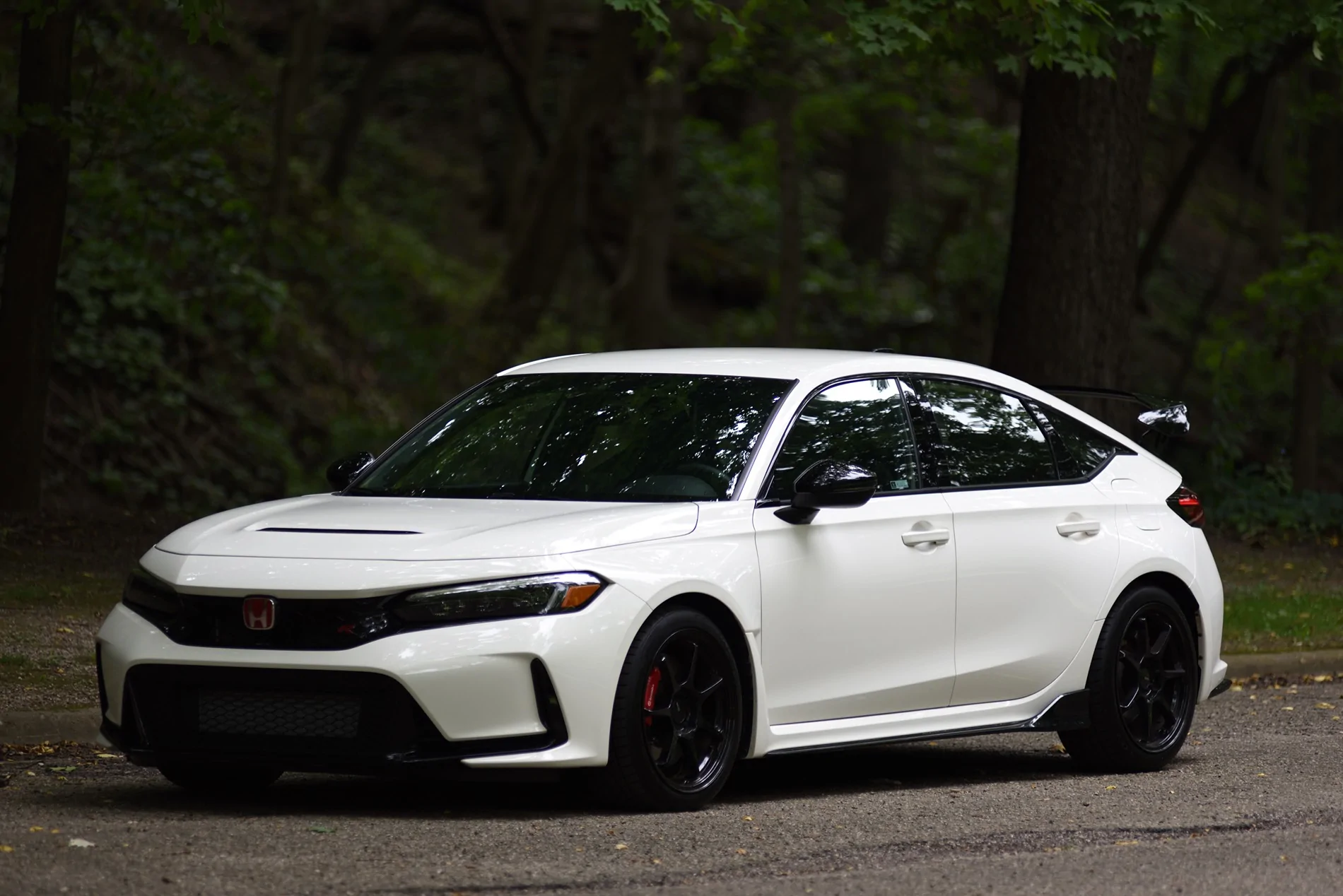

I get that part, I was using a 10mm spacer on the oem wheels to get the look I wanted after lowering and it helps a lot with how the car looks from a tucked/flush perspective. I don't know if that would change my perception of how the diameter of the wheel looks in the wheel well though, that's my main issue.
18's make the car look more 'old school' in a way, and I get people like the smaller wheel look, but I don't think it fits the proportions of the rest of the car.
I assumed that because of all of the god spec talk an 18 would look good but it just doesn't fit imo. Even from my long range shots from a full side view where the offset won't matter too much I think they look too small. I wanted to make the post as a counter to the 'god spec' idea as I think people should see some cars with 18's IRL before buying them as I thought they looked great in pics, and I think mine do too, but in person I'm not a fan.
