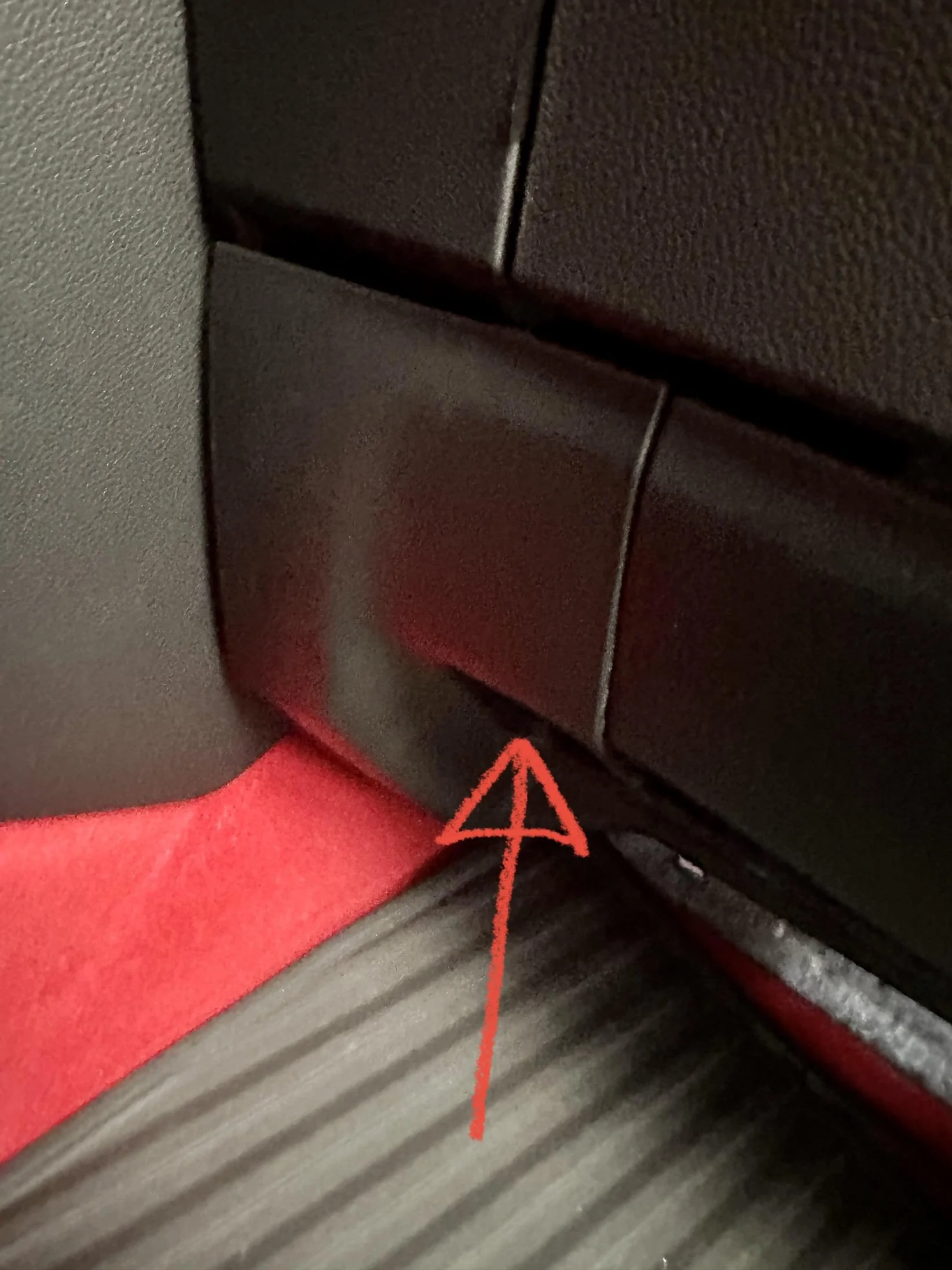

This piece of plastic was causing the rattle and squeaking by the glove box. It’s at the bottom left. I showed my dealer and they put some foam in there and it hasn’t rattled since.
That piece was my problem too There was a warped clip on mine that was buzzing around since it couldn't fully clip in. Glad you got yours settled. You totally had it much worse than mine was lol
