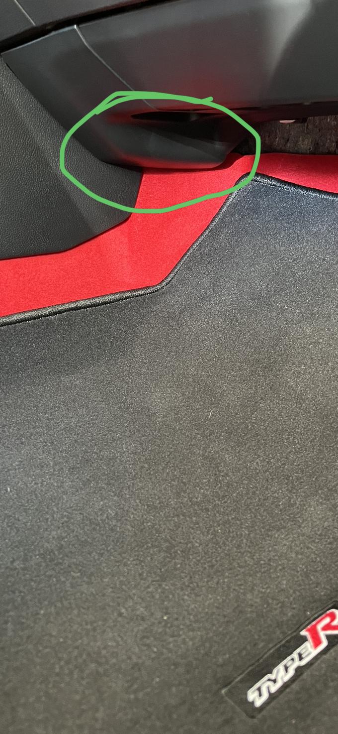

Found the main rattling problem in my passenger’s side. It’s the kick panel by the lower glove box panel. Feeling around behind there, I think there’s a broken clip. Really sucks because I don’t think this is a simple thing to replace. ? Check out my vid.
I was able to stuff a piece of foam behind there which took care of the rattling, so that’s good. I’m going to take it over to the dealer and see what they say.

Alright folks, found the glove box area rattle and fixed it! ? It’s very simple. All you need to do is stuff some ā€œyoga matā€ foam (or similar soft foam) into this area (see pic). I cut a piece that was about 2ā€ x 8ā€ and folded it over on itself a couple of times so it is 4x thick. There’s a hollow cavity in that area I circled and apparently it is rattling vertically against some inner components there.
Here’s the foam I used.
https://www.amazon.com/gp/aw/d/B0B5TMHR26?psc=1&ref=ppx_pop_mob_b_asin_title

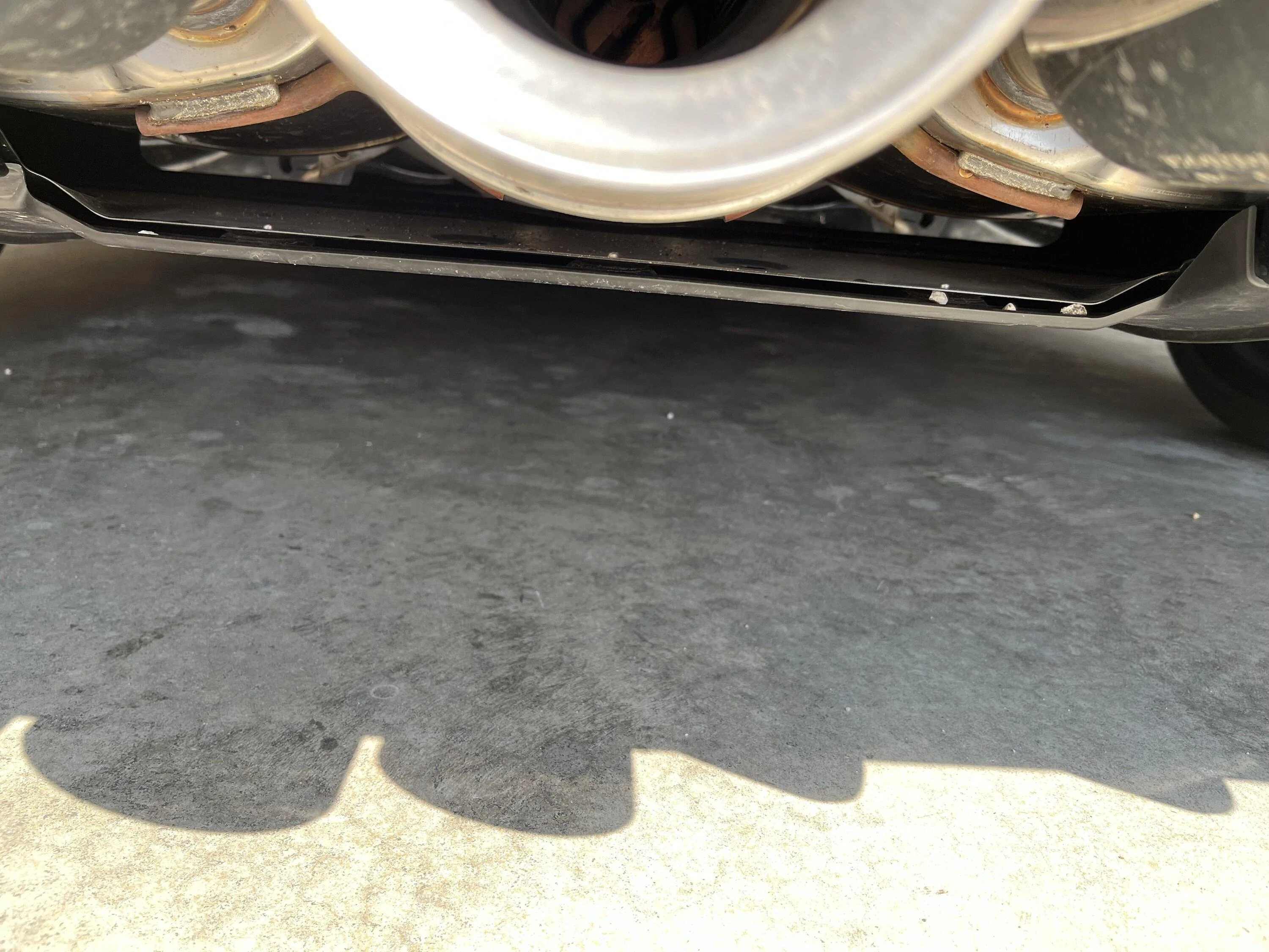

I’m getting a trunk area rattle that sounds almost exactly like a loose license plate. I’ve checked and re-checked my license plate. That’s not the problem. I can’t find anything else obvious to check. It’s a metallic tapping sound (or could be something plastic tapping on metal) and it only does this on really bumpy, cracked, road surfaces. The roads where I live are awful and I can hear the sound even with music playing. Anyone have any ideas on things to check? I’ll just take it to the dealer if necessary, but I like to try and fix minor things myself before resorting to that.

Yeah, I can live with some slight rattles and I do expect that. I lived with an ā€˜09 Si for almost 14 years. But some are MUCH worse than slight. The ā€œlicense plate rattleā€ sound coming from the back of my car is pretty bad. It doesn’t seem to be coming from the hatch door itself. I’d expect it to rattle when I close it. I’ve check the tire fixing kit and all is fine there too.
Doing some investigating I think it may actually be coming from a plastic panel under the car (right next to the shiny black portion of the rear diffuser). It might be bouncing up and down and tapping on something metal under there (possibly a heat shield)? Maybe I’m simply missing a clip or maybe a screw came loose? No one else seems to have this problem on this forum or others, so help on this one is hard to come by.

I think I found the problem. Frikkin’ rocks are rattling in my diffuser between the plastic part and the metal (heat shield). There’s drain holes in the diffuser for water to pass thru. Those holes are also apparently perfect for collecting small rocks and then they get stuck in there (between the plastic and metal) and rattle like crazy when I hit bumps in the road! Ugh. Think I can probably wash them out of there with high pressure water at the car wash. Short of that, I may have to take the diffuser apart. I can’t dig them out of there with my fingers. The space is too tight, and there’s certainly more sandwiched back in there that can’t be seen.
