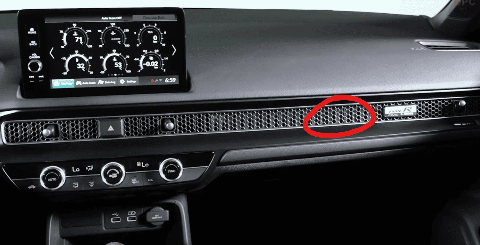

My passenger dash rattling is still present, even after both me and the dealer felt taping a bunch of things. I'm basically just trial and error felt taping areas where two pieces of plastic are touching/near touching. It does feel like part of my AC grille assembly isn't snuggly connected to the surrounding plastic just left of my Type R badge and I wonder if that's doing it. Basically the grille feels very solid everywhere except the area circled in red here. That spot has a lot of give if I push on it and you can tell the grille and surrounding gunmetal plastic frame aren't attached firmly.

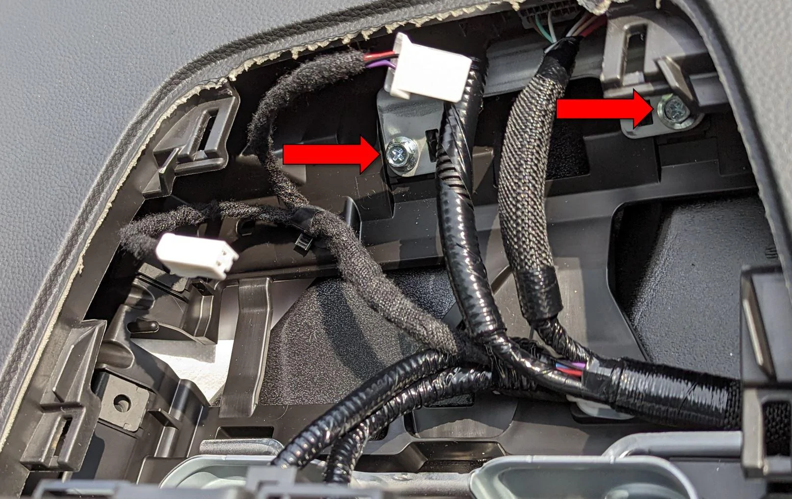

Ever since my FL5 rolled off the lot, I've had a consistent buzz coming from the dash. The noise consistently started at a higher RPM. I referenced this youtube video: https://youtu.be/3ae8UQK3AWE and tightened the screw mentioned in the video. Didn't do much.
However, I tried another approach and did the following:
1) Tap the dashboard by the infotainment screen and listen for a metal/buzzing sound. If it's present, continue to step 2.
2) Remove the trim cover behind the infotainment screen.
3) Unplug the harnesses attached to the trim cover.
4) Loosen the 2 screws labeled below by 3-4 turns.
11th Gen Honda Civic Interior noises - rattles, creaks, squeaks! fl5dash
4) Tighten the screws using a socket wrench (no Phillips) 1 half turn at a time. Turn one screw and alternate to the other. After tightening each screw, tap the dashboard and listen for the sound.
5) Repeat step 4 until the sound disappears.
If these instructions have been posted here before, apologies for repeating.
This worked to remove the buzzing noise. I drove the car on various speeds and surfaces for about 200 miles afterwards and it's been quiet since. Noise is completely gone. Curious if it'll work for everybody else on this forum.
