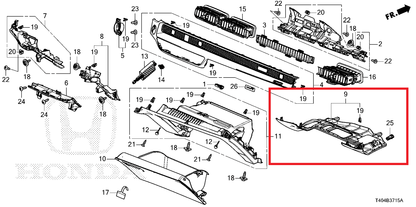

I've been following this thread for awhile now to help troubleshoot rattles in my own car, and I've discovered the rattling from my dash has been coming from the piece in the red box, its right below the glove box. I filled a lot of the gaps on the back with pieces of Dynamat and put cloth tape where the mounting tabs are. Ive also put a large piece of Dynamat on the bottom of the glove box itself. No more rattles from those pieces. I've discovered that I'm getting the rattle from the passenger seat belt, just waiting to get the replacement clip before taking that trim apart.
