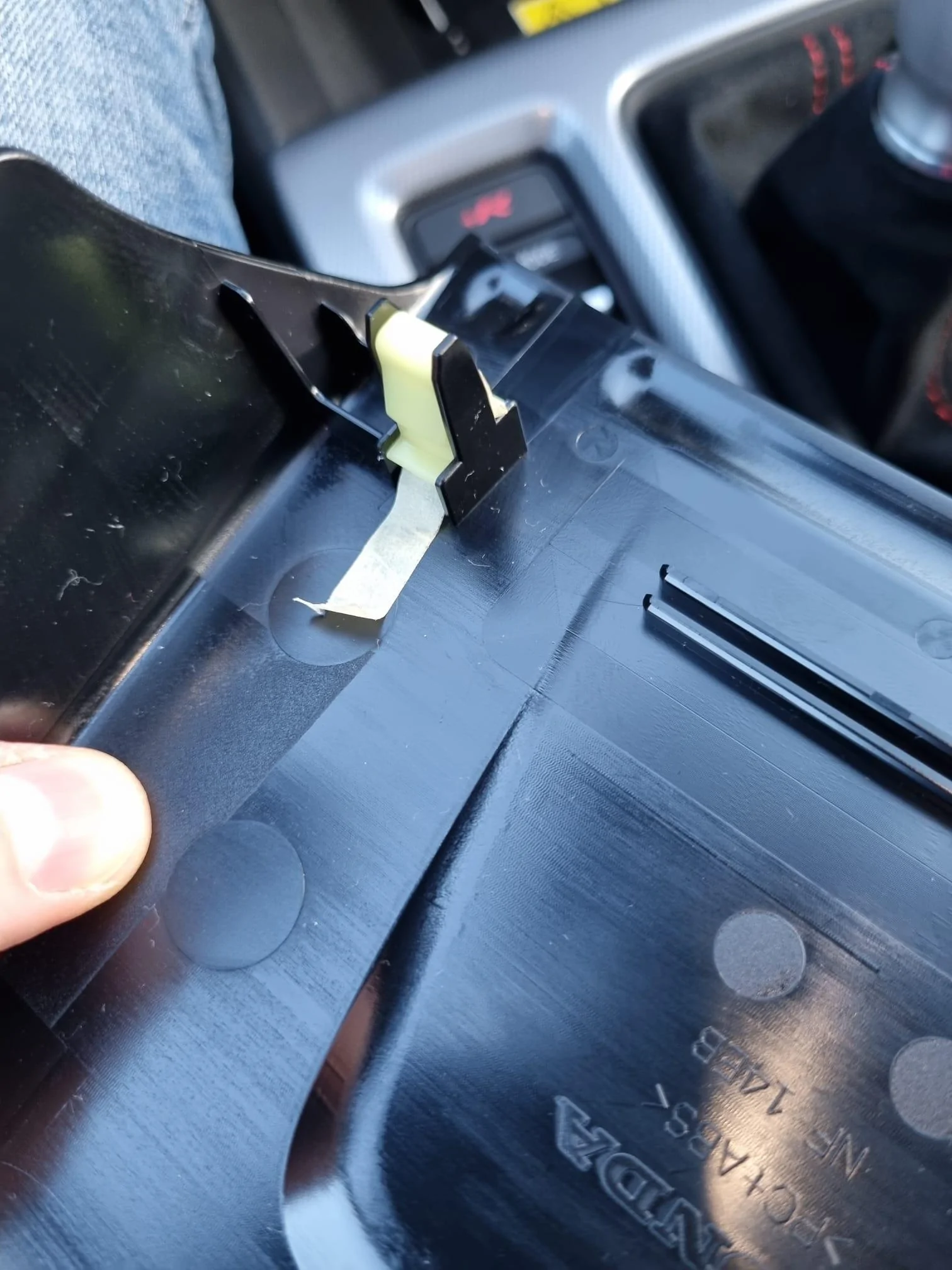

I noticed that the clips holding it where kinda loose on their own so I took them off and put some tape underneath, which fixed them in place.
11th Gen Honda Civic Interior noises - rattles, creaks, squeaks! clips

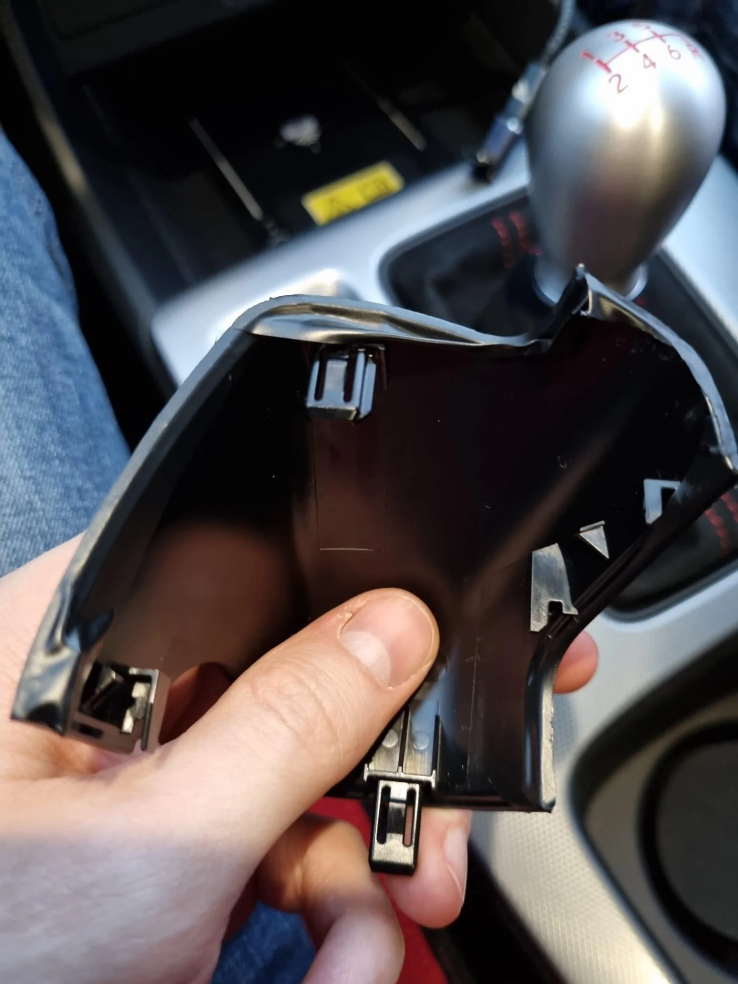

Then I applied some black tape all around the edges of the plastic housing behind the mirror. I cut it so it's not visible when put together. This seems to have stopped the rattling coming from there.
11th Gen Honda Civic Interior noises - rattles, creaks, squeaks! rvm_housing

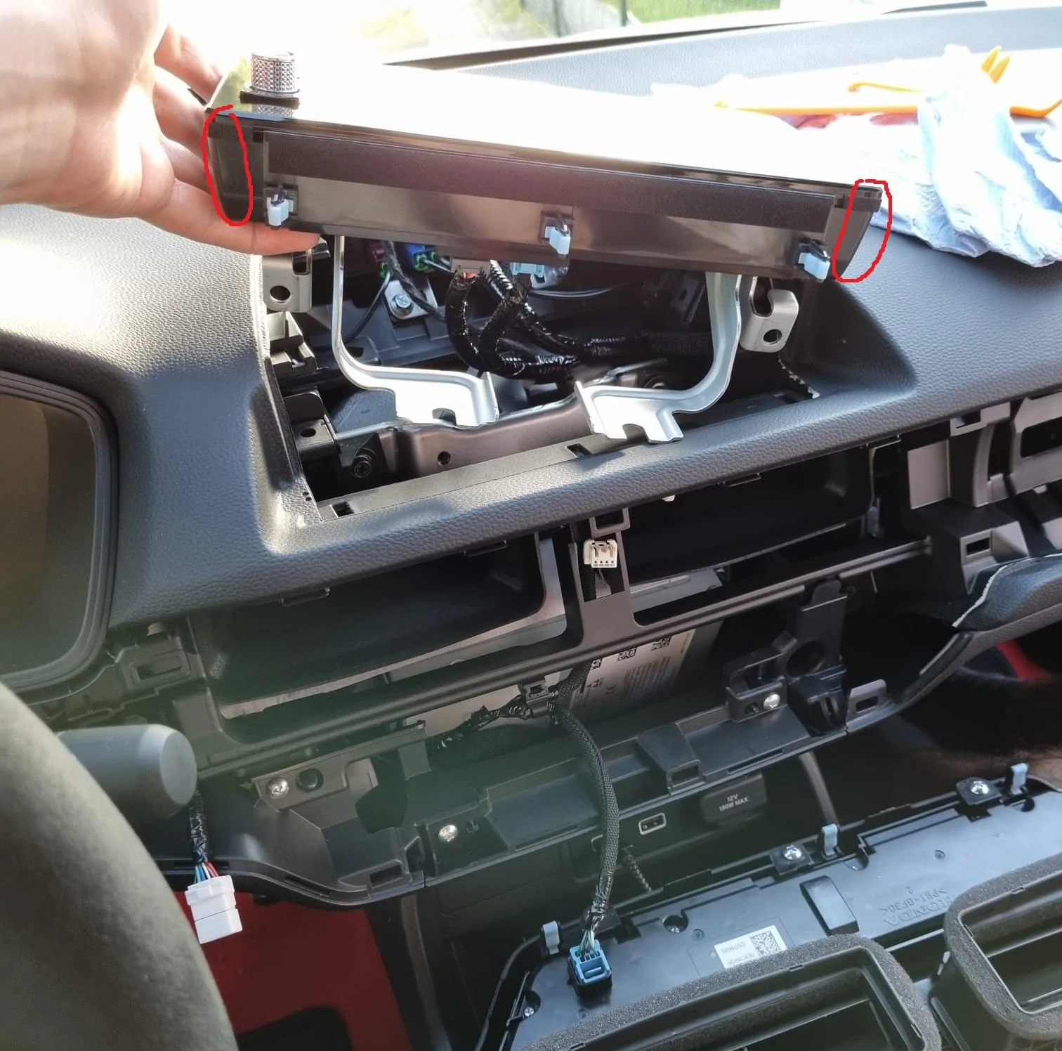

Essentially, you need to remove the display and place some felt tape underneath it. To do this, I removed the dashboard center trim to reveal screws holding the display. I watched the start of this to see how the center trim is removed:
Be careful here. I put a small dent in the foam around the trim while doing this. In retrospect, it might have been possible to get to the two bottom screws with a wrench from the top (when you remove the plastic cover behind the screen) without removing the whole center trim. You don't need to unscrew them completely since the screen can slide off once you loosen them. I did it the way it was described in the PDF though. There are two more screws you have to unscrew from the top behind the screen though. After that, the screen is only clipped at the bottom.
You can disconnect the hazard lights switch as well as the start button if you need more space, but do not disconnect the climate controls. I figured if I don't disconnect it, I won't need to do step 6. in the PDF "Do the climate control unit Self-Diagnostic Function with the HDS" (and to be honest, I'm not exactly sure how to even do that). The AC has been working fine once I put everything back, so I guess it worked.

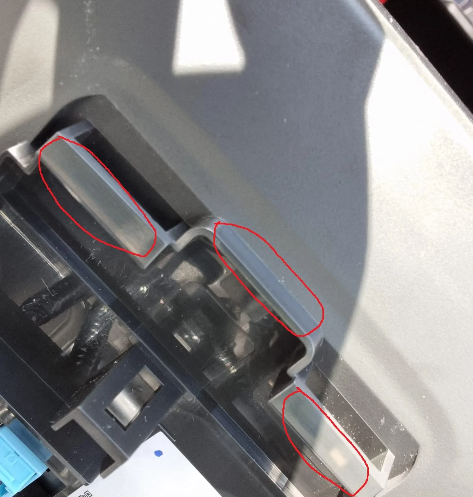

The red circles is where you need to apply the felt tape (not yet done in the picture). There is already some on it but apparently not enough. Make sure it's not visible after you put the screen back. The PDF shows exacly how much and where to apply it.

Once I added the felt tape and put everything back together, I also decided to put some felt tape on the back of the display where it connects to the plastic cover. I used the front camera of my phone to look behind the screen since it's hard to see back there:
11th Gen Honda Civic Interior noises - rattles, creaks, squeaks! back_of_screen
Not really sure if this was necessary, but it made me feel better. So far, no more rattles coming from the screen.
