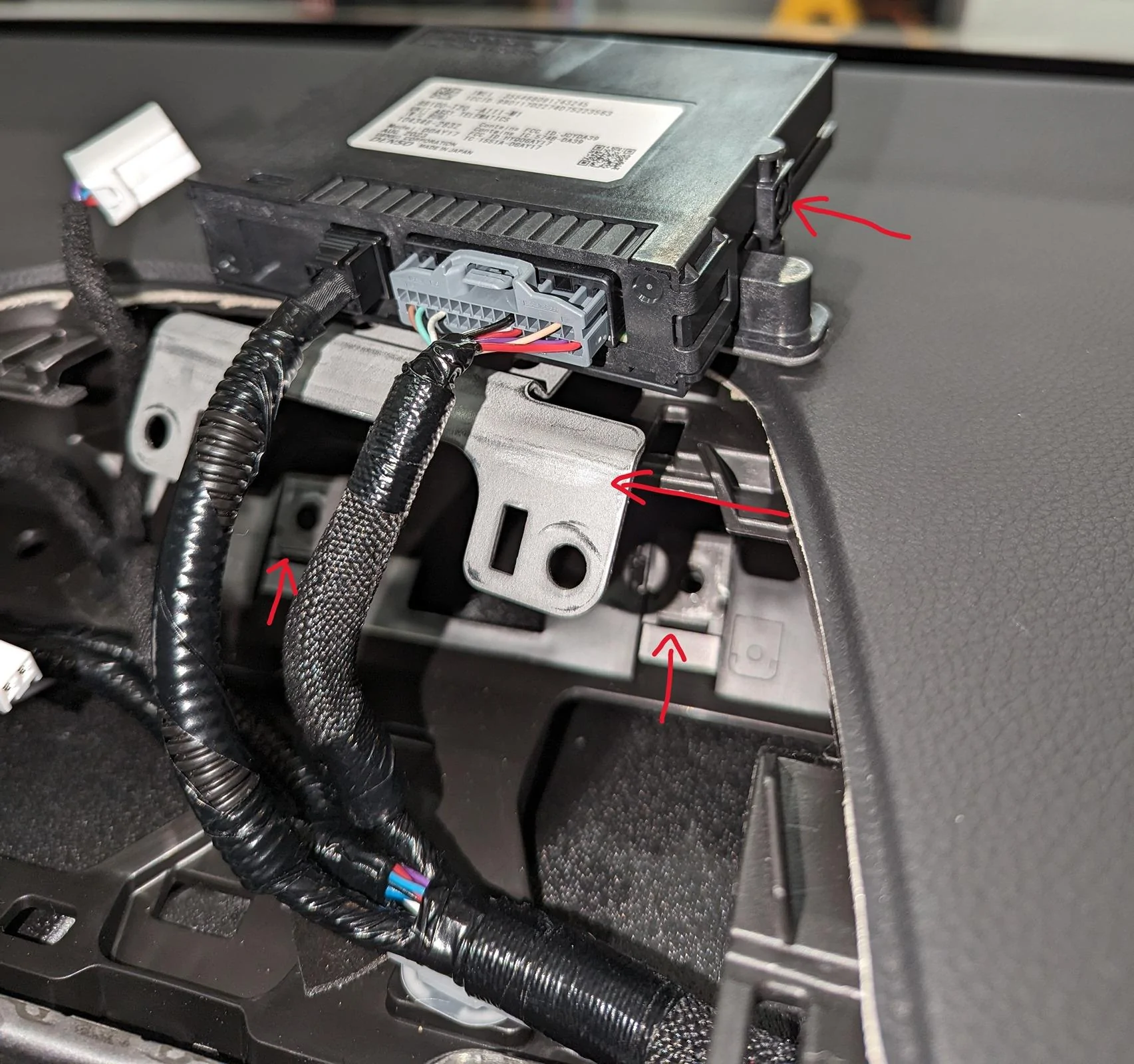

So I’ve got the buzz/rattle behind the infotainment screen. Only happens when it’s cold and the dealership say it’s the air intake that’s the cause. Doesn’t make any sense to me how the intake would affect this. Anyone else had this issue?
Can you replicate the buzz/rattle by tapping on the top dash next to the center speaker area?
I also had the rattle behind the infotainment screen that was driving me crazy. Took me a while but I finally found out the culprit which was the TCU unit. I took out the whole unit including the metal mounting bracket, the two metal screw fastener clips that secured the mounting bracket, as well as the other two metal screw fastener clips on the left side that were not being used for anything. Then, I put some foam tape around the two connectors, put everything back together, went out for a test drive and confirmed the noise was gone. Drove on some rough road and revved above 4k and no more buzz/rattle.
Now I can finally move onto the A pillar rattles...
Thanks so much. Sounds like the same issue I’m having. I’m going to give this a try. Hopefully I don’t damage the dash getting the panel off. Looks like it will come off relatively easy though.
